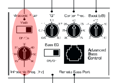

The subs should hold on the 1000/1 I think you just were bass boosting everywhere you could, you should engage the infrasonic filter and set it at 30Hz that would help the subs.

possibly dont need "q" and "c" set then? just the filter itself. never touched gains on head unit..may consider new subs more suited for a sealed enclosure. thanks

Take a look at the pic, set the switch and the knob marked in red just as shown.
