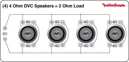

I have 4 15s 4ohm dvc wired down to 2ohms on a monoblock amp. The problem is the 1st sub work, 2nd sub dont work, 3rd sub works, 4th sub dont work. Ive hooked up each sub by itself and they all work. Can someone please help me out. Thanks

Well, you say you wired your subs coils in parallel down to 2 ohm each. before anything just check that the polarity of the coils is respected + to +, - to -.
Also you don't say how are they connected to the amp or amps and also may be nice to know which amp or amps are you using and which subs..

maybe u have them wired wrong
it shud be like this : ...
