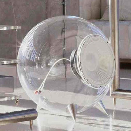

Weird can be achieved to some extent with any of them take a look at this sealed:
There are Math formulas for all of them but usually software is used. With the best software I have I can only calculate sealed ported, and few bandpass.

@joe, that is awesome. i think i am going to buckle that thing into my passenger seat!

If you put it on the back it may actually kill you..lol.
But in all seriousness sealed has the greatest SQ, that thing may actually sound good.

Sealed won't have good SQ if it drops off around 60 Hz. Then it's not even a matter of SQ, it'd be a matter of not enough out put for even SQ.
That clear sealed coicle is frickin' sweet. No crazy resonances within a sphere.
