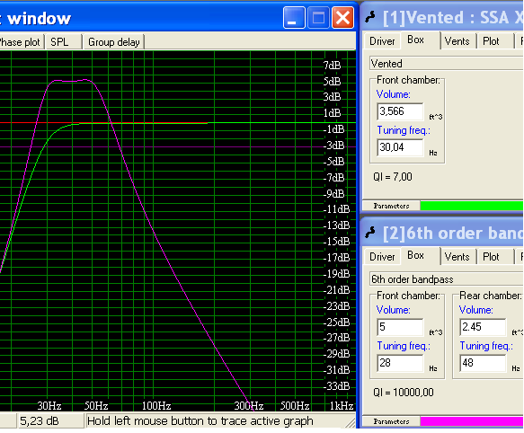

Silver Member Username: Joe1234Post Number: 679 Registered: May-09 | Well WinISD app apparently didn't like those params, nor does offer optimization for 6th order, I came up with some guessed params and what's striking is the +5dB over the ported! You would need to rescue with midbass drivers early (like 50-55Hz). Those boxes are hard to build and incredibly big though, I think I read that there are tunable airports to do some manual alignment. also some analysis instruments would be needed. Yeah it can be done of course but it's a pro job. Also you get horribly high (off the chart) group delay which makes bass sound slow and poorly defined, so not for SQ either. |
