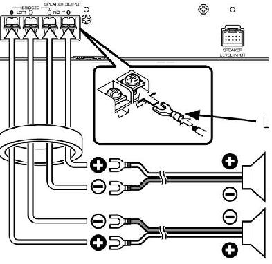

Silver Member Username: Joe1234Post Number: 407 Registered: May-09 | Kmurda, are you saying that you have the input gain of your amp set to 1/4 ??? Also using a dual 4 ohm coils subwoofer on a four ohm stable amplifier (bridged) is a wrong choice, happily there is a workaround below. You have your whole system misconfigured. To setup your system correctly PLEASE READ CAREFULLY: A) configure the connections between the amp and the sub for maximum power: 1) flip the stereo/mono switch on the amp to MONO, 2) wire the left channel of the amp to one coil watching the correct polarity of the connections to the amp positive on the amp to positive on the coil, negative on the amp to negative on the coil, . 3) wire the right channel of the amp to OTHER coil also watching correct polarity of the connections to the amp like in 2. The coils must NOT be connected in any way to EACH OTHER. That would put 340W RMS into the subwoofer in a very safe manner. B) Setting up the gain on your system: 1) turn down the "input sensitivity knob" almost at minimum. 2) turn up the volume in the head unit to the max level that it gives a clean sound (the bass tone control should be "0"). 3) turn up the "input sensitivity knob" on the amp as far as you don't hear distortion. C) Setting up the other knobs: If you have LPF filter enabled on the amp (Fiiter switch to LPF) the "LPF Frequency" knob should be set below the 70Hz marking between 50 or 60Hz. Also if you want to do upgrades to your equipment state a budget. |

New member Username: KmurdaPost Number: 5 Registered: Sep-11 | @ Joe Durkham So If I am understanding you correctly I wont be using the bridged feature on my amp? Instead I will be using all four (+,-)(+,-) outputs on the amp?? Im a little confused (sorry) Im not understanding what you mean by the left and right channels? |
Silver Member Username: Joe1234Post Number: 430 Registered: May-09 | Correct don't wire for bridged mode you wont be using bridged but the stereo/mono switch must be set to mono. Very important. This is a screenshot of your manual just imagine that each speaker that is shown is a coil on your subwoofer. polarity is very important so wire just as shown. On the sub red is for positive black is for negative. If you do not understand the slightest thing ask before making any connections. If you want post a pic so that I can see if its right. |
New member Username: KmurdaPost Number: 8 Registered: Sep-11 | okay I understand! one more question.. how do i run both pair of the positive and negitive wires through my box to hook up to the sub if the box only has 1 positive and negtive port |
Silver Member Username: Joe1234Post Number: 432 Registered: May-09 | Kory, yes that's obviously a problem, for now unscrew the terminal block and run in cables straight from the amp, stuff something on the hole to prevent airflow through it f you decided to keep the sub then a second terminal block should be put. Or just quit right now and get either a four ohm sub single coil or an amp stable at 2 ohm bridged. Or a monoblock amp also stable at 2 ohm. |
