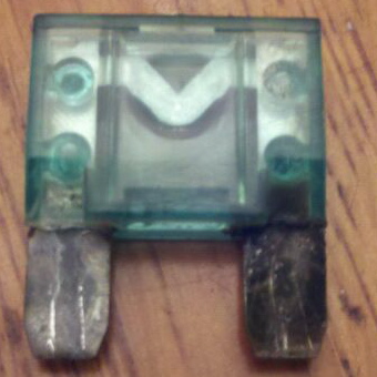

Silver Member Username: Vc23EastCoast, Michigan Dos Fi BLs Post Number: 361 Registered: Mar-06 | Yep dont worry, Hooked his amp up to my wiring and it works flawless. Looked at all the fuses again, and at first glance, the inline fuse wasnt blown, but I pulled it out, and look at that. ![]() |
Silver Member Username: Vc23EastCoast, Michigan Dos Fi BLs Post Number: 362 Registered: Mar-06 | Not big enough wire be the cause of that? and its burning up? or just clipping the sh1t out of it? |
Silver Member Username: Joe1234Post Number: 437 Registered: May-09 | Ok well so the wiring DID have a PrObLeM ... thanks for coming clean on that not everyone does. In fact the fuse did not burn but the blade fuseholder had poor contact with the fuse. That fuseholder is done and so are those power cables, to play safe place new wires tightly connected. Worse than that I don't think that the fuse is even rated for the 60 amps it needs to be. Wiring is inexpensive and easy to find, this contains all you need inline fuse etc: http://www.walmart.com/ip/AMPAC-AK4000-4-AWG-Amp-Install-Kit-with-Do-It-Yourself -Amplifier-Installation-Guide/16814161 Pick nothing less than 8AWG but going 4AWG is better also sand the chassis to ground connection. I am really glad you nailed it. Let me know if I can help further. |
Silver Member Username: Vc23EastCoast, Michigan Dos Fi BLs Post Number: 363 Registered: Mar-06 | Yeah for sure, It was just irritating. But no, I install everything myself, and never had any issue with my stuff, but this was a friends car. And he had someone else set his up. But I'm just glad we got it figured out. And yeah that was a 70 amp fuse, and he's rockin 8 gauge wire, I told him to at least upgrade to 4 gauge, so hes puttin in an order tomorrow at knukonceptz. : ) Thanks for everything guys! |
