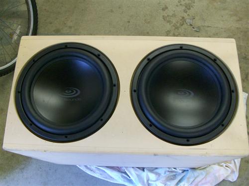

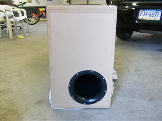

Gold Member Username: JbpittPittsburgh, Pa. Usa Post Number: 1283 Registered: Jul-09 | My 12'' epics... Had Bassman build me the box. 4cuft tuned to 32hz. These subs supprised me in every way. Sound amazing,get nasty low,and are fairly loud too. |
