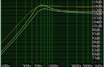

Silver Member Username: Joe1234Post Number: 350 Registered: May-09 | The subs in my previous post wont do well at 1 cuft. SPL curves, sealed box, 1 ft3, 1 meter Light blue MBQuart FWA304D (300WRMS) Yellow Pyle 1290BL (500WRMS) Orange Audiobahn AW1051T (300WRMS) As it can be seen 12"s get a lump on 1 cuft. |
Silver Member Username: Lord_huggingtonOntario Canada Post Number: 437 Registered: Oct-10 | Those didnt model so well at Q 1.2 FC 60 Hz, that's like -24dB @ 40 Hz, which wouldn't be a good response for my street bass. I like the Dayton though. |

Silver Member Username: Joe1234Post Number: 351 Registered: May-09 | Ok Lord_huggington but the plot you see is not for the daytons but these: 1) MBQuart FWA304D 2) Pyle 1290BL 3) Audiobahn AW1051T How do you like the orange curve? its getting F3 at about 40Hz enough? Anyways my point there is that for those cheap subs I modeled (including the MB Quart you suggested) the 12"s do bad in 1 cuft boxes, getting that boomy lump. |

Silver Member Username: Joe1234Post Number: 361 Registered: May-09 | This one will behave nicely on a 1 cuft sealed box with F3 = 43Hz and is below $100. Boston-Acoustics-G112-4: http://www.sonicelectronix.com/item_10214_Boston-Acoustics-G112-4.html It might even get you SQ. |
Silver Member Username: Joe1234Post Number: 362 Registered: May-09 | Getting better at this: Autotek M12D4 F3 = 35Hz sealed 1 cuft $45.99 http://www.amazon.com/gp/product/B005HF6ERG Wild guess: sensitivity is specified with coils in series. So +6db in parallel. |

Silver Member Username: Joe1234Post Number: 406 Registered: May-09 | Qts = 0.73, Vas = 98.2L, Fs = 23.72 The one in audiosavings.com is the SM12D4 and its a totally different thing, this guy is selling in pairs and has only 8, $42.50 each: http://www.ebay.com/itm/PAIR-AUTOTEK-M12D4-12-2000W-Car-Audio-Subwoofers-Subs-/3 90279735392 I modeled a few of those Autoteks but failed to find a cheaper performing alternative to the "Mean Machine"..lol. |
Silver Member Username: Lord_huggingtonOntario Canada Post Number: 447 Registered: Oct-10 | 1 cubic foot QTC a staggering 1.5451, may be boomy FC 50.21 Hz F3 34.93 Hz - sweet Per 15.28 Hz, it only drops off 3 dB, which should make it as good as -6 dB @ 27.29 Hz, and -12 dB @ 23.47 Hz. How I got those numbers - 15.28 divided by 2 twice, minusing from the F3. Dunno if that's the "linear" way. It would make a badarse IB sub. 9999 cubic feet QTC .7301 FC 23.72 Hz F3 23 Hz 100 cubic feet QTC .7426 FC 24.13 Hz F3 23.03 Hz |
Silver Member Username: Joe1234Post Number: 409 Registered: May-09 | Yes, boomy, most 12"s behave like that to some extent on 1 cube sealed, pretty close on the estimates, anyhow if you factor in cabin gain it gets better than that. |

Silver Member Username: Joe1234Post Number: 917 Registered: May-09 | Ramon model the Autotek M12D4 on 1.2 cuft sealed and add damping to the box. This sub is for sealed usage. It behaves perfectly with an F3 = 35 Hz or less it goes for around $40. |
