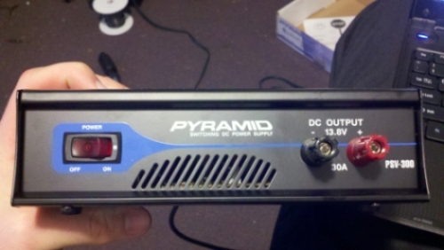

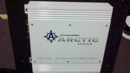

These are pics of the power supply and the ampUpload
