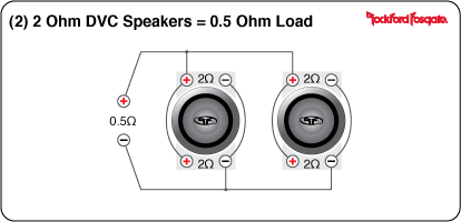

Why not just follow the diagram I posted? Im not really sure how you have it wired now.

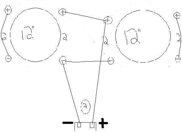

Oh you must have it like this

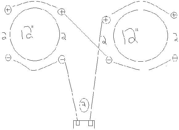

The way they are wired is this: hope you can see but I drew a little doddleUpload

What the hell did you do? Im very confused by that. Im not sure what you tried to do there but that doesnt seem like it would work at all. Just follow the simple diagram I posted for a 2ohm final load. It doesnt get much easier than having a picture to follow lol.

Here via your own drawing edited........
I figured if I used your own drawing you would understand better. ^That is how they should be.
