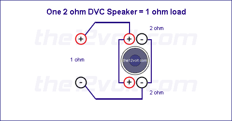

Just wire the coils in parallel for a 1-ohm load.
Like this:

Just remember that wiring in parallel will drop the resistance and wiring in series will increase it.
2ohm+2ohm in parallel=1 ohm
2ohm+2ohm in series=4ohm

just make sure the wires plugging into amp are from two separate voice coils, after connecting each voicecoil with its appropriate wire. for some reason when i fix a buddies system they thought they wired in parrallel have it half right only they take a positive and negative from the same voice coil to the amp, so only one coil is on technically, hope this helps
