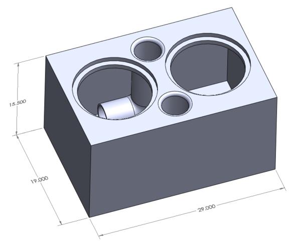

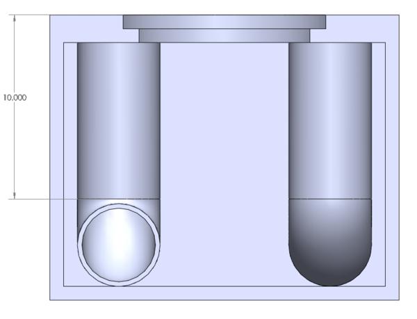

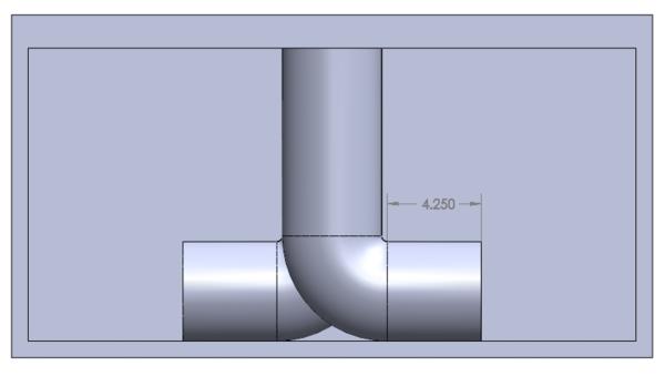

Silver Member Username: AlonzoubPost Number: 125 Registered: Apr-10 | Alright, heres what I came up with... Its nearly exactly 3.2 cu.ft internal, and those are 4" Inner-Diameter ports. Tuning is about 32 Hz. EDIT: Oh yeah, and its double-baffled, for a flush-mount. Forgot to add the dimension in the screenies. ![]() |

Bronze Member Username: Dloco486Post Number: 59 Registered: Apr-11 | that looks good !!! now for the ports do they sell ports shaped like that or do u have to piece them 2gether like plumbing. where can i buy the ports? and how thick wood do i use? is it 3/4 mdf? and is it the same thickness for the baffle? once again that looks great! i really apreciate it. |

Silver Member Username: AlonzoubPost Number: 133 Registered: Apr-10 | Yea its all using 3/4" mdf, the top is double baffle so its 2 sheets of 3/4" mdf glued together to make 1 1/2". I had this in mind when I designed that enclosure: http://www.parts-express.com/pe/showdetl.cfm?PartNumber=268-330 but now that I actually went to parts express and looked at the item I realized how large the flare actually is, their actually isn't enough room on the top of the box for two of these. What you could do is just use PVC pipe without a flare and piece it together like plumbing like you said. Or you could modify the box a bit, I don't feel like doing the math right now but if you extended the depth of the box from 19" to 24" you could fit those flares on it, but you would be adding .84 cu.ft to the box, so you would want to make the box shorter to accommodate. Depending on if I have time tomorrow I may just re-do it. If I dont have time though, im sure you can figure it out or just go with normal unflarred pvc. |

Silver Member Username: AlonzoubPost Number: 139 Registered: Apr-10 | If you just added 4" to the box depth and did not modify the height of the box or the length of the port, you would have a total box volume of about 4 cu.ft. and it would be tuned to 28.5 Hz and is an option. If you wanted to keep it at 3.2 cu.ft. tuned to 32 Hz you would need to shorten it by 3" so it would be 12.5" tall. Which actually would but the end of the port uncomfortably close to the wall. Another option would be still be to widen the box by 4" but only drop the box height by 1.5" which would give you 3.6 cu.ft. And keep the total length of the port at 18" to give you a final tuning of 30Hz. |
