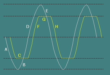

Silver Member Username: AlonzoubPost Number: 112 Registered: Apr-10 | You want clean DC voltage at the power supply of the amplifier. That is as fas as DC signal goes in car audio. Sound is completely AC voltage, hence the "waves" created by the speaker. The alternating voltage is what causes speaker movement and a clean AC signal will not have any "flat" areas. These "flat" areas are also known as clipping, and cause your signal to become dirty. From http://www.bcae1.com/ : ![]() The white line is a clean sinusoidal wave, the yellow line is a clipped wave which causes distortion and poor voice coil cooling. The short periods of flat voltage can be "considered" DC signal. |
