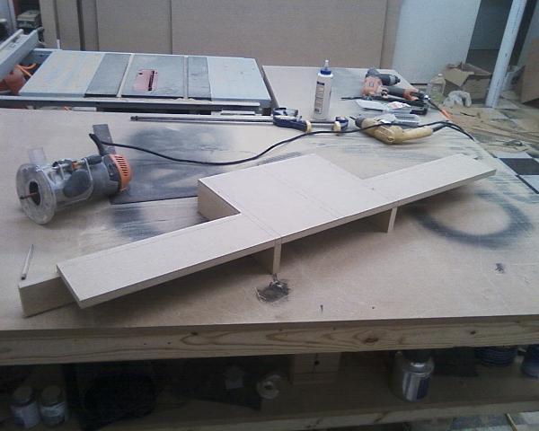

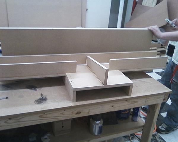

Base of the box w/ 3" risers to clear the trans-hump. 2 extra boards temporarily mounted to allow for that area of the panel to be flush-trimmed off.

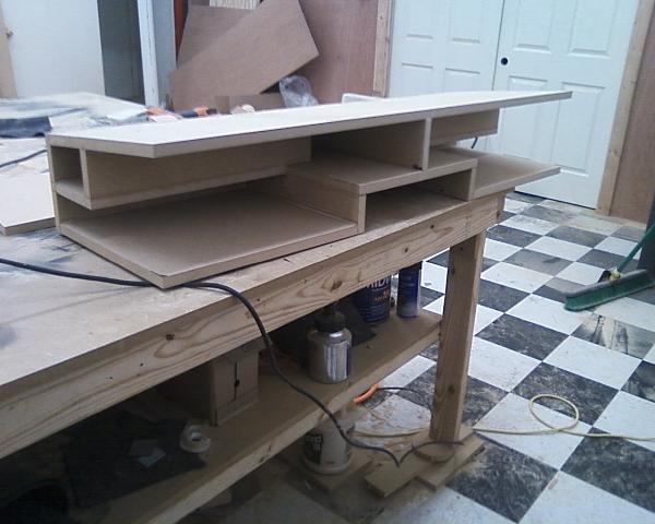

Port walls in.
Center divider and back wall on.

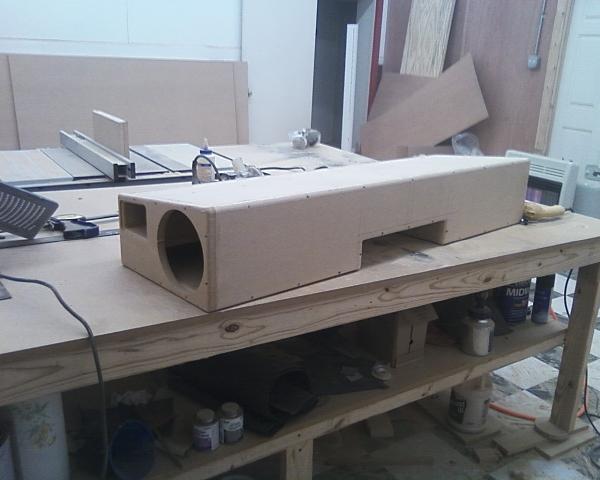

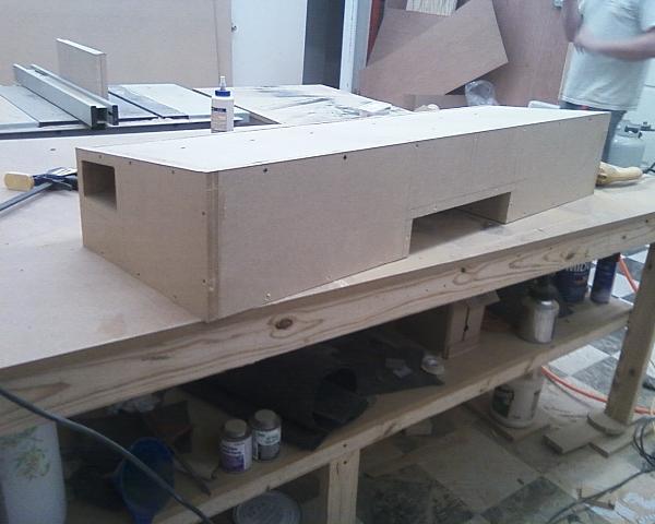

Front and side walls on. Ports trimmed out w/ router flush trim bit.
Trans-hump notch trimmed away w/ router.
Sub holes cut, box and port rounded over

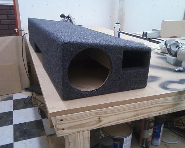

Ports painted.
View inside from the sub cutout.
Box carpeted.
Another view of completed box.
No carpet seams on this one. Its glued and stretched, then stapled underneath.
The subs are mounted on the side to help w/ loading and to keep people from kicking them in. They will be ~4" from the doors of the truck. Our DD shipment will be in tomorrow. Just gotta run some 12ga wire in to the box and mount up the subs.
