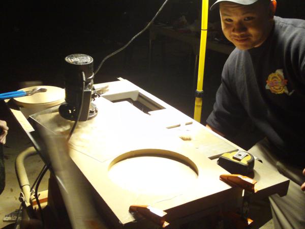

Using my makeshift circle cutting jig to route the circles out... and my buddy posing. I used a piece of acrylic to mount the jig onto and just spun it around a nail. You can see it didn't work perfectly (the small lumps in the circle) because the mounting bolts we used to mount the router to the acrylic didn't sit flush inside the acrylic.

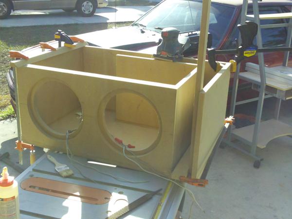

Did some sanding of small uneven spots and glued the 45 in the port. Was going to 45 the back left but the bolts I used as speaker terminals were in the way, so I just said screw it.

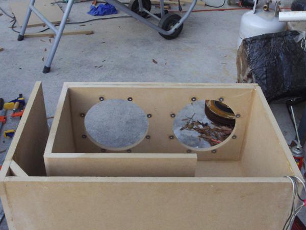

Put the Hurricane/T-nuts into the box. Someone is going to have to explain to me the correct way to put these in because I ended up not using them. I used these: http://www.parts-express.com/pe/showdetl.cfm?Partnumber=081-1082 When I put them in I pre-drilled the holes, then I put a small amount of glue on the T-nut and pulled the T-nut into the hole by screwing the bolt into it slowly. They all pulled in nicely and I let them dry for a few hours. When I test fit the subs, 2 of the first 4 bolts I put in caused the T-nut to spin and pop out of place... we ended up just screwing the subs in with normal drywall screws. Someone please tell me what I did wrong.

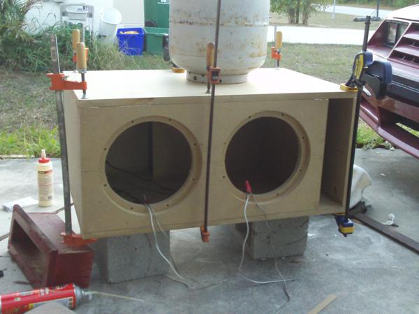

Glued the top on.

All in all I think it was a pretty successful first box build. Ran into a few snags here and there but it came out nicely. Tell me what you all think. Should I cover it with carpet? Suggestions on fixing that notch?

never used those hurricane nuts b4
with T nuts u have to drill a hole same size (preferably slightly smaller) as the nut & same depth as the nut & u hammer it in gently so it fits snugly ....some ppl tighten the bolt so it seats the nut rather than hammer it in , u can google it
imho its a bit of over kill using T nuts for these subs which are not all that heavy or powerful , self thread screws wud work fine like what i use on my idmax 12"

As for the Hurricane nuts, thats exactly how we did it, except I added glue to all of them, they still fell out, we used the recommended drill hole size too, 1/4". I was't really worried about normal screws not holding the subs, I just prefer the look of the hex bolts rather than the screws. Oh well.

The orientation of the subs was gonna be even more slanted but I ran into that T-nut issue so we left the T-nuts in the box and just screwed the subs in between the existing ones. I like that slanted look too
