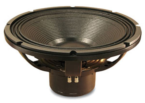

I want to change things up a little... Currently running a 15'' Q 4cuft @35hz. Really, what i want is what i have now just louder. So i was thinking of maybe doing 2 15'' Qs sealed(amp would be an aq2200). Space is limited,so something around 5cuft would be as big as i could go. Another thought was maybe just stick with a single 15 that could handle more power. A guy i know has a 15'' Treo ssx that he wants to sell. Dont really know much about them but was thinking of picking that up an just running that on the aq2200. Really not sure what direction to go here. You guys have any thoughts?

as far as the ssx vs a q, ssx hands down spl wise and low end wise itd crush the q but sq wise ehhh would prlly be personall preference. don't know if your looking to buy new or used an your price range but a couple subs off the top of my head t3 t2000, tc 5400, dd 9100, maybe the AA smd sub or ssa xcon? lot of choices really.

2 15's sealed would probally be a touch louder and have better low end but honestly not much of a gain over one ported. honestly have no clue on abrand new ssx, there hard to find used let alone new.

if you really want to get louder, upgrading the q to a different single sub set up, is not going to get much louder, it will a little bit, and be cool for the first week, but will get old quick and you will want more.
your probably better off going with 2 12's in a great box design, to really get more volume. i would guess that q would be around 140 to 142 on a termlab, maybe a little higher, but more than likely not.
these days its not too hard to build a solid box with 2 12's and power like that aq2200d and be around 148s. thats a pretty big gain

but i think your best option is to swap a q for a bl. make a box atleast 4cb ft with a port tuned to 36-38hz and use the audioque at 1 ohm..
going with alot bigger and more powerfull subs with a tiny trunk will make things worse..
or try a fi btl 15 with the same box because to get loud on your tiny trunk well you have this options
a good 15 inch sub with spl pontential and good power handling and good efficiency
or
2 12 inch sql type of woofers you can try 2 bls 12 inch with 5 cb ft of box (2.5cb per sub) with the audioque amp tuned at 36 hz for daily driver

2 15" fi q's with aeroports and seal off the trunk. that should get much louder and sound great!
or just do 2 12" fi q's in a big slot ported box, with a huge port, and tuned low

no is tiny trunk 2 15's will be alil more trouble...
i will stick with 2 12s qs 4.5cb ft and 4 inch aeroports tuned at around 34-36hz
also the bl will be significally louder but will maintain its sq it wont be too worse
you just mentioned you just want LOUDER!!
well to be honest to be LOUD has it drawbacks like loss in sq..
so its your choice get louder and lose some sq or keept it and maintain your sq....
excuse me..
the treo ssx will be LOUDER but will have much LESS sq than your Q and its alil power hungry than with your current amp
i say think about it and get the bl if not get a pair of q's or keep it

Nobody suggests the 2 15''s sealed? I just thought that adding another 15'' sub an essentially doubling the power would give me the biggest gain even tho the box is sealed. I could be totally wrong on this tho. lol
Ive thought about trying an 18'' sub. but again.. with being limited on space im not so sure id be able to fit it. Dam these small trunks to hell!!!!

listen 18s are not for an audiophile set up...
18 are too big their cones are way too big too slow.. also their sound is too deep..
some audiophiles use tens they are fast responsive because of their low moving mass so their easy to catch up.. however they dont tent to go lower than a 18inch woofer
12s are the most common subwoofers for an sq set up in my opinion and the opinion of others..
the 12 inch have the responsiveness of a 10 inch woofer with the low end of a 15 not too much low end but it has some and makes it a pretty good size of woofer for a sq
if i were you i swap it to a bl...
if not go with 2 12;s qs

18s can be fine to do sq i guess, but its really what you consider sq. none of these subs can really be a transparent sub and blend in well with the music. they can do ok, but something like a morel ultimo is a true sound quality sub. focal makes some too.
with that said, my 18" sound solutions audio xcon did very well with music and being tight. listening to dire straights i swear it sounded like i had a 10" sound quality subwoofer in a sealed box, the bass was soo tight and accurate.
more so than a 12" tc sounds lms-r or re audio sx or a number of any other subs
but then with the 18 xcon if i changed the song to drake's over, the bass was insane and shook the whole car like no other.
i still recommend 2 15" q's sealed off with aeroports or 2 12" q's in a slot ported box with 16 sq in of port per cube.
i can easily give you some numbers to get a design and tuning if you give me max measurements to work with.
2 15" q's sealed really wont be a big improvement, maybe a little tighter bass, with less risk of damaging the subs, but not going to get much louder than yours now in the ported box. maybe louder on higher frequencies, really all depending on the box and the f3 it yields
but thats quite a bit more money to spend to not get the results your after

going with two 15 q's sealed in an ideal situation will give you 3db over one ported but doubling power but from tests we have done it can yeild only a 1 db increase real world....3db increase happens but its very rare. A single sub ported with a good step up in beefiness could yeild as much 2 db real world given the right power for the sub. Overall id say two sealed subs would be better because youd get the same or better sq and a hopefull 3 db if you double the power but no less than one but more gains throughout the frequency spectrum.

The two 15'' Qs sealed is what im leaning toward. It just makes the most sense to me. Also,if at some point i get a different vehicle with more room i can put them in a ported box. My only problem would be that my current Q is d2. If i went ahead an bought another d2 do you think the aq2200 would run at .5 ohms? or would i just be better off finding an amp to run them at 2ohms? I ask cause ive heard of people running them at .5 ohms with no problems. I know i ran my aq1200 for a short time at .5 and i never had an problms. Thoughts guys?

Ok,as for the box. What size do i want to keep it around? What would be the smallest without losing anything?

As for the box? Do you think 4cuft would be to small?

go sealed 4 cubic feet for both 15's but make sure to add at least 4 pounds of polyfill total (2 lbs for each chamber) and youll be good to go...it will make the box appear larger to the subs with polyfill
