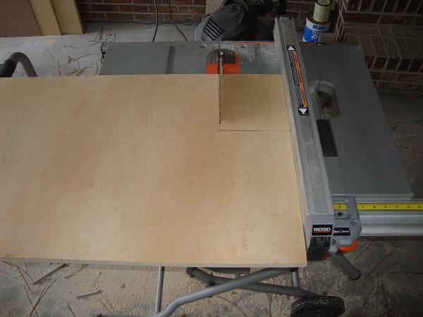

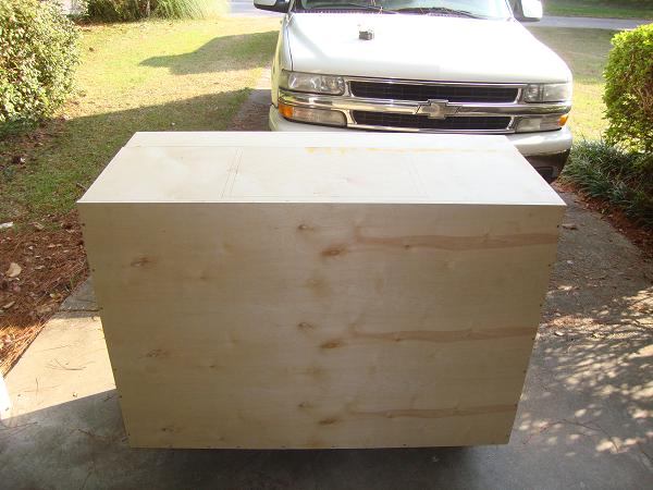

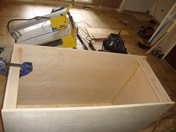

In between real work I spent a few hours working on a new box. I wanted a little more low end, and a bit more output so I decided to go from 15 feet net to 18 feet net.
Both boxes are at 36 Hz, but this new one is closer to the tailgate and should load nicely, with the actual tuning dropping a bit. Port area is 230 sq inches, though it's a removable port.

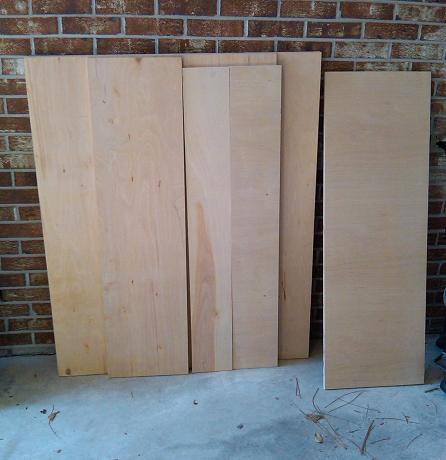

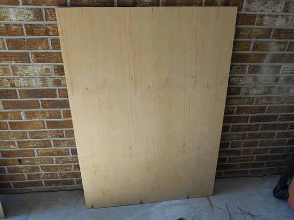

I wanted to do birch this time to shed a few pounds, I think the last box was in the 300lb+ range, where this one is bigger and shouldn't break 250 I hope.

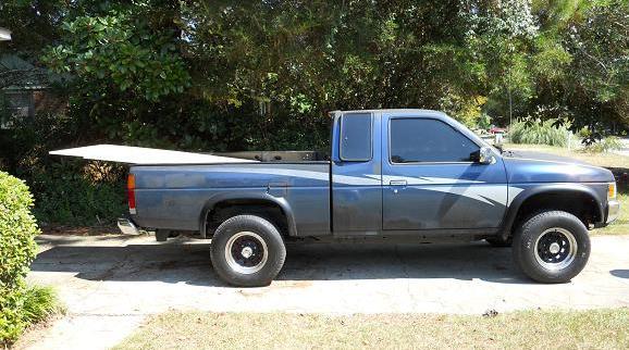

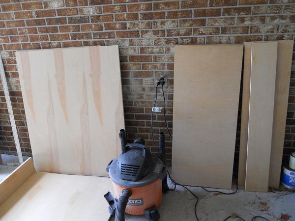

My bro hauled me around in his beater instead of me using a trailer to pick up supplies. 4 sheets of 3/4" Birch.
Mobile work shop, I work in several locations so this stuff works great for me.
Can you tell I like Rigid? lol.

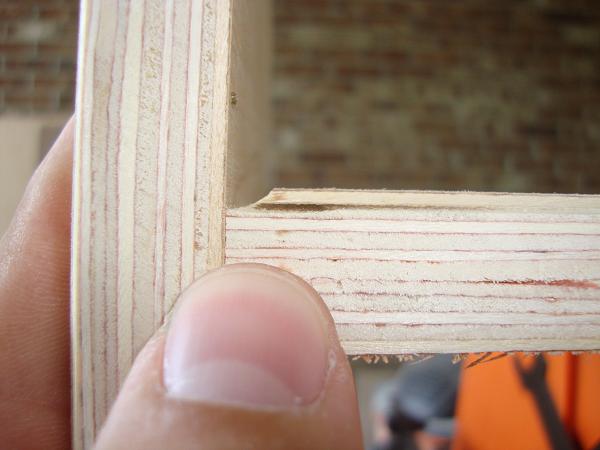

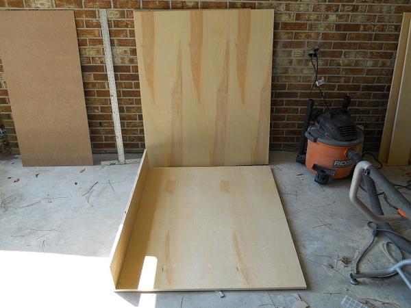

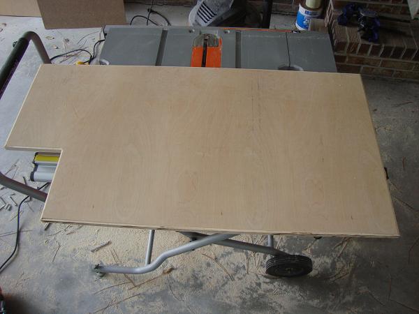

45's cut, I'll be cutting them to size with a miter saw from here.

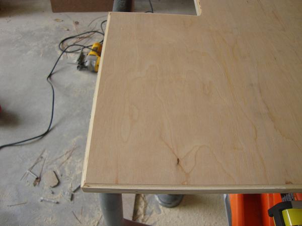

Cut out the small corner for the amp/battery.

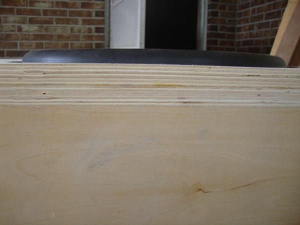

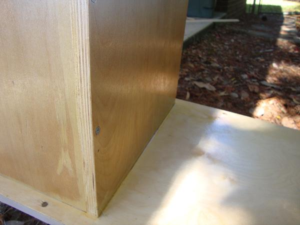

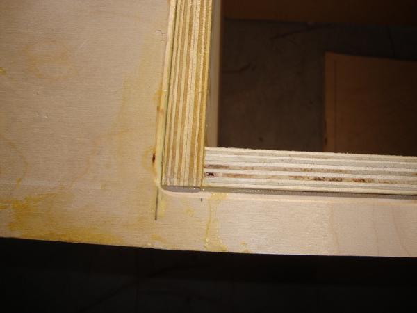

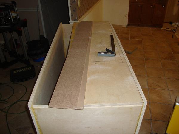

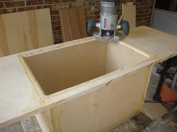

I cut about a 1/8" ridge along the sides to tuck the vinyl.
1 side routered out.
You can get an idea of how the seam will fit.
Routed out the other side.
The port mocked up for size reference, it's 12x19.

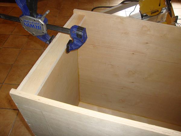

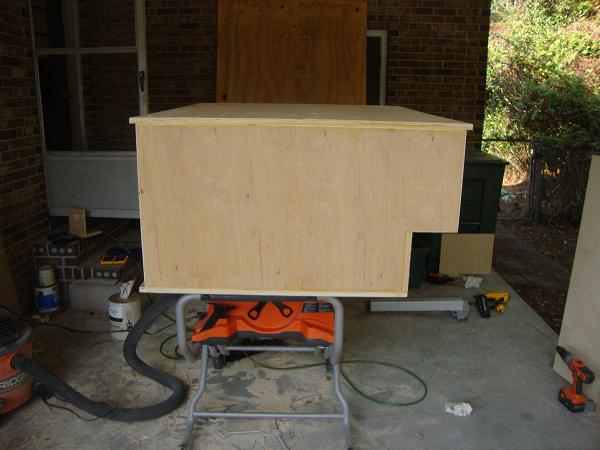

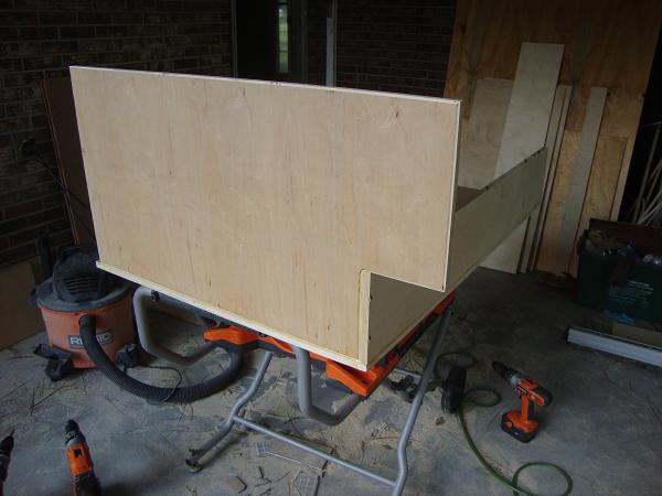

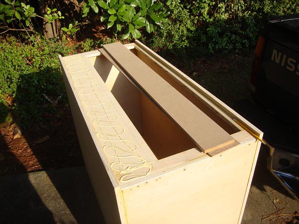

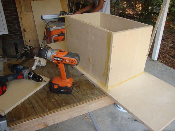

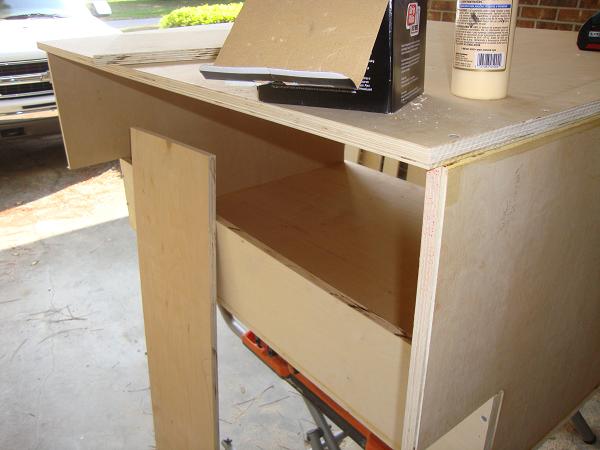

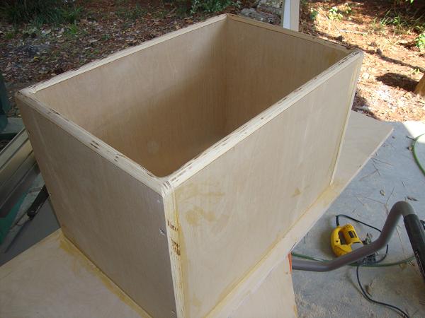

I busted out the nailer and started assembly. I'm using screws about every 6 inches apart, but it's great to pop a nail in to hold while I line things up and drill/screw.
That ridge I routed out makes it appear that the box isn't lined up right in some shots- it's just the lighting.

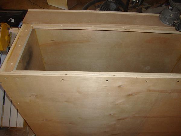

First layer of the top put on.
The back side

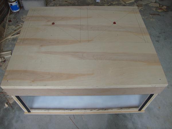

Marked the port to cut.

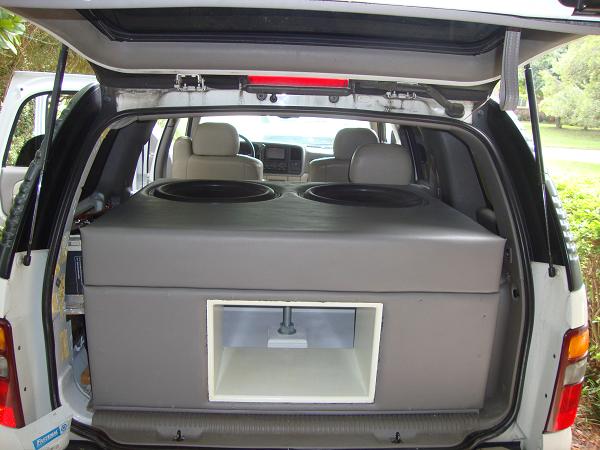

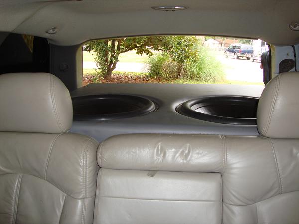

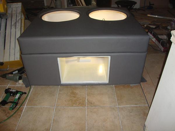

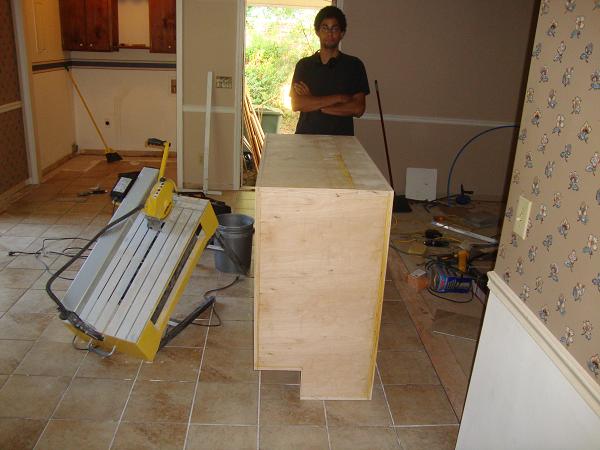

This shot doesn't really do justice, it's got some size to it. Stored in the stash house till I can get back to work on it.

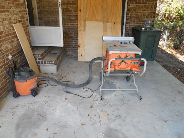

And damit if I didn't used to use that EXACT same table saw!!!! Until the height adjustment broke (heads up, clean and oil it). I built some sick chit w/ that saw. Very nice how it can fold up and roll into a corner.
Boss-man got a nice Delta after that, the gate is WAY nicer. Not mobile though...lol.
I also have that same Ridgid router. I use it for round-over and flush-trim bits, its a little monster. Got a little $80 craftsman I keep a down-spiral bit and jasper jig on at all time. My nailgun is a Ridgid also.
You shop at Lowes....right?
I use the same screws too....lol

The port isn't using the bottom as one of the walls this time, so it's a bit uncomfortable to get in/out of. Having crawled in the port last time to rewire the subs, I hope to never do that again.

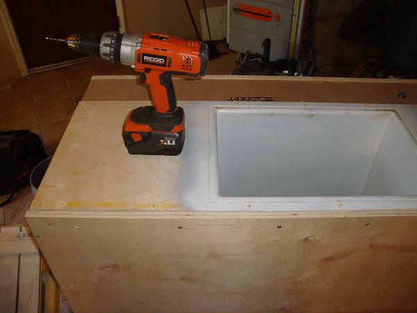

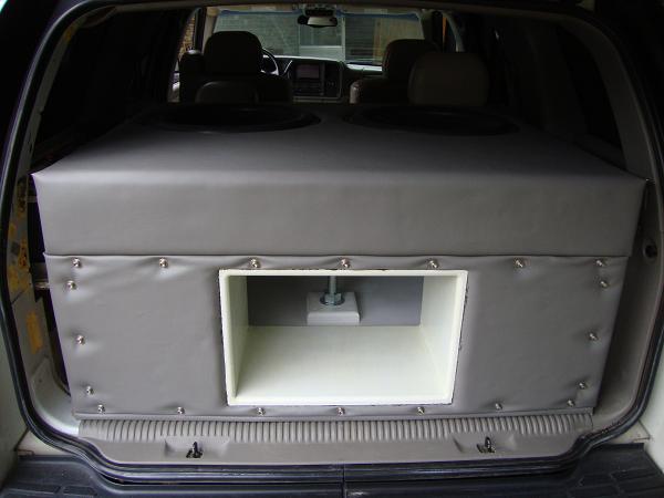

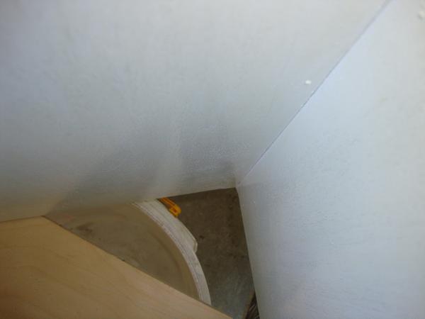

Mounting locations for the port:

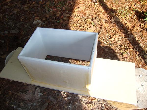

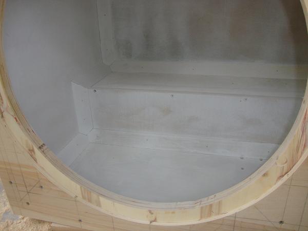

I cut out the port and attached the walls. I did it a little different this time. Instead of cutting the hole to size and attaching the port to the back side of the port face, I cut the hole to drop the port in. It should help hold it snug that way, and allowed me to route out the ridge to glue the vinyl.
3/4 round over inside and out

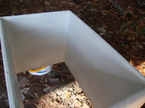

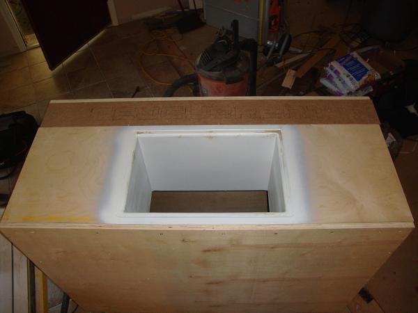

I sprayed on a can of filler primer and some white paint. I'll be using wood filler to touch up the nail holes, this just helps me see them.

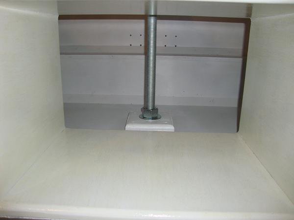

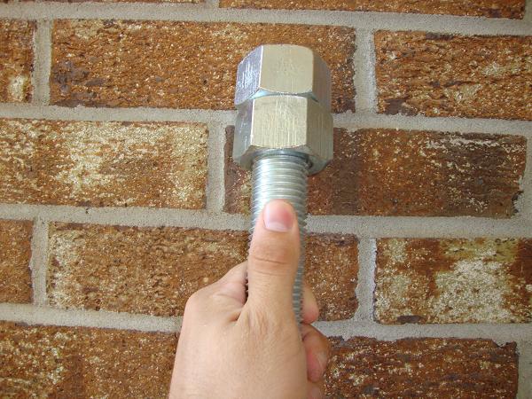

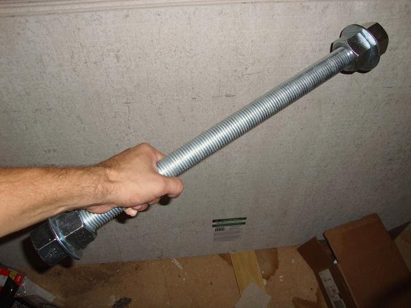

Also picked up the bracing. 1.25" threaded rod.

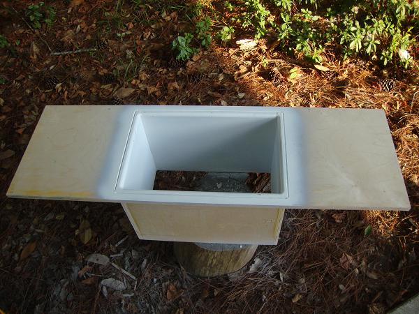

Test fitting the port. You can see the 3/4" dip still remaining for the top portion.
Adding the 1/2" piece, it will be covered so it wont matter that it's mdf instead of ply. It also has the .75" birch behind it so it should be pretty strong.

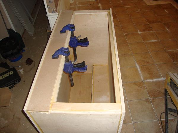

I cut some 45's on the miter saw. I didn't finish, just wanted to pop the few pieces in the bottom so I could start coating it at the end of the day, it'll be a couple day thing for all the coats to dry I believe.
I put some wood filler in some screw/nail holes. Mainly around the port opening so I can smooth it off and coat it, basically prepping it before vinyl.

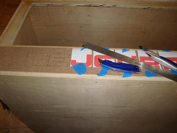

Then I got some work done on that mdf section. I traced the lettering on the 1/4" piece.
You can see the gap where it will drop in. Once the 1/4" piece is in place you can see it sticks past the front of the box about 1/8" further than the port. This is because of the thickness of the gasket behind the port making it stick out about 1/8"- it should be flush when complete.

Dude that threaded rod looks like it could hold a truck on tensile weight! In compression it should do fine lol.

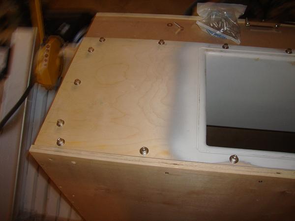

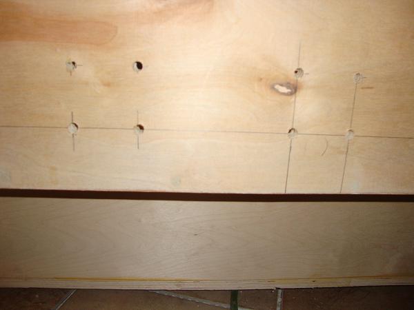

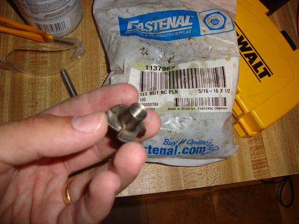

Pre-drilling the bolts/t-nuts
sanded any burrs smooth
5/16" stainless, should work well and look nice
Test fitting

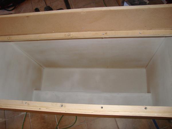

The final coat of paint on the port, then a first coat to smooth things out.
first coat of paint inside down, I'm making the inside white this time.

Okay, the lettering looked like crap so I scrapped the idea of doing it the way I started. Does anyone have any ideas on how to get nice lettering on the box? I was considering embroidering it on, but I don't know anywhere that does that and I don't have a sewing machine. Also considering slapping on a vinyl sticker where I wanted it but that's just ghetto.
Another thought was having the panel cnc cut, painted the holes white and vinyling up do the lettering but I don't know that I like that either.
Any thoughts welcome.

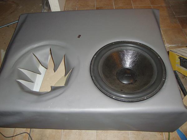

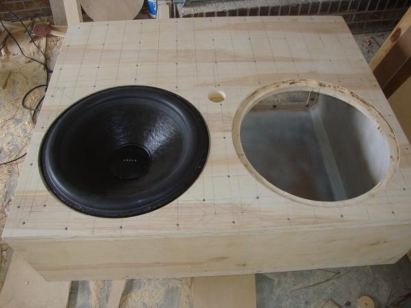

Damn I need some better glue for around the port! I started vinyl on it and I'm pretty happy with everything but the seam at the port. The adhesive just doesn't have enough initial tack to hold to the wood until it sets, so I'll be buying some different glue today.

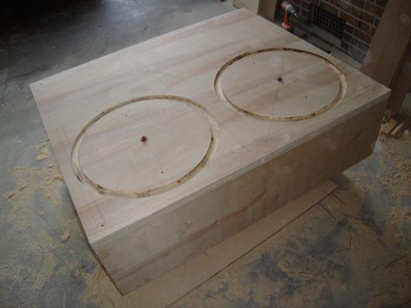

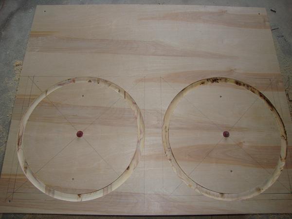

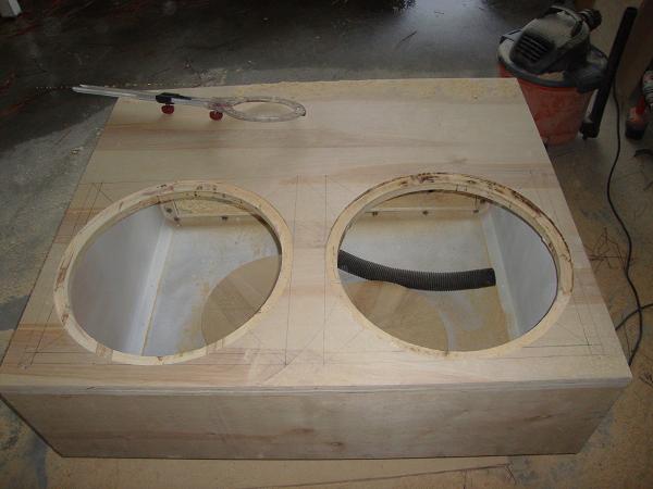

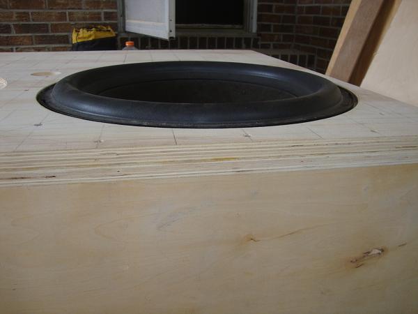

I got the sub holes cut out and the second baffle put on yesterday, hopefully I'll get the rest done. I'll still have to wait for the junk inside to dry a day before I put it in my car, but at least I can hopefully just have vinyl left to do tomorrow.
The website says the measurements are 19.25 cut out, 21.25 OD. I tried this last time and couldn't fit the sub in the hole, so this time I did .25 larger in the hopes I wont have to go back to it. I use a 1/2" bit in the router. It makes hellacious dust but is much faster and sturdier than a 1/8".
recessed mounting for the sub

the top almost does not look strong enough to take the force of the subs but that may just be me.
Username: Tejcurrent
Post Number: 2483
Registered: Apr-07
Its as thick as the last box, 1.5 inch though birch instead of mdf.
Also this box has better bracing and several coats of poly inside, as well as 45 bracing in all the corners. Better built too, I rushed and cut corners on the last box.
Post Number: 2484
Registered: Apr-07
I almost finished today. Too bad I had to do some real work
If I have a few hours tomorrow I'll have it playing, but I have a crazy schedule so I'm not sure I'll get to it.

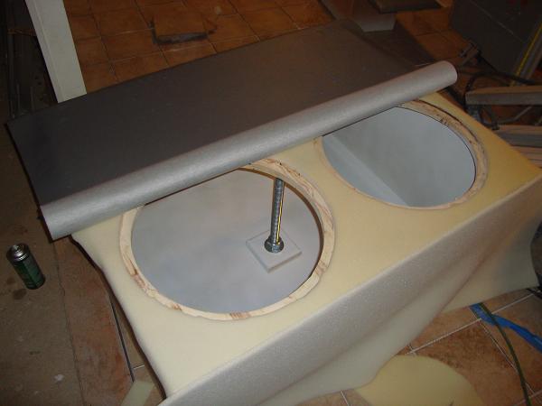

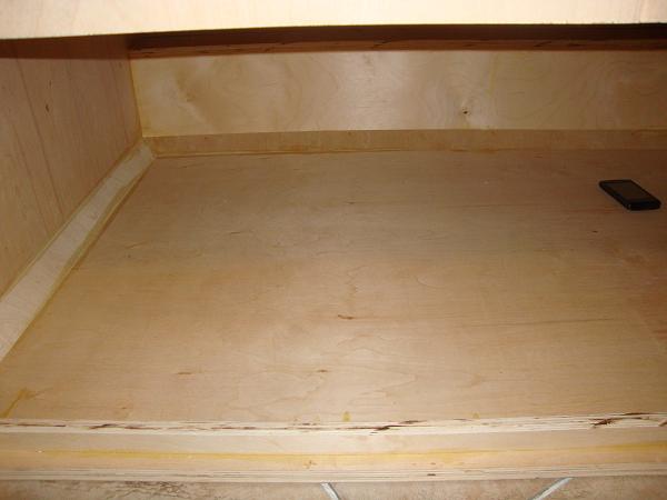

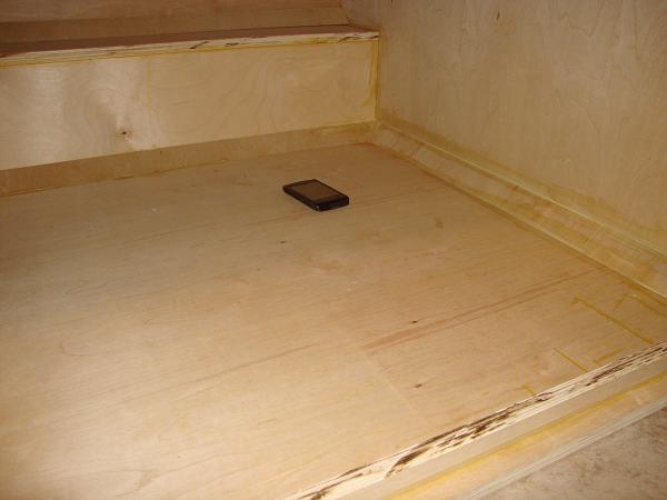

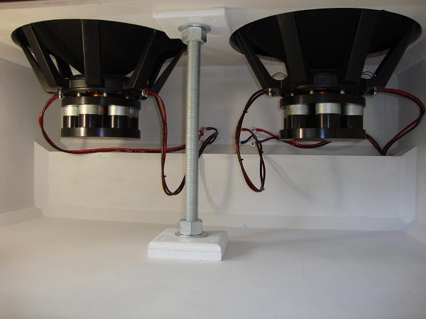

Finished the 45's in all the corners.
And the beginning of the bracing.

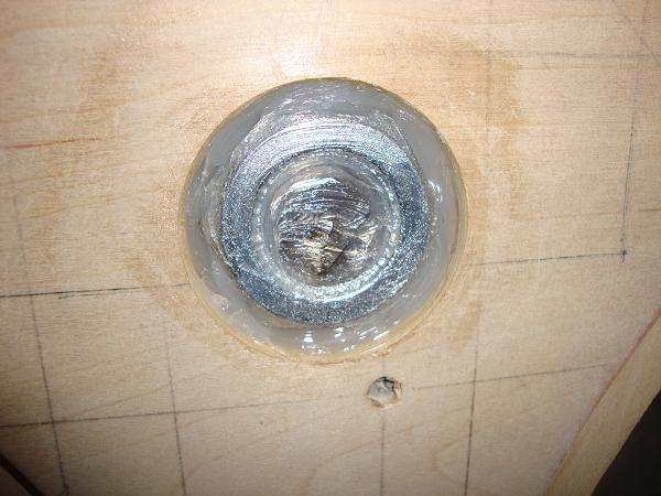

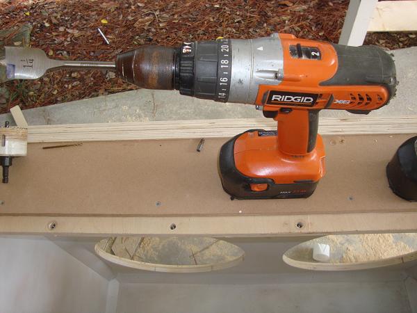

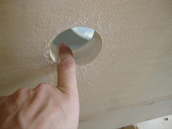

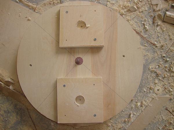

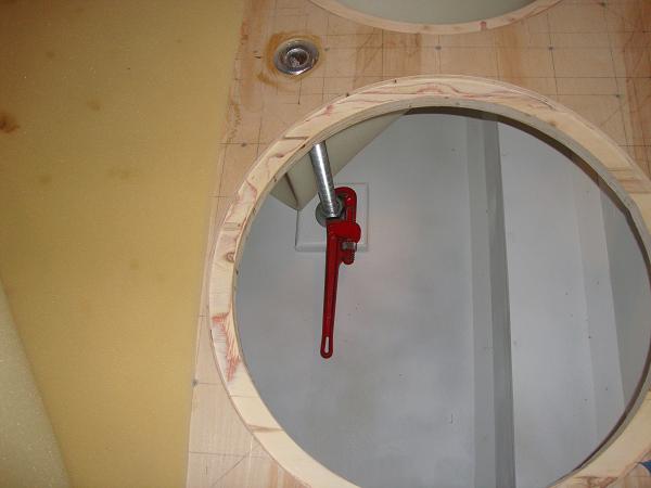

I used a 1.25" spade bit for the inside layer (3 total). The outer 2 layers of wood allow the nut on the end of the rod to be recessed.
Then a 2.5" hole saw for the outer two layers.
Just cupping my nuts
Then I cut the rod to fit. Normally it's quick work but it took a few minutes, then I used an angle grinder to clean the cut.
Test fit a sub to make sure the holes were good. There's a tad bit of play, but that'll be taken up by vinyl.

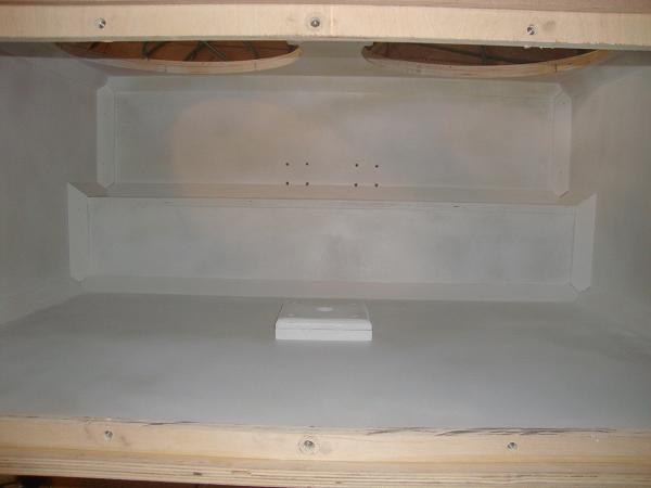

2 layers of poly inside the box. I'm going to sand the inside smooth tomorrow and hit it with a bit more paint. Then all I have to do is vinyl, wire, and slap the box in.

The size of that threaded rod and nut is unreal. Wow. Awesome build Troy. Can't wait to see some videos.

that rod looks like a dam club for killing bears. your subs haft to be fun to pop in and out.

I was soo close to finishing but had too much real work to do. I only got in an hour or two at the end of the day. I'm trying to set aside a few hours in the morning to uninstall the old box, bolt this one in and wire things up, but I ran out of adhesive and paint which will eat at least an hour out of my morning to go pick up. If I can get things finished in 2 hours and the old stuff out in an hour or so I'll have this up and running by lunch time, otherwise it may be next week before I have time to install.
I started out by sanding the inside down with 220, then hitting it with another coat of satin white.

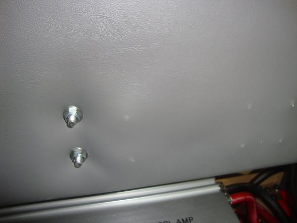

Threaded rod installed, I used silicone around the rod and then around the nut.

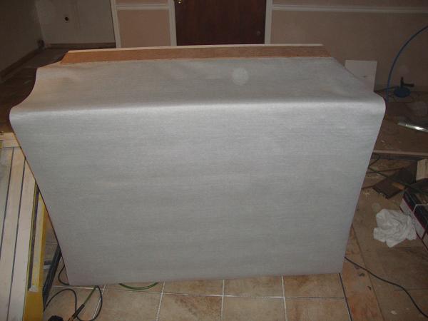

Then I started wrapping.
And here's the point where I ran out of adhesive. The port looks like crap around the opening where the normal stuff just didn't have enough tack to fight against the foam. Nothing a trip to the hardware store wont fix.
I can say I've tried a ton of different bracing styles, but that one piece of threaded rod has that baffle solid
Post Number: 2495
Registered: Apr-07

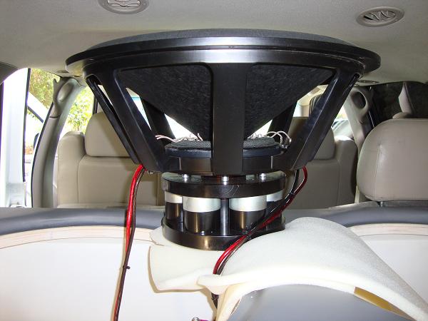

I got the box in, it looks better than the old one but I'm not happy with it. That padding makes it sit too close to the tail gate- it's choking. I may chop 3 inches off the back side and see if that helps.
Output is not as loud as the other box. It gets much lower, but it just doesn't have the output I want. The subs also seem to have more trouble with the power I'm giving them (which is the same).
If this doesn't work out I'll be back to the drawing board.

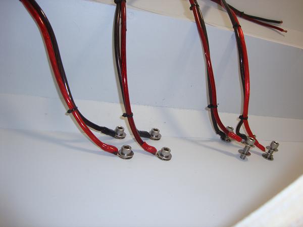

Wiring up the subs
The port opening needs cleaned up some, but I wanted to test before putting more work in it.
with thinner or no padding this would've looked good but I don't like the end result.
and a short video is uploading now- a little bottle-float trick.

the screw in port does not look as good as i thought it would. that the same thing you don't like? whats up with the power issue?

"I wanted to do birch this time to shed a few pounds, I think the last box was in the 300lb+ range, where this one is bigger and shouldn't break 250 I hope."
theres my answer I was going to say maybe thats why it cant handle the power the same the box is too big
Post Number: 2496
Registered: Apr-07
Yes, I think it's too big for the power. Strange though because I had a 18" btl take 4kw in 8ft net no sweat. These things still aren't moving like I know they can.
I really don't like the screws around the port, they just looked ugly.
The box is 3 feet bigger than before. I'm thinking I'll chop it down to about 1 foot bigger than the old box and see how that does.
