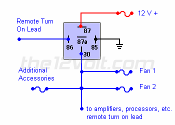

Okay, I get the jist of this diagram. My question is which of these wires hook up to the positive and negative of the fans, etc.?
image/bmpUpload
Does it go like this?:
http://i161.photobucket.com/albums/t227/nyoc2020/addremacc2.jpg

yes

Yes, use output from Pin30 for the fans + side.
Also, fuse the Pin87 input.
The fans - input can just be grounded anywhere on the vehicles body/chassis.

or you can make a ground point on the amp rack you are using and ground every thing together and make it ezier to remove the amp rack.

That would work too, say like a buss-bar or a dedicated battery.
