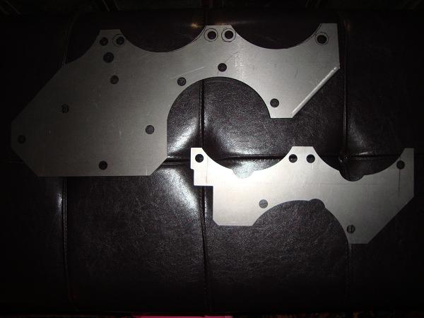

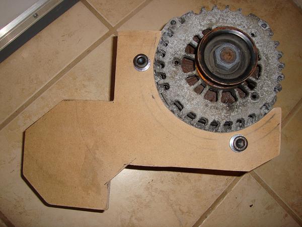

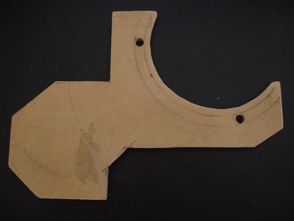

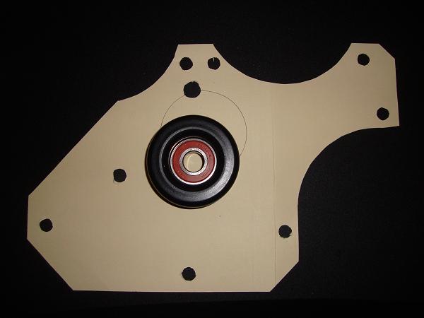

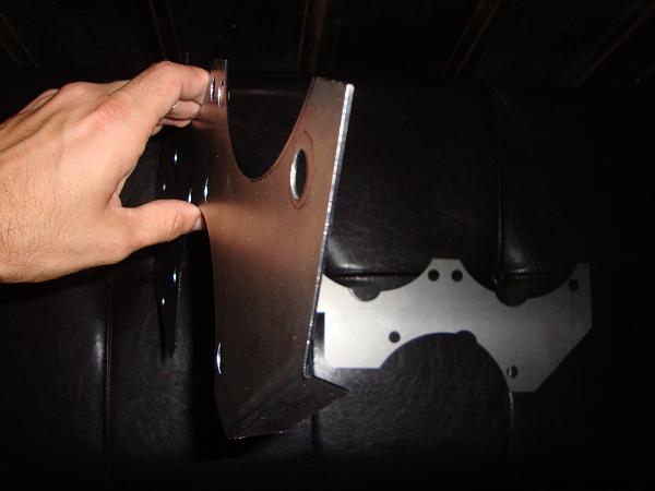

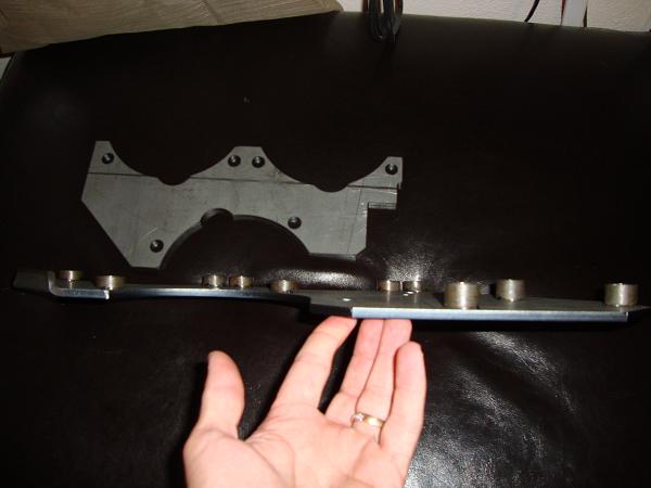

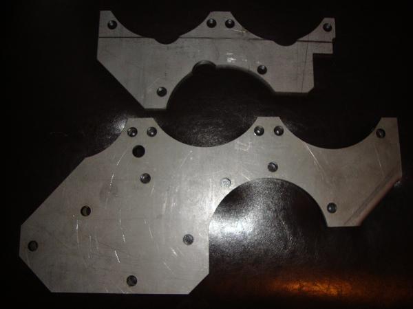

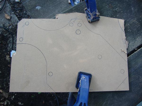

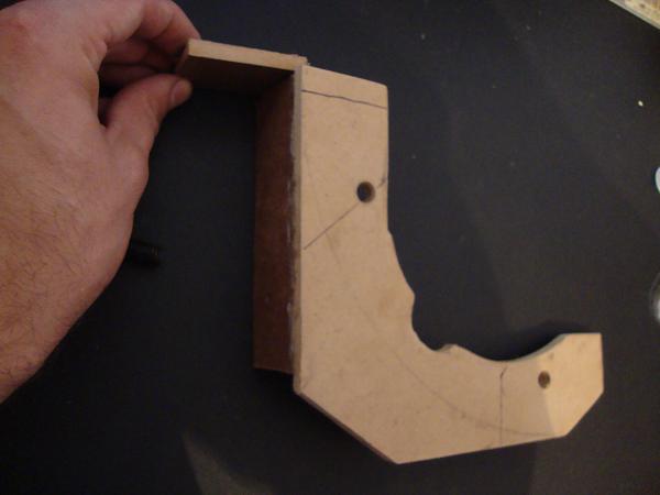

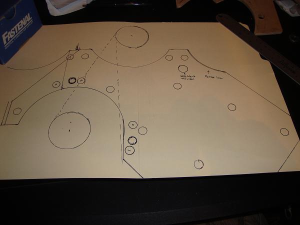

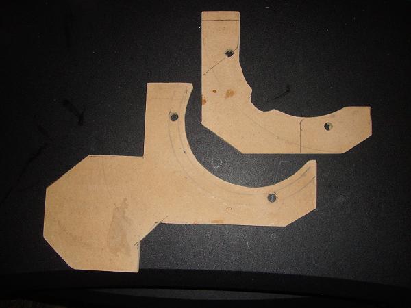

Here's the first template back from the machine shop. It is just a bit off from where it needs to be, so after the adjustments are made Monday it will be cut in 1/4" steel.
I just wanted to give a preview: CAD drawn, laser cut. The final product will be powder coated black, which I should have the prototype of the beginning of the week, and installed same or next day
Again these are just templates till we get things right, then it will be cut in thicker material.

This bracket can run 1, 2, or 3 alts instead with pulley relocation
Or I was going to eventually make dual and triple brackets for the same engine. I still don't know the final price per bracket after powder coating but they'll be affordable and very high quality.

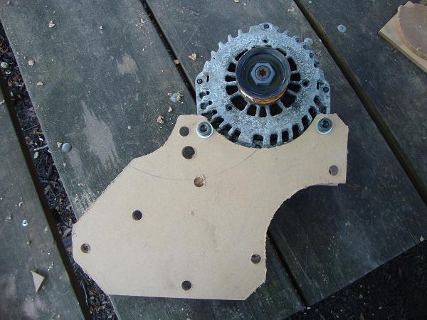

I dropped off the template with changes this morning, I should have a working prototype tomorrow. I sure hope I can get it with vids tomorrow

Thanks guys. Still waiting on the spacers to be welded on, hopefully it'll be done tomorrow.

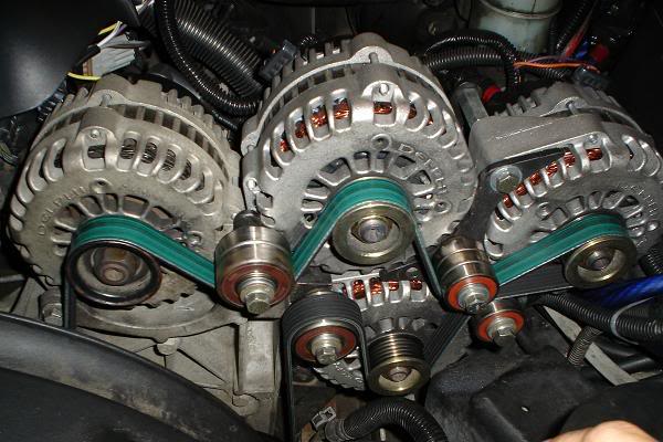

It's finally done!! I'm ecstatic about this, so please feel free to (anyone) to comment.
It's still not finalized, it's going on the vehicle for testing and if all goes well more will be made and powder coated. Since this is the prototype there was no reason to pay for powder coating yet.
I've purchased alternator brackets before that required drilling mounting holes, or a degree in engineering to figure out since the directions were not narrated and it came in a dozen pieces. This is two large plates that only fit one way, and should take less than 1 hour for anyone with a wrench to install.
On to pics:

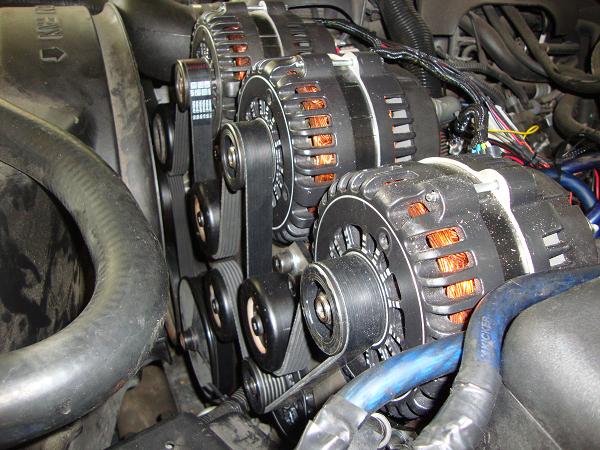

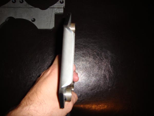

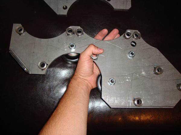

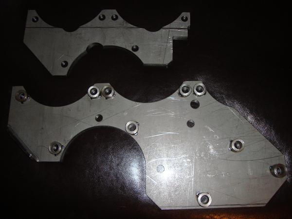

A front shot, again before powder coating:
A back shot of the main piece:
A side view of the edge, it's rolled over to add strength on that far end.

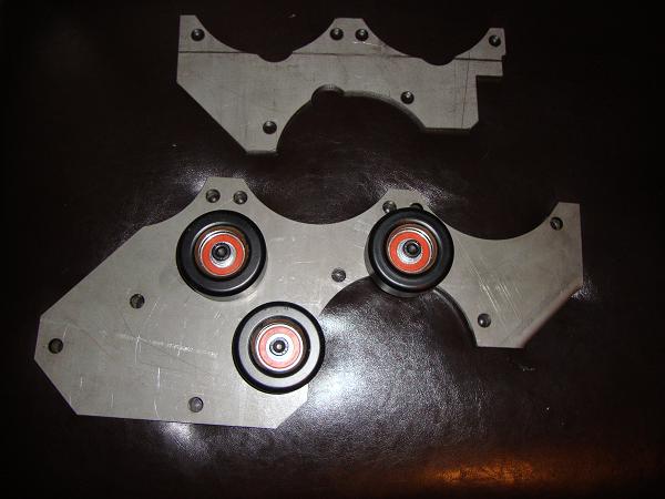

Pulleys added - important first step to make things easier for installation. Lock- nuts and spacers with grade 12.9 metric bolts.

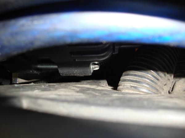

First alternator in place

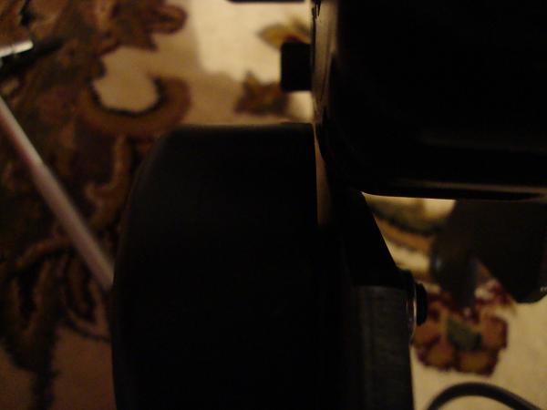

Clearance from pulley to alt is about 1 mm. This is necessary to give the best belt wrap.
The plug for the alternator on this bracket should now be attached and the bracket bolted to the frame. It's too dark to do that now so I'll post install pics tomorrow. Then it's just 10 minutes of bolting the extra alts in, and however long it takes to do the wiring.

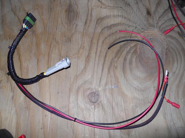

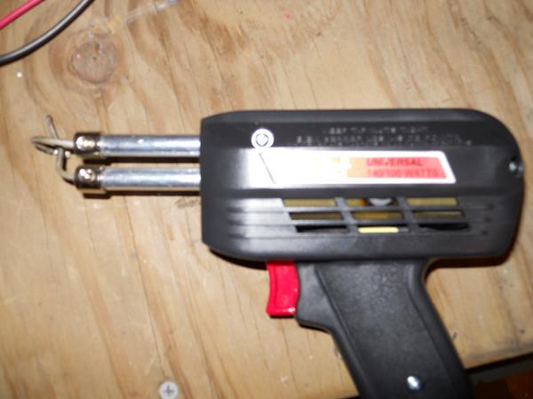

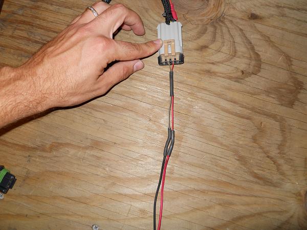

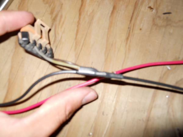

I'm using a XS Power VCM, which requires extra wiring. I started but my soldering gun tip was messed up, and I bent it the rest of the way in frustration.

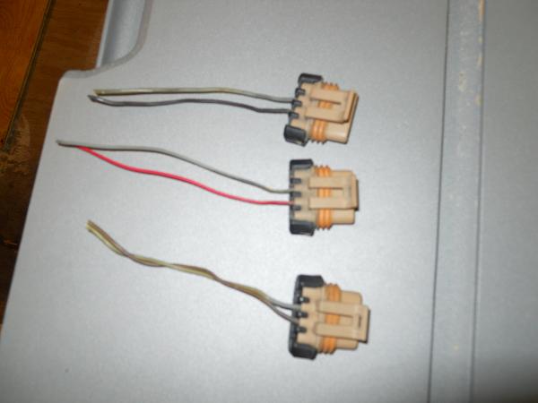

I spent almost 5 hours today searching for plugs for my alternators, only to end up crawling through the mud in a scrap yard chopping the harnesses out of wrecked GM trucks lol.
I would have had this bracket on if it wasn't for my inability to find these plugs locally. I will have to find a supplier online and order some new ones I guess.
Soldering in a small piece of extra wire to one plug
XS Power will tell you not to splice their harnesses. I don't want to alter my factory wiring so I did it anyway. I split the two center wires, and added about 1 foot of my own. Soldered in, covered in heat shrink tubing, and zip tied back up.
I started on the 2nd plug when my soldering iron died.

Ha, I have that same exact style soldering gun. Had it for over ten years now. Still works great. Besides the weird humming noise it does I like it alot.
Username: Tejcurrent
Post Number: 2326
Registered: Apr-07
Damn tips get even a little bent and the thing takes 5 minutes to solder a 16 gauge wire. I can't find new tips locally so I had to buy a whole new gun. Resizing pics and uploading in both threads
Holy crap! You're not worried about material expansion due to temperature extremes?
And I use those soldering guns myself. They do indeed build up heat and should be left to cool every couple minutes of use. The old fashion pen styles are better IMO.
Post Number: 2329
Registered: Apr-07
This just gets hot really fast paul. No, I'm really not worried about expansion. By being so close the belt has the most wrap on the pulley, and no twisting to cause belt rub or wear.

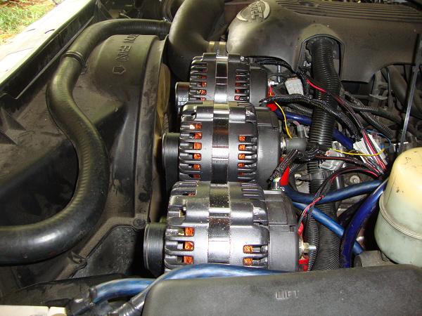

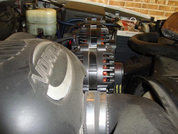

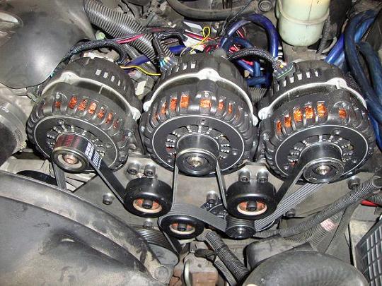

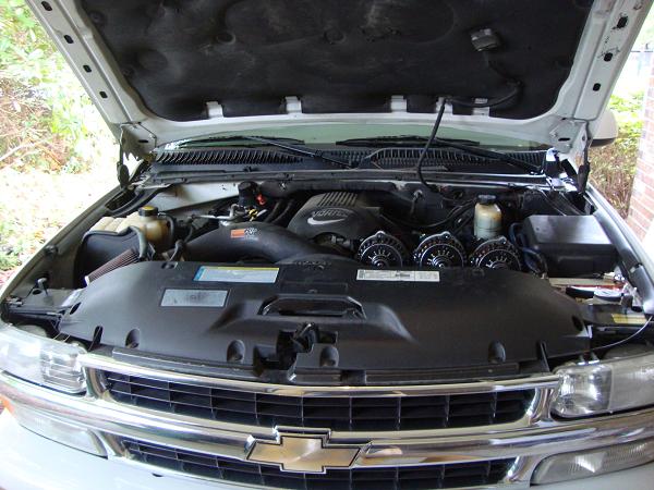

Installed! It worked perfectly the hour or so I had it running, though I'm going to give it hell for a week before going further with powder coating etc etc.
about 1/4 inch clearance from the fuse box. Plenty of room to run wires over or under the bracket though.
I posted more pics of the VCM in the dash thread, but here's a few
Anyone interested in buying one? I'll sell it dirt cheap with black powder coating and ready to install just to get some feedback
Here's a vid
I turned the amp up some, not a lot, but it is a lot louder! I had to turn it down because coffee was shooting 1-2 feet into the air out of my SEALED mug. I've only had it leak when it's turned sideway so that's saying something. I feel pretty confident in the 49.9 class now, though I'll have to get back to the meter.

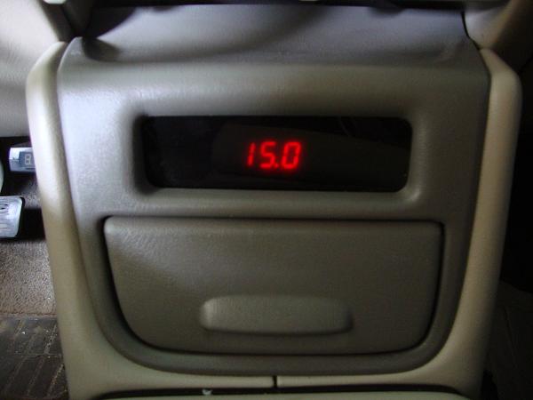

My voltage dropped to 14.6 for a second, then went back to 14.8 once things got hot.

Also paul, if anyone is really worried about the pulley spacing from the alt it would be very easy to just add a washer to each leg of the alternator. This would give someone another mm between the pulley and alt, but this spacing keeps the belt in a straight line from the engine to the factory alt, through all additional alts and pulleys, and back to the vehicle.

Paul, I was surprised there was no drop at idle. It's still not all the way up though, the voltage at the RCAs is around 1.3, and I have the amp set to 3. I need more time to tune the amp, but I doubt I'l ever turn it up all the way when I'm running it at 1 ohm. As long as I re-meter at 153 I don't care. I want to test how big a difference the alts make, then rebuild and do GOOD boxes

Still testing the bracket, alls working good. Really good hair tricks when the kid(s) aren't in the car.
Anyone want a dual or 3 alt bracket for newer GM suvs with the 5.3 and I think 6.0? Mocked up a template tonight, any thoughts? I can sell these really cheap to those interested
They work as a Dual alternator bracket, and by simply adding a pulley and relocating the first to another hole (all pre-existing) you can add a third alternator down the road. Please forgive the MS Paint sketch to demonstrate while things are still being made.
Thoughts? I tried to make it look good with or without the 3rd alt, though I know until it's in metal it's a little difficult to get a good idea of things.
Post Number: 2341
Registered: Apr-07

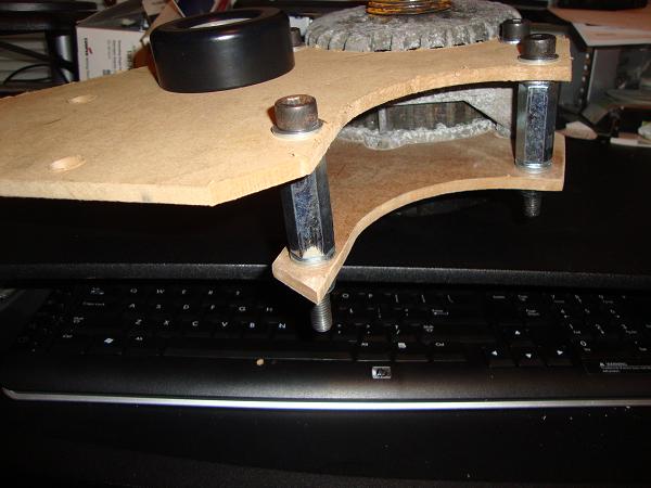

I also started on a dual alternator bracket for the GM 5.7, though the version I'm making fits (I believe, not sure of all models) 95-97 full size trucks with the alternator on the passengers side. Like this:
http://image.sporttruck.com/f/9278796+w750+st0/0502st_04_z+1996_chevrolet_silverado+engine_bay.jpg
Sketch:
2 sides, front and back.
The front doesn't have mounting holes drilled yet, but there are 2 bolts it will fasten to.
The back is for strength, but will have a rolled edge to also fasten to the engine. I can't bend 1/4" mdf accurately so you'll have to bear with me when I just glue it for a mock up.
snug fit
both pieces together.
This bracket will be super beefy, held in place in by 3 bolts that will prevent both up/down and back/forth motion, 1/2" thick the whole way. Because of cost I wont be producing this in metal until I get at least 2 requests- but it's the only one I've seen available for that engine setup. Maybe someone can prove me wrong?
Post Number: 2344
Registered: Apr-07
Dual bracket ready to locate pulleys. It needs the rough edges cleaned up but I don't think I will, it's being drawn up in cad anyway- this is just for trial.
The beauty of this dual bracket for the 5.3 V8 is that it looks clean as a dual bracket, but by adding another pulley and a longer belt a 3rd alternator can be added at will- no modification needed. It'll be very affordable and extremely solid. When only using 2 alts it has "spacers" and bolts to fill the holes/gap so that no strength is lost and the space between the front and back brackets remains the same.

My GM quad and dual bracket will fit 1999-2010 Vortec 4.8, 5.3, 6.0, and 6.2l engines. The 4.3l bracket fits Fits s-10, Blazer, Bravada, Safari, Astro, Express, and to my knowledge is not offered by anyone else.There is a 3 year warranty on all brackets, so if there's a problem you will be taken care of.
