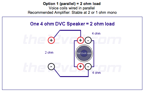

Bronze Member Username: Not1337Post Number: 13 Registered: Jun-10 | @rosrock is there a tutorial on how to do this? BTW thanks for all the help guys! |
Gold Member Username: Kyle_lowePost Number: 1129 Registered: Apr-06 | http://www.the12volt.com/caraudio/woofer_configurations.asp?Q=1&I=42#results ![]() |
