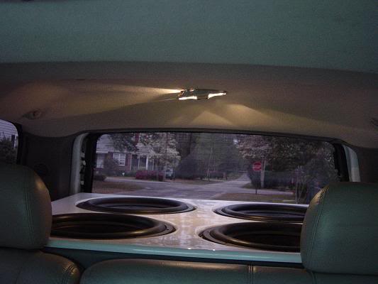

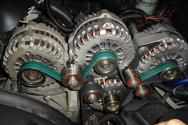

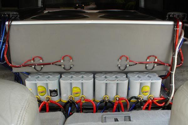

I can't find the thread on this forum, so here are a few pics:
Alternators
Rear before trim plate- 36hz removable port.
Rear with trimplate (I wish I'd painted the whole thing white or vinyled the entire box
Batts/wiring
View from inside
One of the 4 4kws, I lined them on the side of the box.
Between the wiring, weight of the box, and the amp location you could not fit the box out of the truck without an angled drill and about 20 minutes of removing amps.
