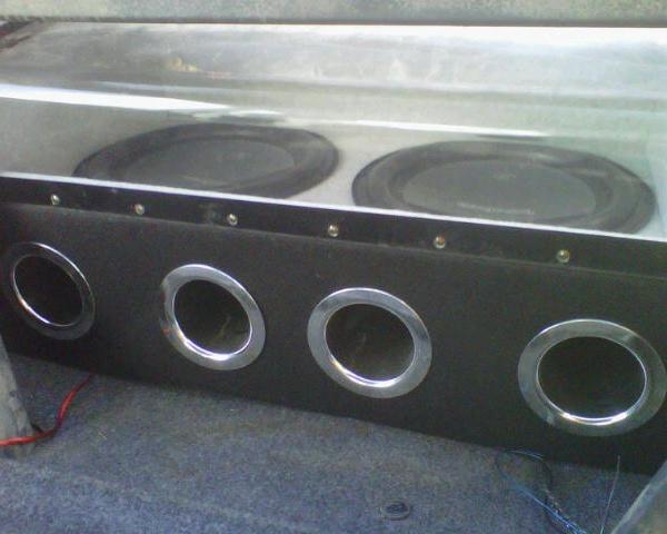

New member Username: Fashionstar3Post Number: 3 Registered: Apr-10 | http://www.amazon.com/MD-Sound-MD-2628M-Watts-Amplifier/dp/B002M4XT32 hope that helps? and im trying to upload a picture of my box but it says i have to make it smaller but i'll keep trying Shawn |
New member Username: Fashionstar3Post Number: 4 Registered: Apr-10 | ![]() |
Platinum Member Username: GlasswolfColumbia, SC USA Post Number: 12961 Registered: Dec-03 | OK, that box is pre-fabricated and probably not tuned. Those ports should be trimmed to tune tthe box to around 34Hz, to make it sound a lot better. Also your subs are rated for continuous 500 watts RMS combined, and the amp is rated for 600 watts RMS, so if you want louder, your best bet is to go with two better subs, and honestly, a better amp, too. These are the specs on the amp: # Mono Block # 4 Ohm Rms: 600 # 2 Ohm Rms: 750 Generally when an amp can't double it's power going from 4 ohms to 2 ohms, this is an indicator that the power supply in the amp isn't a good one. This means the amp doesn't ahve enough reserve power, or dynamic headroom to handle sudden large spikes in demand, and will tend to clip instead, which will cause the amp to sound flat, the speakers to distort, and possibly even damage teh subs in the process from excess heat buildup in teh coils from clipped DC voltage. I'd recommend looking at a bigger amp, like a Sundown or Auqioque 1200 watt @ 2 ohm mono sub amp (Orion and PPI have decent amps in that power range, too) then going to a better pair of subs, like Fi SSD 12", or even a single 15", and having a custom slot-ported box made for the sub(s) The difference will be night and day. |
