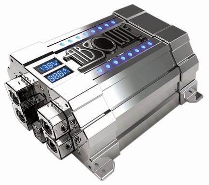

I love how hardcore some caps have become. Boss has one (forgot the farad rating) that costs $360. For that price most people could afford a HO alt haha. Check it out: Upload
On another note: Whoa! Glass is still here? ;) Crazy. I haven't see Glasswolf on AIM for years now. New AIM handle or just not into that anymore?

Those large Farad rated (20-50+Fd) capacitors are typically carbon caps, and have a retardedly high ESR, which means they respond slowly, making them less than useless for these applications.
Stick to the 5Fd and smaller caps (electrolytic, 16-20V rating) to get a good ESR value. (equivalent serial resistance)
Capacitors can help if your alternator is of sufficient size, because they react faster than an alternator does, but if the alternator is too small and can't provide adequte current on demand, then the capacitor will only mask the symptoms by smoothing out spikes in the already sagging voltage rails, and at that point your amplifiers will begin to clip their signals, and damage your speakers.
