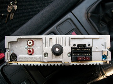

ok i took out my head unit and took a photo of it coz i have no idea what the red one is, is it like tv rca where its just left and right? probably is, sorry for stupid question and from looking at this is it possible to connect a 4 channel amp to it? thanks for the help

white is left channel, red is right channel subwoofer outputs.
ideally you'd want a head unit without internal power, and just 3 pair of RCA line outputs if you want to run amplifiers for the whole system and not just to add subs.
the problem with units like yours is while you can add virtually unlimited power with amplifiers to drive your subs, you're still always going to be stuck at the head unit's 12 watts or so per channel for everything else (door speakers)
This means you'll always get a lot of distortion in the speakers that handle 70% of your audio (vocals) and they will always be horribly underpowered, leading to the bass washing out everything else. I've been in countless systems like this, and it's awful.
One thing people always remark on when they hear systems I've designed, is that the treble and vocals never get overpowered by the bass, even when there's enough bass to make it hard to breathe in the car.
That's how it should be.
