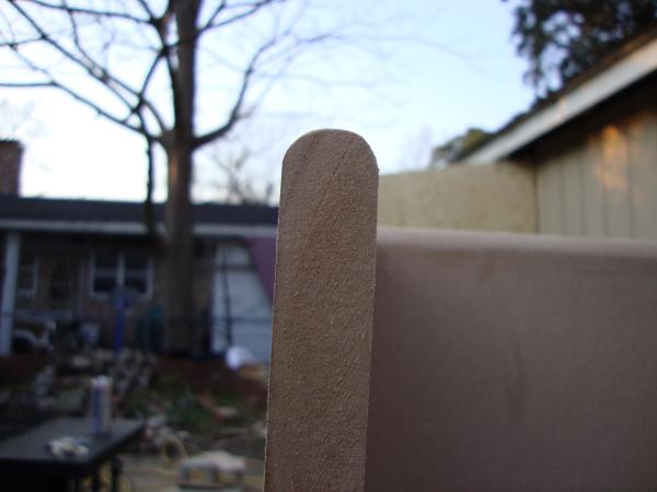

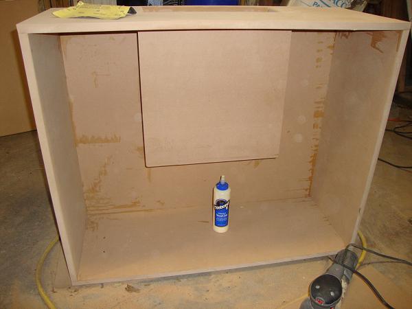

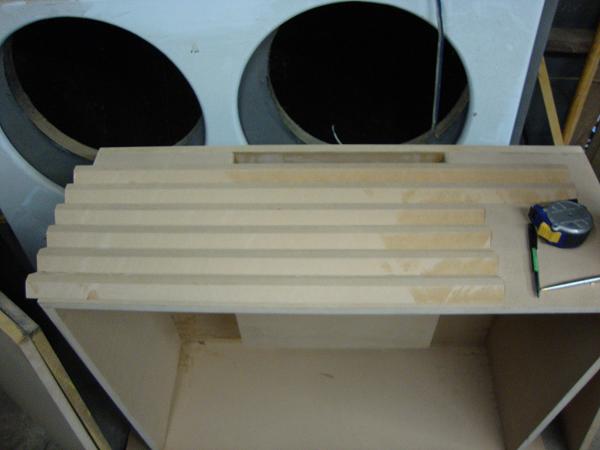

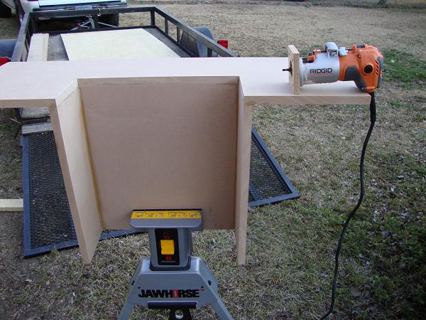

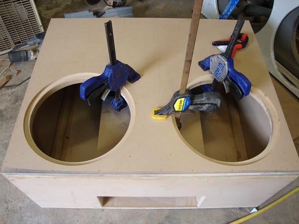

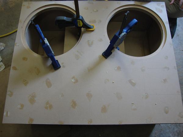

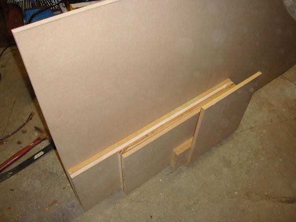

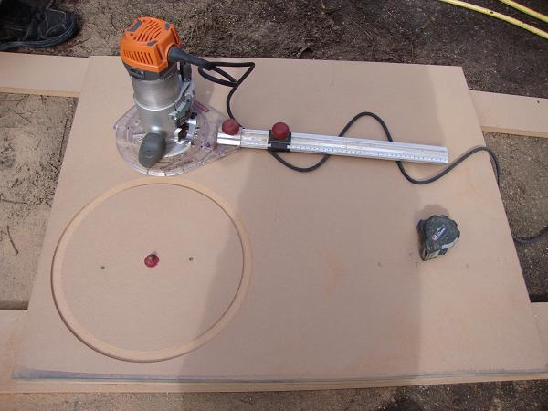

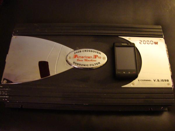

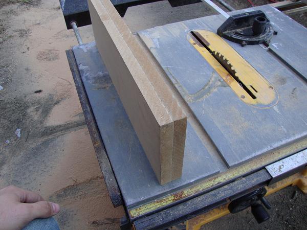

Gold Member Username: TejcurrentPost Number: 2149 Registered: Apr-07 | This is going in my cousins '96 Buick Regal. Everything so far has been ordered from Vertex Audio, great guy to deal with. Hopefully the subs will be in from IA this week. Shok Industries 1/0 2 15" Incriminator Audio Lethal Injections Probably using my American Pro VS-1598 amp for now. 7ft net tuned to 36hz with 96 sq inches of port. Since very few have seen this amp I'll give some specs- it's 500rmsx2 @ 2 ohms at .05thd, class a/b. I used it for my type-rs 5 years or so ago and it worked good, after he gets cash for more power I'll probably try it on some mids or something. On to pics The amp ![]() Cutting wood, since my table saw was stolen I'm using this one- God it cuts nice regardless of appearances. ![]() ![]() ![]() ![]() ![]() Mock up of the port, 6x16 ![]() Assembling the bottom/back. ![]() Port ![]() ![]() ![]() ![]() 3/4 round over ![]() ![]() ![]() Back to assembling the box ![]() ![]() ![]() Some wood filler ![]() Sanded smooth ![]() ![]() We need to cut the baffle and countersink the subs, paint, angle and resin the corners etc etc. Also have to run wire, cut up the trunk, build a hinge for the rear seat, and tons more. |

Platinum Member Username: InsearchofbassYork, Pennsylvania Post Number: 13673 Registered: Jun-04 | I have been into audio a long time and I never heard of that amp. I hope the setup slams for you. |
Gold Member Username: TejcurrentPost Number: 2158 Registered: Apr-07 | Yeah I found it in a pawn shop like 8 years ago, it's really not a bad amp imo. I hope it does good for my cousin anyway. |

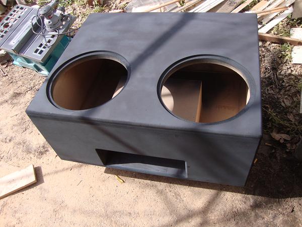

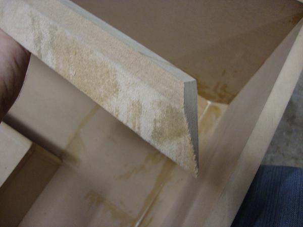

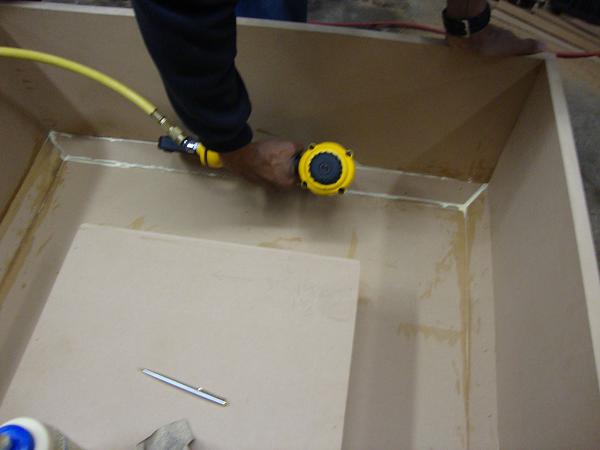

Gold Member Username: TejcurrentPost Number: 2159 Registered: Apr-07 | Did some 45s and painting today. These pics show too much of my ghetto shed ![]() The budget for paint ate into the fiberglass budget too much, so this box will not have resin inside. A bunch of 45's cut. I didn't mean to take the pics in front of my old 4 18s box. Anyone wanting it can have it for 20 bucks + shipping, or a couple packs of redbull locally. It has like 200 bucks just in fiberglass and paint in it. ![]() ![]() ![]() Working extra HARD (ha ha) ![]() ![]() My brother putting in some nails till the corners set ![]() ![]() We got more than this done, but I don't have more pics. We're going to get the baffle on tomorrow and get it painted. |

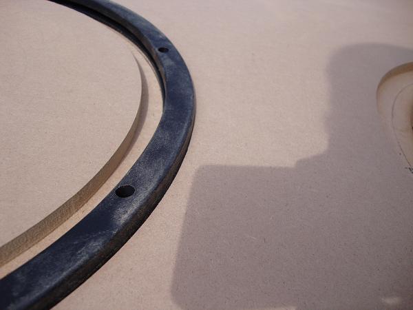

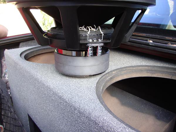

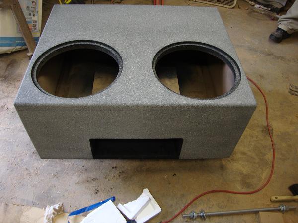

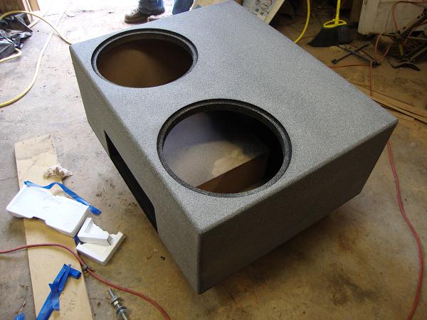

Gold Member Username: TejcurrentPost Number: 2161 Registered: Apr-07 | Thanks. The box is finished, just letting it dry over night and should get the metal chopped out tomorrow. I cut the baffle before putting it on the box to reduce dust cleanup. Only countersunk like .5 inch, so it's not quite flush. Just liked the way this looked so I kept it. ![]() ![]() ![]() ![]() First layer of baffle ![]() Clamped and nailed ![]() Wood filler ![]() Sanding ![]() Test fitting ![]() ![]() Roundover on the whole box, as well as hitting the bottom of the port opening. ![]() I believe he felt that his box had balls ![]() 4 cans of black filler primer, then 2 cans of valspar stone. I think 1 more can of stone would've been better but that was the budget. ![]() ![]() ![]() ![]() ![]() ![]() I sanded the overspray out of the sub holes, should be dry and ready to go in tomorrow. I'm going to run the subwoofer wiring straight from the subs to the amp, no terminals. Let me know what you think. |

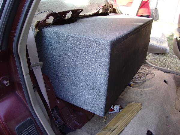

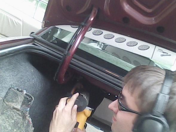

Gold Member Username: TejcurrentPost Number: 2162 Registered: Apr-07 | The box is in, just need to hook up the wires/run the wires. I was too busy doing the work to take lots of pics. Tight fit. ![]() cutting the trunk lid spring/rod thing ![]() ![]() And chopping out the lower corner bracing. ![]() ![]() ![]() ![]() ![]() |
Silver Member Username: Gcs8Atlanta, Ga Post Number: 282 Registered: Sep-09 | i think you made the box to big lol |
Gold Member Username: TejcurrentPost Number: 2163 Registered: Apr-07 | I made it exact lol. I thought we were removing the spring, but since we could keep it we did. It made some ugly marks that need touched up but this is great: even before bolting it down you'd have to remove the rear seat to get the box out, or slide it enough to reach the subs (we just have the box positioned there for a pic). It is such a tight fit it takes 2 grown men several minutes to move it a few inches. I'm really happy with how it fits, though it took a 2x4 and almost an hour to shoe-horn in lol. |
Gold Member Username: Dustin3Box Designer & Builder...Dustin Post Number: 5424 Registered: Oct-05 | Nice work. Where did you get the Valspar? and how much was it per can? How is the durability of it? |
Gold Member Username: Dustin3Box Designer & Builder...Dustin Post Number: 5425 Registered: Oct-05 | It prob scratches pretty easily huh? |
Silver Member Username: Gcs8Atlanta, Ga Post Number: 283 Registered: Sep-09 | pix of it flush with rear seats in? |

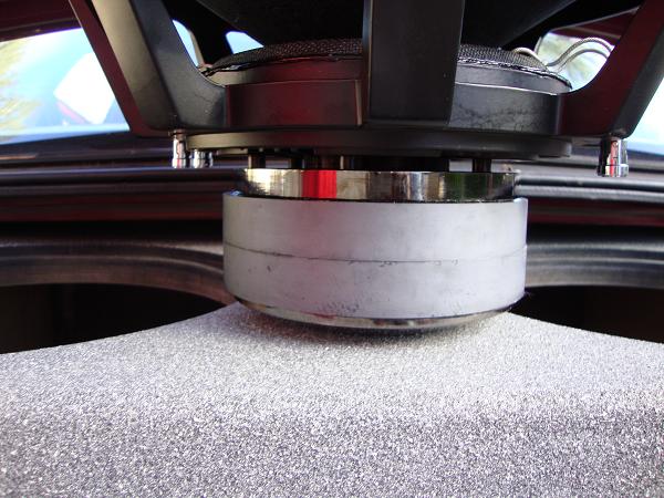

Gold Member Username: TejcurrentPost Number: 2164 Registered: Apr-07 | The valspar stuff was at Lowes for $8.98 per can- but two can's did pretty good covering the sides, port side, and baffle. I did almost the whole box with one can then recoated and finished with the second. It's been humid so I think it could've sat a bit longer, but those scratches would've ruined even carpet, they're kind of nasty. I sanded the overspray from the sub opening and it took some work, it's rubbery so it doesn't really chip like I expected. I'd definitely use this spray again, though this was the darkest color I could find. I was thinking about using it on my box then hitting it with a flat black mist to make it have a darker tint to it. We didn't get the subs in today- he has to vacuum his car and the box out first, then we can wire and mount the subs. After that we'll push it in place and put the seat back. The amp will go in the space between the box and the seats in some fashion. |
Gold Member Username: Dustin3Box Designer & Builder...Dustin Post Number: 5429 Registered: Oct-05 | interesting. I am thinking about trying some of that stuff. Can you chip it off with your fingers and stuff? Because I know of some other spray texture at HD and it chips very easily. |
Gold Member Username: TejcurrentPost Number: 2165 Registered: Apr-07 | I haven't tried to chip it, but I hand sanded the sub holes and it sanded well. It was definitely rubbery and held up to 80 grit decently, but I'll try to chip it with my finger the next time I see my cousin. We were going to run the wire and hook things up today but it didn't pan out. I hope to get it running tomorrow, only like an hours worth of work left. |

Gold Member Username: TejcurrentPost Number: 2168 Registered: Apr-07 | I tried and the stuff does chip ![]() I'm pleased with the sound and output of this setup- honestly the sound surprised me. It sounds smooth and accurate, I LOVE the way it sounds on rock like Devildriver. I didn't expect the small bag trick we got, but this was all we could get a video of before it looked like neighbors were getting angry. http://www.youtube.com/watch?v=9gqDD1Hp7a4 |
