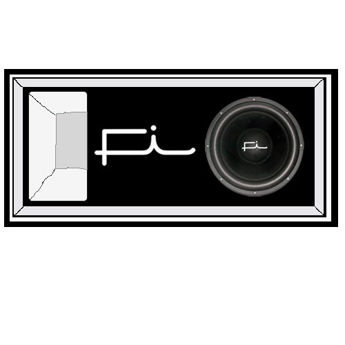

Username: Cod1989
Allen Park, MI USA
Post Number: 30
Registered: Jun-09
Ok then I will use mdf. It would save me much money.
But here is a rough design of what I want mine to look like, although I won't have money for awhile this is what I want;
The outer casing would be painted black and extend an inch or so from the face so there is an overhang. inside of that would be a wooden insert painted white that fills the depth of the overhang. behind that would be the actual face of the enclosure, painted black. If your looking at the face of the enclosure the sub cutout would go on the right and the port would go on the left, I would want the inside of the port painted white and inbetween the port and the sub I would like the Fi logo lettering like how it is on the example.
But yeep thats what I want done with the same stuff as my other post accept I dont have to have birch he just said its lighter and stronger. I'm not going to have money for this for awhile but I'll for sure be doing it sooner or later through one of you. :-)

Username: Dustin3
Box Designer & Builder...Dustin
Post Number: 5341
hmm, FI logo might be tough. I believe AMI has a hook up with a CNC who engraves it for him..
Username: Dustin3
Post Number: 5342
I could try playing around with some stuff and see how it would come out.
