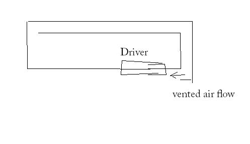

would it be bad to have the vent pushing the air out right over the top of the driver? Upload

An thanks Adam. Do you know anything about my other question about the port blowing over the driver?

i wouldnt do it sean...

the tline route is good, if you decide to go ported have the bend on the inside of the box, not the outside. does that make sense?
