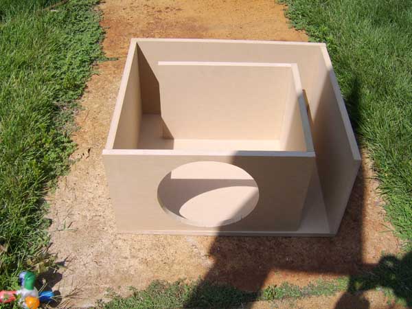

New member Username: RboudreauWeymouth, Ma United States Post Number: 2 Registered: Nov-09 | hey guys sorry im new on the forums ..... Let me be a bit more specific. I have 2 DVC 4Ohm type R's with a Rockford P1000 rated at 1614@ 1 OHM. I wana build a custom ported box but do not have the true knowledge on how to calculate it. I am hoping i could get some Specs/Dimensions for a box similar to this design shown below. Again i would really appreciate any help i could get at this point as i want to start ASAP } |

Gold Member Username: Hittin1TEAM REVOLUTION, La. Lake Charles... Post Number: 4084 Registered: May-07 | Without knowing what max dimentions are and assuming they are 12" subs this is the best I can do... Got this design from CA.com. Moe Lester posted a bunch of free plans on there. Hope it works out for you. |
Gold Member Username: Hittin1TEAM REVOLUTION, La. Lake Charles... Post Number: 4085 Registered: May-07 | http://img35.imageshack.us/my.php?image=44cubes32hz66sqin7et.png link to original and larger design. 4.4^3 ft. 32hz |
New member Username: RboudreauWeymouth, Ma United States Post Number: 3 Registered: Nov-09 | they are 12''s but i want deep low bass ive seen people say 2 cubic ft and now 4.4 idk whats beter? |
Gold Member Username: Dustin3D&L Audio Tech.Dustin Post Number: 5163 Registered: Oct-05 | they probably meant 2 cuft per sub. |
Gold Member Username: Hittin1TEAM REVOLUTION, La. Lake Charles... Post Number: 4089 Registered: May-07 | 2-2.25^3ft / sub will be fine. If that box design will fit in your ride, it will do the job..Will definitely be louder than your sealed box. |
Gold Member Username: Drant19DUB-C, TX Post Number: 2131 Registered: Aug-07 | Rovin has done MANY boxes for type-rs.. he always recommends 4-4.5 cubes @ 32-35Hz. if you want low bass then tune to 32 Hz. im not sure if they will like lower tuning, but hey try it n see if it fits your tastes! Trial n Error works |
Platinum Member Username: Rovin1 15 = 152.5 DBs ...Trinidad & T... Post Number: 15614 Registered: Jul-05 | ^yes thats pretty good 12-16sq" of port \ cuft tuned 33hz & ur good to go ... |
