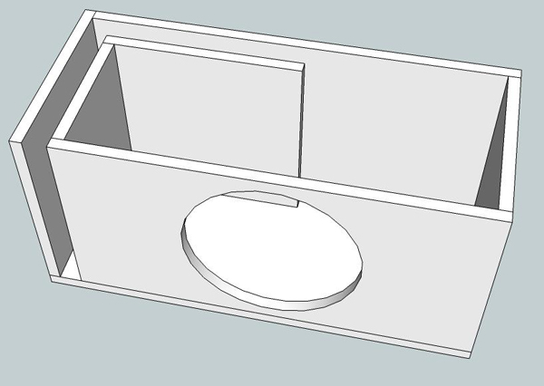

i jus got one rd sonance 12. i want to build a ported box for it. i dont kno the recommended enclouse for it, but thought mark or someone would have a couple ideas. my trunks pretty small so it cant be taller than 15", any deeper than 18" and width prolly wont be a problem for a single sub enclosure. but throw it in there anyways cant be wider than 37". id like it tuned to like 32 hz or so. unless itll do better tuned a lil higher or lower.

I have 2 15" RD Sonance, very nice subs. The 15's are in 3cu^ft @ 32Hz with 60sq^in port face each. Sound Great. Maybe try a 1.8cu @ 32 or 35hz. Should sound good.

yea i was thinking like 1.75 cu ft or so. i dont really kno how to figure it. could someone shoot me some dimensions.

I'll draw up a box and send you the dim's
Username: Boomtank
Rochester, NY USA
Post Number: 672
Cut Sheet
Top 12.5 x 28in
Bottom 12.5 x 28in
Left 12.5 x 12.5in
Back 27.25 x 12.5in
Right 11 x 12.5in
Front 25.75 x 12.5in
Port 1 8.75 x 12.5in
Port 2 12.75 x 12.5in
1.75 cu^ft tuned to 32 hz

jus sent u a email, but this works. thanks man
