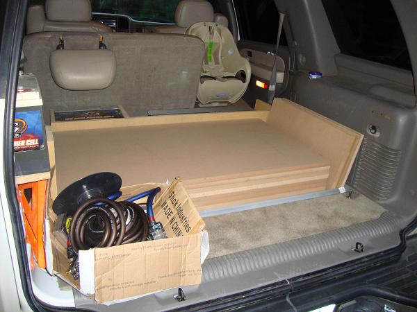

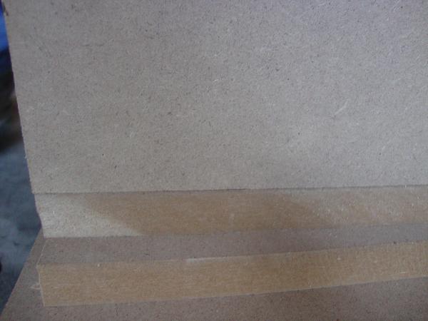

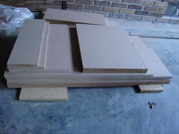

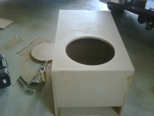

Gold Member Username: TejcurrentPost Number: 1957 Registered: Apr-07 | I finally started rebuilding after a year without bass. Downgrade to 2 BTL 18s and an AB 1000.1. Using realm 6.5 components and an eclipse 4ch amp, but considering 3-way active. Only going to run 4 d3100s for now, but will have plenty of alt power. I'll see how it does, if voltage dips much I'll add more, I'd just rather test since I just lost my job and found out I've got another baby on the way. For now I have a dual alt system with MLA module, ~300 @ idle. Soon to be quite a bit more (around 700) I'm running 10 runs of 1/0, some Shok, other Knu Fleks. On to pics- todays work: Built battery rack on side, built amp rack, just need to make the cover for the top and carpet everything. Then I picked up the wood, I have to make the finish cuts tomorrow but letting the store rip the large sheets makes table saw work much quicker. The goal of this system is space while doing 150+ @30hz. I have a kid and one on the way and really need at least half of my vehicle to haul baby crap and tools. The amp rack is built to have a cover making it take up about 1.5 sqft. The batts on the drivers side will be covered, just leaving it open while building. I can't go too fancy because it'll just get messed up. The box is ~10ft net with about 115sq inches of port. Any thoughts/criticism welcome, cutting and assembling tomorrow so I'll have a LOT more pics then. A lot of things will be changing now that I have more time to do work. |
Gold Member Username: Basebalz13Moneta, Va Usa Post Number: 1835 Registered: Aug-07 | finally you wanna get another 1000.1? i have 2 500.1's for sale :D |
Gold Member Username: TejcurrentPost Number: 1958 Registered: Apr-07 | I can't tell you how bad I want another 1000.1 I would rather have 4 500.1s, but that's just not realistic at the moment. ![]() |

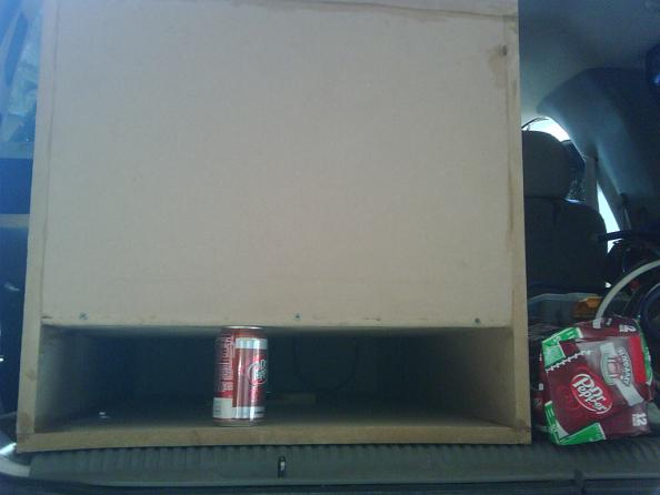

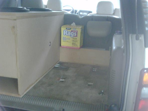

Gold Member Username: TejcurrentPost Number: 1965 Registered: Apr-07 | I didn't get much done today, only had an hour or so, but tomorrow the fun starts. I have a friend who should be getting me some 1/2" copper buss bars, but till then I decided not to use fuse holders, just 1/4" aluminum buss bars. The amp needs 800-1000 amps of fusing depending on who you talk to and where you're reading, I have 250s and 200s so I'm debating what to use. I never thought I'd get to use my 12" miter saw that works good on masonry and metal, it was like Christmas to get to use it for once lol. 2 bars cut to fit Mocked up to figure out where to drill things. The aluminum bars over the amp aren't screwed in place, so things look crooked but it's straight now. They're just extra security, whatever it's worth. Almost how I want it, it's temporary till the copper comes in. The fuse holders were really just plastic with a bolt to hold wire and fuse together, so this has about 100x more metal regardless. I have gotten my moneys worth out of this saw. Cut everything so tomorrow all I have to do is assemble. I used a circular saw for the last box, honestly I will never again if I don't have to, it's just so much faster to use the table saw. And perfect cuts every time is nice too. Assembly tomorrow, I can't even hook things up till the rest of my wire comes in so I might be driving around with subs and amp just not even fully hooked up |
Gold Member Username: BonhamdTraverse City, MI Post Number: 1959 Registered: Nov-07 | geez troy - i always like your builds...looks great man keep us posted |
Gold Member Username: DeadrabitMarionville, MO Post Number: 2147 Registered: Jun-07 | nice taBLe saw |
Gold Member Username: Basebalz13Moneta, Va Usa Post Number: 1839 Registered: Aug-07 | troy, do you have dual alts installed yet? |
Gold Member Username: TejcurrentPost Number: 1966 Registered: Apr-07 | I've been running them this last year, even without a system lol. I know the batts/alts will hold 4-5kw because I could run at idle with a mcd-4kw and 3 batts and not drop below 14. I figure with one more battery I should be good to give each 2500w until I throw on another alternator or two and really get to crank things up. I know I need more batteries but I'm not willing to give up any space I don't have to. I'll probably be ordering my alt(s) in another 2-3 weeks, but I have a lot of other stuff to keep me working on things in the mean time. |

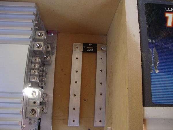

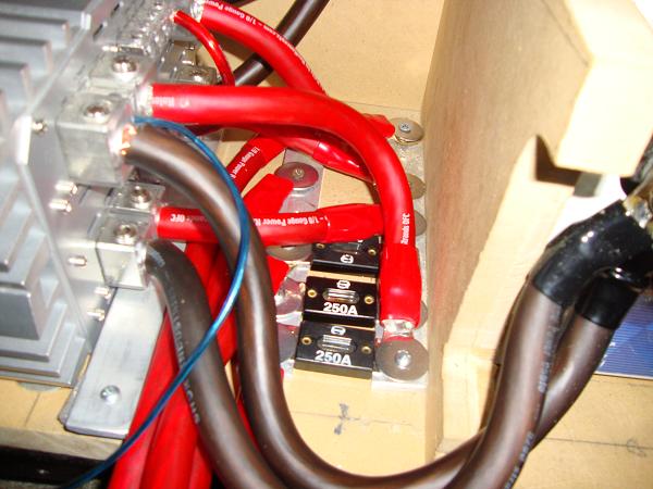

Gold Member Username: TejcurrentPost Number: 1975 Registered: Apr-07 | Cut the ground runs from the amp to the battery. Shok industries 1/0. Seems like rf or kicker flex. 5200 strand count. I'll upload some comparison pics but it's pretty much like any other decent 1/0- I just really like the black. Got the terminals in today. I used to run a bolt for every wire input so I can change the wiring from outside the box, but honestly that's not really an option here - just 2 ohms. Slapped the fuses in place. Can't wait to get copper, should make it look a bit nicer. I was going to run some temporary wire just to get things going till my red knu comes in, but the old stinger stuff I have just isn't flexible enough, and I can't see wasting ring terminals just for a week or so. Just posted this pic because of all those who bched about the tinsels on their original BTLs. This sub was bought in October of '06, played on a 2000w hifonics amp for a few months till I bought memphis 4kws and ran like that for 2 years. There's barely any wear visible at all. Tinsel slap my azz. Now watch me f it up lol. Wiring the subs up tomorrow, probably running my grounds too. |
Gold Member Username: Basebalz13Moneta, Va Usa Post Number: 1851 Registered: Aug-07 | nice get to work |
Silver Member Username: M0nstarToledo, OH U.S. Post Number: 368 Registered: Dec-08 | hey i know since your running 10 strands of 1/0 wire this may not be the easiest thing to do, but I have pretty much the same setup as youu, i have my amp rack about 2 inches off the floor of the car, and i ran all the power/ ground/ speaker wires/ RCAs all the way under the carpet then through the bottom of it, so there are no wires showing whatsoever. you may have thought of this already but i just thought id chip in my 2 cents to try to help |
Gold Member Username: TejcurrentPost Number: 1978 Registered: Apr-07 | Can you elaborate a bit more with what you mean? I have a few more runs to put in, but pretty much I just drilled a huge hole in the firewall and ran it all under the carpet on the drivers side. The RCAs and speaker wire is on the opposite side of the vehicle. Is this what you meant, because I'm always up for improvements. Thanks. |
Platinum Member Username: Rovin1 15 = 152.5 DBs ...Trinidad & T... Post Number: 15582 Registered: Jul-05 | looking good so far .... |
Gold Member Username: TejcurrentPost Number: 1979 Registered: Apr-07 | Wired the subs up yesterday. Each sub in series then parallel @ 2 ohms final load. All I need is power wire and it's ready to test. I have a feeling I'll be rebuilding again soon, which is why I spent so little effort making things look nice. It is really time consuming to tighten that nut 1/4 turn at a time. There just isn't enough room to fit anything else in there lol. Plenty of room left for baby stuff. We went pumpkin shopping yesterday and bought several while hauling all kinds of other stuff. ![]() |

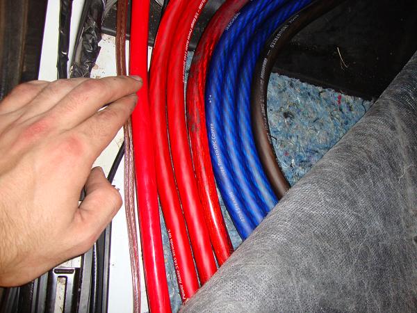

Gold Member Username: TejcurrentPost Number: 1997 Registered: Apr-07 | I got 8 runs of wire through the firewall before I ran out of space today. I don't feel like cutting more holes or a bigger hole, and honestly even if I was pulling 1200a from the front I'd be good so I'm just leaving it. Also 2 runs + battery wiring is almost 40 ft somehow. It's running, but here's the deal: I don't have enough terminals to run more than 1 run of wire from the front, so it's going off of a single 250a fuse. I didn't let the voltage drop below 15v and it was a bit louder than I expected. Once I got on the highway it didn't drop below 15.3, really just stayed at 15.4 so I feel confident saying I was not pulling much power at all. Did a small hair trick so I'm hopeful. I only have 2 batteries in, with one fuse, and I'd say it's probably around 149db @ 42 (ear-o-meter) with 3000rms. I tried to take a vid but neighbors came out before I could really do one. I'll have pics tonight, vids tomorrow given the terminals come in. |
