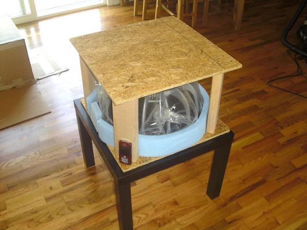

Got a big ol package
Username: Dlavante
D&L Designs, Daniel Tigard, Or, USA
Post Number: 202
after about 3 months of waiting i finally got this at my door

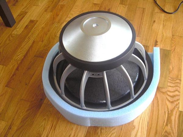

btl with a few changes to the motor and soft parts.. unfortunately its not going to be used for car audio

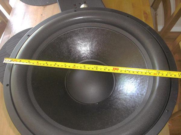

its going to be used for a pro audio application. its got a lighter stiffer cone, the suspension is stiffer and the motor is a little stronger. The fs should be right around 36hz and the efficiency should be somewhere around 96-97db 1w/1m, which is still on the low side for pro audio, but i think its still going to be able to hang with most high end pro subs.

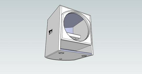

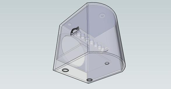

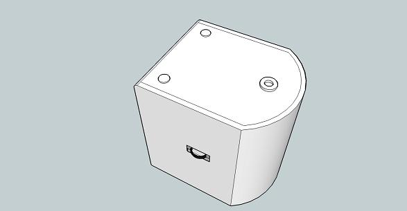

This is what the finished sub will most likely look like. There will be some changes to the bracing and were doing some testing this week to determine the final specs of the box. As of now the plan is for 7.5 cu ft at 36hz
