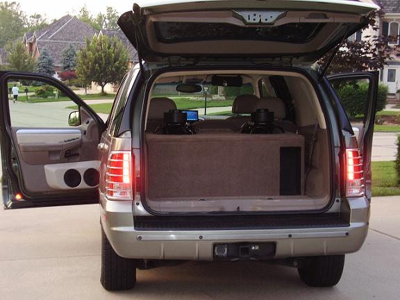

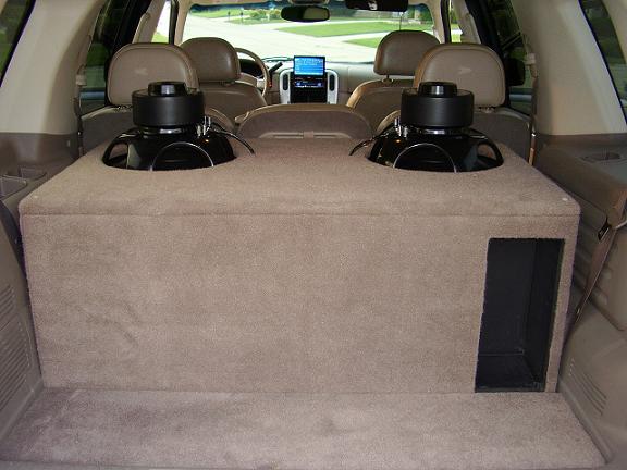

Gold Member Username: JakeyplaysbassSt. Louis, MO / ASU Post Number: 3667 Registered: Jul-05 | Ok if you already have the subs you can do it.You have several options on what box you want to run. 1. If you want to run all 8 subs in a box that will be about the size of 4 subs you can do a iso clamshell box. You will lose a few dBs from a normal box with 8 12s but it will improve the low end and save you a tun of box space. Heres the 4 15" box did in my mountaineer a few years back... It was like 5.5-6cuft net if i remember correctly. 2. You can wall the box and something similar to what Kenny C. did if you want the SPL numbers. https://www.ecoustics.com/electronics/forum/car-audio/579340.html If your looking for something different than both of these let me know, I cant get on AIM right now i'm at work. |
