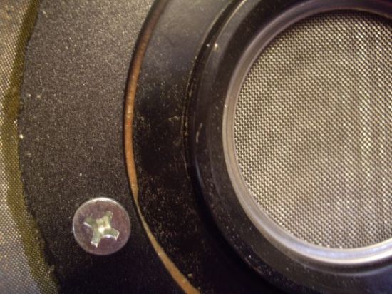

I bought a blown Rockford Fosgate Punch HX2 from a guy on CA.com that I was going to use as my first recone project. All that he said was wrong with it was a blown coil. The sub got here today and it sounded like the coil was scraping, so I tested the coils with the DMM and they tested fine. I ripped the cone off and noticed that the pole piece was completely off whack. One side is touching the top plate.
I don't see how the magnet shifted that much and didn't come loose. Is there any way to get the motor off and realign it, or should I buy a different motor and start from there?

my buddie had something like that happen. he put a pipe in it and let it set for a long time.. he did something else to but id ont' remember. it straightened out but it was never the same as it was before

im guessing the guy dropped his box hard & that caused the motor to shift
if u can get it back to original those r some damn sweet low bass subs ...
