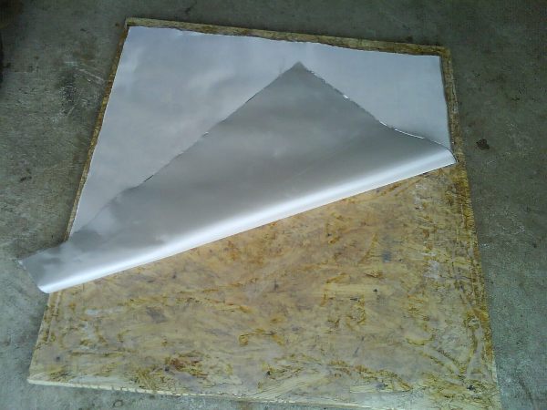

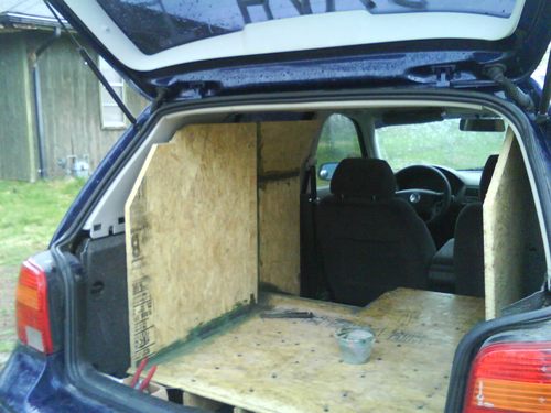

i havn't had a lot of time to work on it sense i got back but i have got some stuff done.
Username: Big_edge_head
Milwaukee, WI
Post Number: 3727
Looks good. Keep us updated.

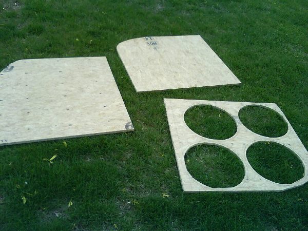

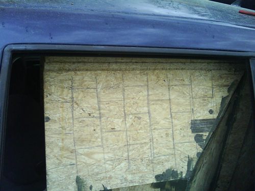

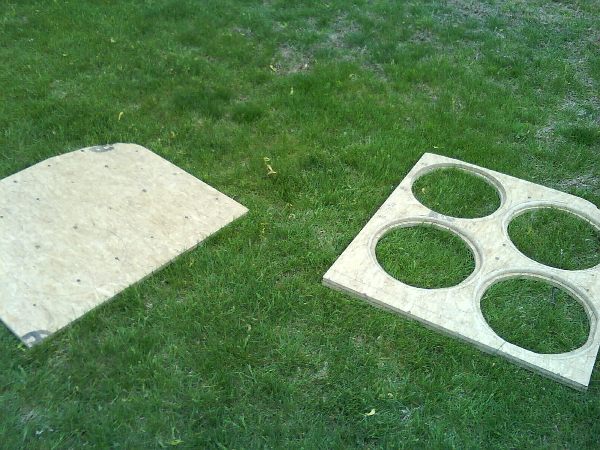

i got a lot of braces done today but the rain made me stop
Username: Kickittothacurb
Post Number: 60
Registered: Mar-09
omg that looks like a studio apt is going in back there, very cool though,

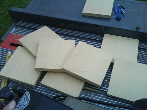

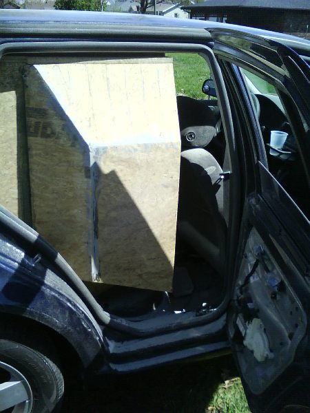

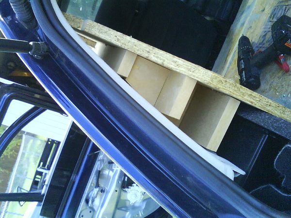

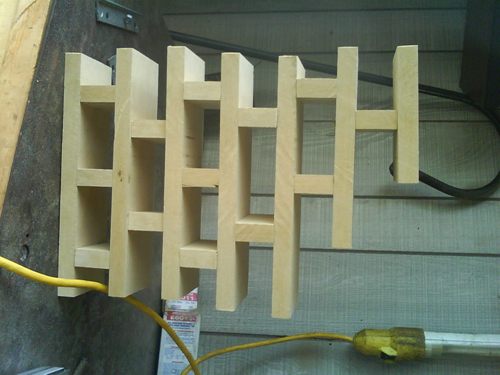

this is some of the external braces i made today. they are not on yet. so im sure some of u wont see what i am doing with them.
i was going to try and make it with the door panels on but i had already taken off the handles because the box was touching the sides so ill have to put the panels some place in storage so i can make the other braces fit.

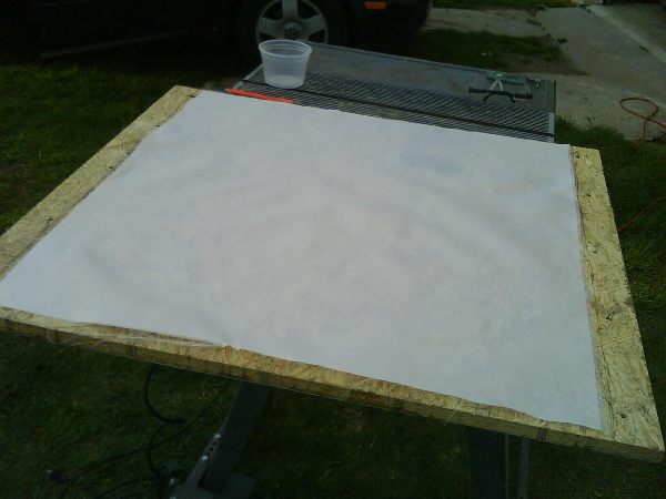

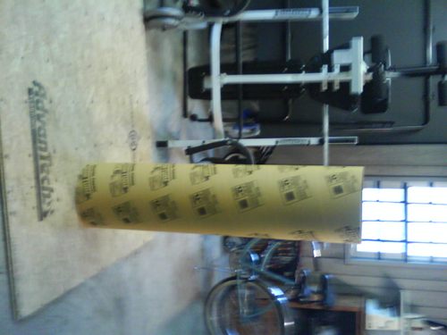

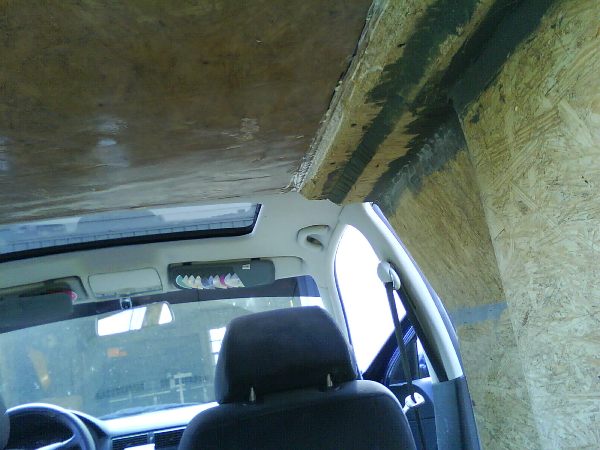

got some work done tonight. should get more done tomo pix!
Username: Deadrabit
Marionville, MO
Post Number: 1512

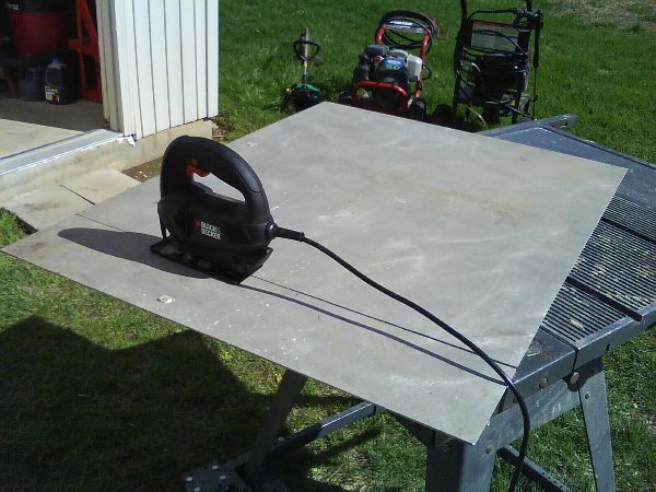

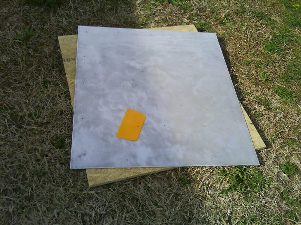

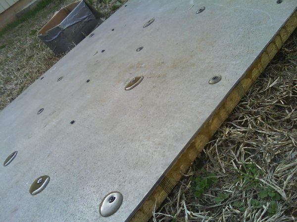

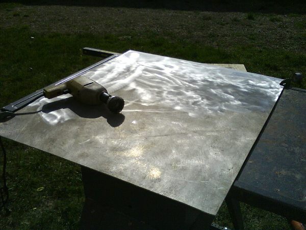

i will say that sheet of advantech with that aluminum is STRONG! i can't really see it flexing and it might be over kill but i am going to put 3 sheets of 4 oz cloth fiberglass just to be sure. i have to make this part strong because it is on the roof and i don't have room to make any external braces

It is looking alright for a second attempt. There could be a few things done different.
I see around a 154-155 in it.

nick v what would have u done different? i am making changes as i go on this so if i see somethig i think i could change to help ill do it

I would have made the external bracing different. Also the design itself looks a little strange. Make sure you get alot of threaded rod for bracing the inside.

i have only made one external brace. how would u have done it?
if u have a better way ill do that

i would have used 1in threaded rod or built a steel cage for the enclosure. if it was an option. but threaded rod is imo the best way to brace a box. i use 1in. i dunno how it would do in your application, as i dunno whats really going on here yet. and also internal angles can play a big part into what your ride will do. and also deading and sealing up the doors and roof may help as well

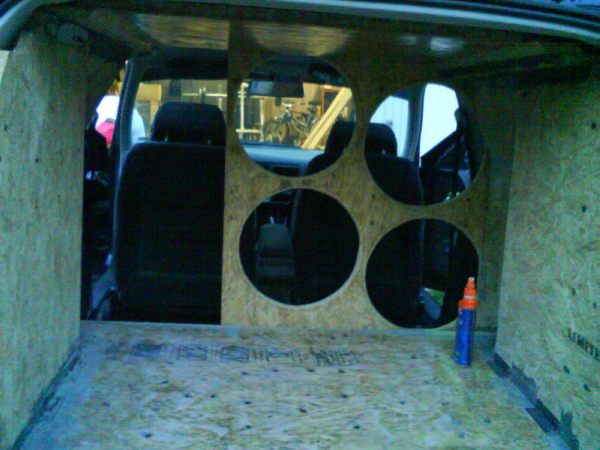

the fiberglass is drying and im putting on braces! yay! thanks Rick's Car Audio for letting me us that big grinder!

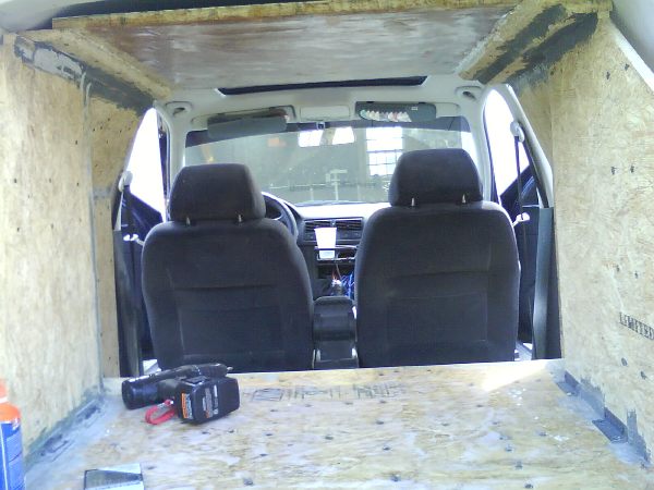

got all the fiberglass over the top panel today! yay! 3 layers with the 4 oz.

cement board would be awsome! but that with braces would have to much weight. i am kinda over doing it on weight how it is, i do drive this car every day

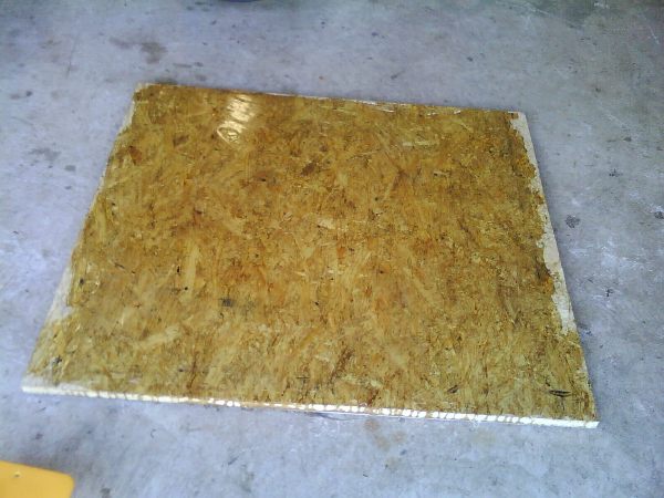

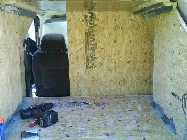

these pix kinda suck. i got braces almsot done.. but i didn't take pix of it. i got everything grinded and sanded smooth. it looks like it snowed in my car. and driving in it SUCKS!

it now has a roof! and the braces are coming a long slowly but i might have then done by today. its time to work on the front now!

wtf - those braces look like a ton of work
wouldnt 2x4s or 1x2 RHS steel be easier to do ...
Username: Deadrabit
Marionville, MO
Post Number: 1539
every one says the braces look like a lot of work. but its not to bad. i used 2X4s on some places but these have to be like 1/4 inch thiner. plus i think this looks cool. and i don't want to buy any more wood. hahaha. its like my box was attacted by bees

have you seen other cars that are doing 160+? and looked at what they did as far as making a unibox/car? Or are you just winging it?
Three cars that Ive seen that are 165+ have very diffrent box builds. But GL.
Also, you may want to put aside a few bucks for suspension upgrades.
Is that a single layer of ply? with bracing? You will need at least 3 layers to get the stiffness thats needed imo.
theres a car that does 160+ and he has many sheets of that stuff in his car

btw, i dont even think alan dante hit 160 with at least the amount of power u got... im sorry man just dont want you to be let down when u dont hit 160
Username: Deadrabit
Marionville, MO
Post Number: 1543
i am getting help from 2 guys. one has done a few walls. i know he got a 166 in hte late 90s in a chevy love (more power than what i have) and he did a van but idk what he hit.
its single layer advantech in many places. 4 layers on the front baffel. all will have fiberglass 4 oz over it at least one layer. and every place will have braces
a lot of people say i need thicker wood, but if the peices i have do not resonate at a low Hz then i have nothing to worry about. the only part i am worrying about now is the top. i think its the strongest but i also think it has the lowest resonance.
from the guys i that have seen my build they say it is strong enough. one of them says some places is overkill. i will still have a lot of internal bracing so don't freak out yet!
i really do not think any of my fiberglassing or braces are over kill. i think a metal cage would be awsome. but then again its a DD. ..
the 152 i was not an spl port. it was 40 or 38 Hz for daily. i hope i am not hurting anything by having the port over to the side other than front but i was told it works better in most cases that way.
and the guy that told me some of my braces were over kill??? u can't say he doesn't know anything or that he is stupid. he has built many boxes in the 150s that are only single layer mdf.
i don't mean to say anything bad about uguys but some of u i dont know. so some of u might not know anything. others on this forum prolly know a lot more than me. but the guys i have been getting tips from i know for sure have there facts straight

LOL^ bro, im prolly the 2nd or 3rd loudest on this forum, thats a 157.6 at the headrest... thats 2 sundown nightshade 18's makes ur subs look puny. 4 AB500.1's thats over 20k on a 14 volt system you have 4 "regular" subs on 4,000 total and gonna beat my score? we are just trying to help you man... your wall is very "typical" for a wall... i forsee(spelling) box flex which hurts ur TL score... btw that 166 if more than likely on the AC mic which means nothing...

Username: Tatonka
-[Team Audible Insanity]-
Post Number: 2903
Only a double baffle for 4 15s? You're kidding me right?
Username: Hittin1
TEAM REVOLUTIONLake Charles...
Post Number: 3044
lol.. my 10 year old?
on a side note... anytime anything has came up about your girlfriend... I was one of the only peeps to say anything nice about her. and she is a cutie. she reminds me of a girl i dated in high school.
Username: Deadrabit
Marionville, MO
Post Number: 1561
no nick. its going to be 4 layers AT LEAST and some more fiberglass
the 2 layers i have now don't seem to me very strong
