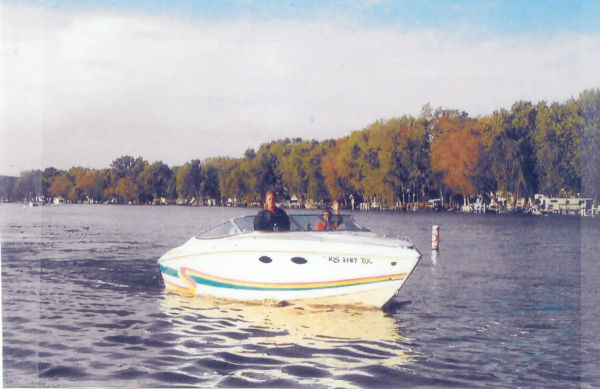

This will be going in a 1996 26' Baja Powerboat ($85,000+ msrp in 1996 w/ options/ 575 cu. in. Merlin Inboard (dressed out) 650+ H.P.)

This boat is easily a 100+ MPH boat but I told him that I would taze him if he tries it with me in there. I've done 80+ in my old ski boat, but that was before I had kids and I would like to see them grow up before I die. I'm an old gear head who used to do some bracket racing (9.90) in my old hot rods but that was not on water, lol

that is sex... the boat :-)

thats funny, today is my birthday too. nice boat.
