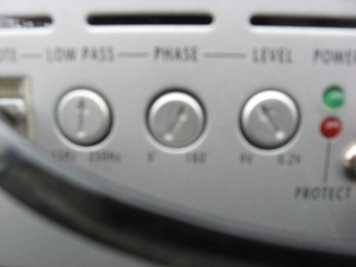

Silver Member Username: WaresgaragestereoFort Valley, GA Post Number: 347 Registered: Mar-08 | ur using speaker level inputs? not rc jacks? is that gain level turned up all the way? if so turn it down to about half way and try it. do ur radio go off at high volumes too or just the amp? i need those last two pics again but not so blurry if u could. those will help the most but i need to be able to read whats on the amp. |

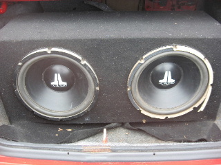

Silver Member Username: WaresgaragestereoFort Valley, GA Post Number: 348 Registered: Mar-08 | take pics of the subs plz. sean i have this set up where it emails me new posts. they sent me the email for this thread and theres stuff in the email thats supposed to be on ut last post and its not. idk. W/O knowing the specifics on the subs it's running, and how they're wired it's about impossible to speculate on what's causing the shut down." |

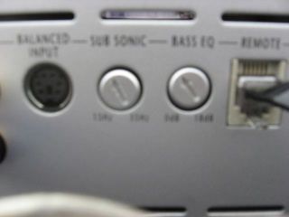

New member Username: Nina08Post Number: 8 Registered: Sep-08 | i dont know what rc jacks compared to speaker level inputs? And when it shuts down i still have music in the car just no subs. will have new pics for you this evening |
New member Username: Nina08Post Number: 9 Registered: Sep-08 | Are these any better? Can take more if needed ![]() |

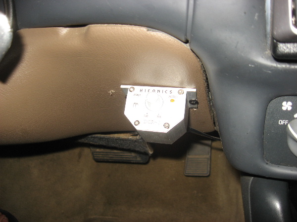

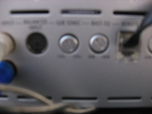

Silver Member Username: WaresgaragestereoFort Valley, GA Post Number: 352 Registered: Mar-08 | hey whats that black wire thats plugged in go0ing to |
Bronze Member Username: Nina08Post Number: 11 Registered: Sep-08 | I assume it goes to the knob they installed by my steering wheel for my bass, to turn it up and down. Im not sure how old it is but i can ask the guy i got it from. probably no warranty |
Bronze Member Username: Nina08Post Number: 12 Registered: Sep-08 | ![]() |
Silver Member Username: WaresgaragestereoFort Valley, GA Post Number: 353 Registered: Mar-08 | ok so whats it set on turn it all the way down and see what happens. |
Bronze Member Username: Nina08Post Number: 13 Registered: Sep-08 | i did and theres NO bass when its all the way down. 1/2 to 3/4 is about where i've had it now. |
Bronze Member Username: Nina08Post Number: 14 Registered: Sep-08 | No thats wrong, barely any bass but it doesnt cut out when i turn it up |
Silver Member Username: WaresgaragestereoFort Valley, GA Post Number: 354 Registered: Mar-08 | so with the knob turnd down it doesnt protect anymore? unplug the knob from the amp and try it then. |
Bronze Member Username: Nina08Post Number: 15 Registered: Sep-08 | so i unplugged it and it seems to take more before it protects, pretty much max volume. The power just isnt there like it was before. i think i blew my speakers cause theres distortion/ crackling? |
Bronze Member Username: Nina08Post Number: 16 Registered: Sep-08 | does a blown speaker still push bass? when you refer to the Gain, which one is that? |
Gold Member Username: Snowball123West Allis, WI United States Post Number: 1011 Registered: Oct-07 | yeah you shouldn't have the bass knob plugged in, usually clips the subs which is bad. Set your gains correctly with a 50 hz tone and a DMM. |
Gold Member Username: JuliobSanto DomingoDominican Re... Post Number: 5476 Registered: Dec-05 | i think your gain is kinda high, did you install your stff with a DMM like sean said? IMO there's part of your voltage drops if not installed properly |
Bronze Member Username: Nina08Post Number: 17 Registered: Sep-08 | which one is gain? Dont know what gain is....And I dont know about the DMM i didnt install any of this. But probably not. Blown speakers...what do they sound like? |
Silver Member Username: WaresgaragestereoFort Valley, GA Post Number: 355 Registered: Mar-08 | the level is the gain it just says level. i think the thing mounted to the dash is caled a bass knob. sean, expound on the whole DMM thing plz. Mina, its a bussing or crackling sound? all the time or just when the volume is up? are the RCA jacks plugged in all the way? the nlue one and the white one. |

Bronze Member Username: Nina08Post Number: 18 Registered: Sep-08 | its more of a crackling pretty much all the time. and the white and blue are in all the way. gonna wait and see if this guy can come take a look today before i do anything else to it. |
Platinum Member Username: WingmanaliveA pic is worth 1000 posts!! Post Number: 18044 Registered: Jun-06 | "its more of a crackling pretty much all the time." Have you heard of "distortion"? If the amp isn't internally damaged then I believe you just have. How does the speaker move when you gently manually push on the cone with the stereo off? Does it move freely or are there scratchy noises? If there's noise then the driver has sustained damage. If you suspect either the amp or subs then try swapping both. Use a friend's sub and try playing it with your amp. LOW levels of course. |
Bronze Member Username: Nina08Post Number: 19 Registered: Sep-08 | pushed on them and no scratchy noise so i guess thats a good thing? |
Platinum Member Username: WingmanaliveA pic is worth 1000 posts!! Post Number: 18045 Registered: Jun-06 | Good thing for the subs. Now it's probably with the amp's settings or an internal malfunction. I would still try the amp and subs out with a friend's setup first. And the dial marked "level" is most likely your gain knob. It appears to be set less than 50%. |
