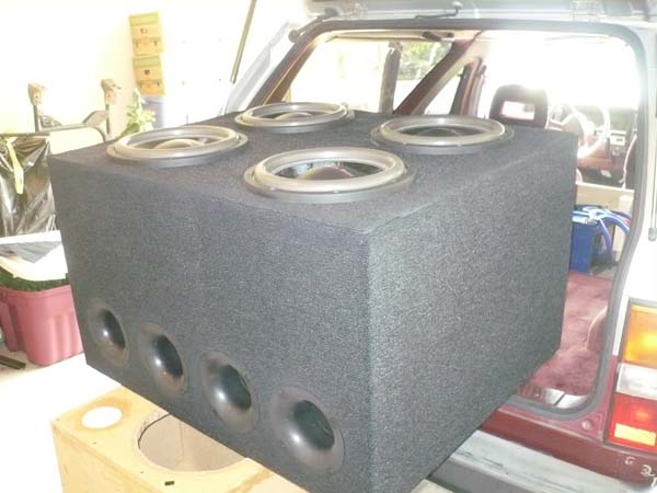

My car is up and running now with BASS!
Things left to do: Battery Bank Cover and CARPET EVERYTHING
Okay here is my build log with build pics over on CA if you are interested:
http://www.caraudio.com/forum/showthread.php?t=313660
On to finisht pics!

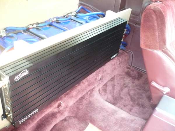

looks great driz - i really like the amp placement

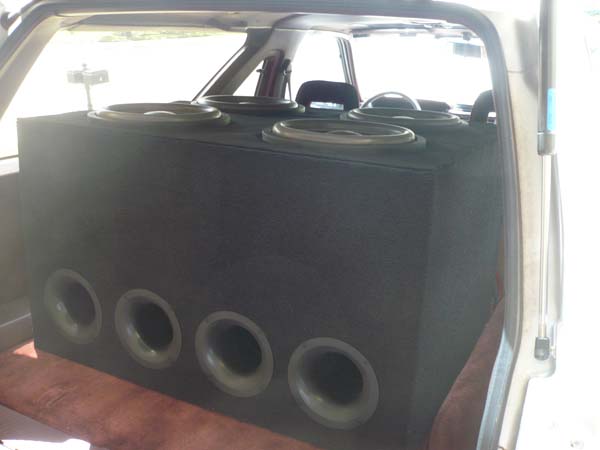

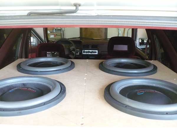

Excellent install. That system has got to slam. I assume you have the full 7 k going to them? Thats four inch aeros your using right? Also what is it tuned to?
Username: Andrew571
Post Number: 1955
Amp is running @ .5 ohm so 7K+ easily with my charging holding up so suprisingly well.
11 cube box @ 40 Hz
And yes they are 4" aeros.

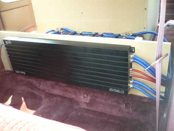

Nice. What kind of alt setup are you running? Those four inch aeros should work very well.

It does look surprisingly good. Who helped you Driz?

200 amp Iraggi.

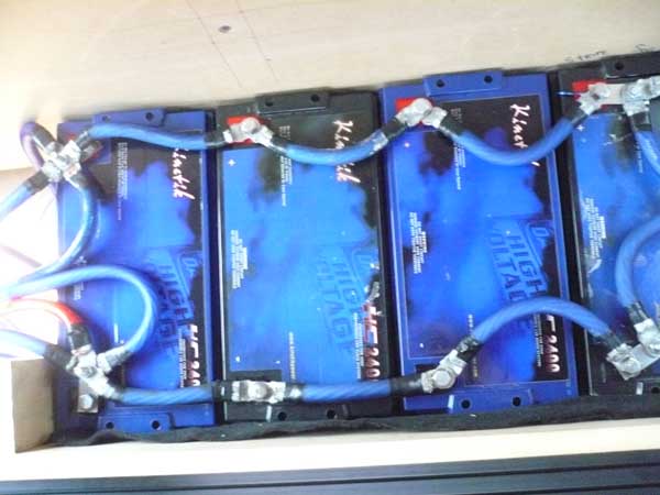

A 200 amp on all that power holding up. Just goes to show how much battery back up can help.
Username: Andrew571
Post Number: 1958
Yea. Least to say when I was peicing this together I was thinking voltage was going to be a major problem.
It has turned out to be the opposite. My voltage is excellent.

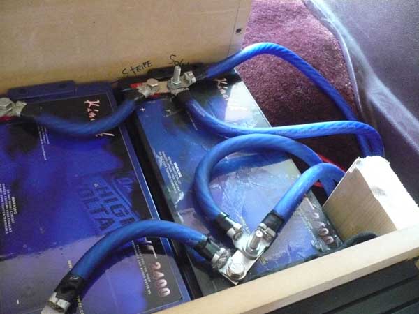

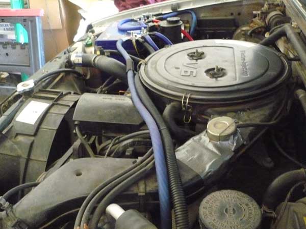

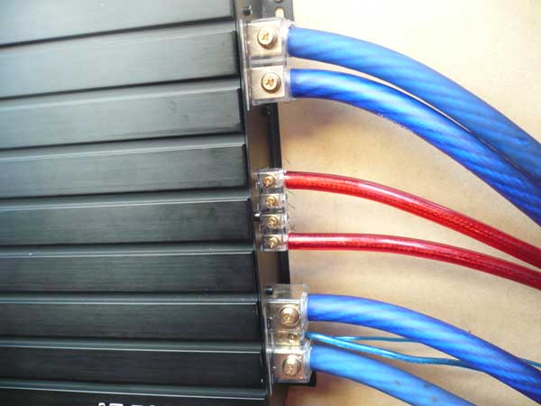

Zip tie the power wire that is dangerously close to the exhaust manifold.

Yea Zac I did. Shrink wrapped the wires close to the manifold and also ziptied them out of the way.

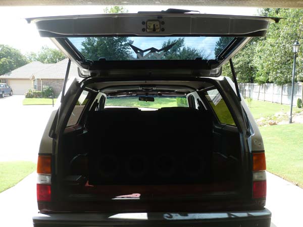

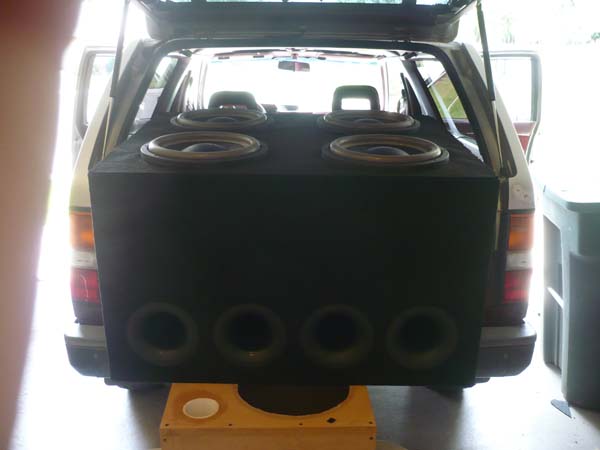

Okay I ordered carpet, but was under the impression it had no plastic backing... WRONG.
But I'm at the point I dont care, so I used it anyways.
It was a total b!tch to work with, but it came out alot better than I thought it would
I also went ahead and flat-blacked the aeros. It looks a ton nicer than I was expecting. I wanted to scream when I saw the carpet

Very sharp man! That's one big "boom box".
