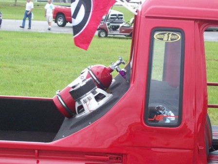

here is a cool truck idea. i took this pic at a show in Perry GA
Hummer H2
Username: Loudon
Post Number: 2645
ewwww
that truck is ugly as he11
why would u do that just a waste of time
the hummer is very clean install tho
