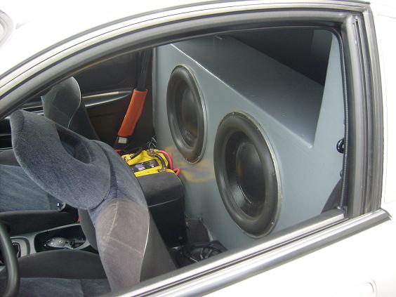

couple of pics from a Slap event.
that was my first run.
last run was a 139 even on a 53hz tone
Box is for sale, if anyone is interested.

nice looking box....and some nice looking setups here... if u made the box i give props on design..i like it..good luck with the sale

Yes, the box was my design, but Phil from Woodlawn did the math on it for me and I assembled it.

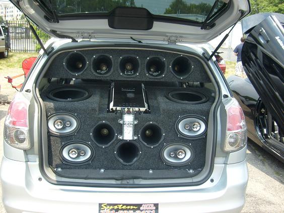

A pic is worth 1000 posts!!
Post Number: 17085
Good show Marc!

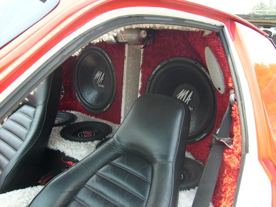

I'm not quite getting the 6X9's in that one rides' box though. Or the red fur with laptop lol.

that 6x9 trunk had like 11 selunium horns in it. and 4 lighting audio 6x9's.
It was very loud, but in a bad way.. and that red shag car was a porche, like a 911 or carreara or something. I seen it a while ago being built, and it looked like it was gonna be nice. Why he went with red shag? and with those 2 15's, and 4 10's he only hit a 138 or so.
So today I was in the process of putting my van back to normal, and i notice a terminal screw sitting on the floor under the amp. Well it looks like the Pos wire was just sitting against the terminal, thus the amp was shutting off when hitting hard. May have been due to the vibrations of it jumping when it hit.
Damm, i wish i would have seen that yesterday. I couldnt figure out why the box amp wasnt putting out. Voltage was good, I put it down to box being to small.

team renots .. he changed out the woofers in his integra ... worddd that thing was so loud

yes, those were the first 2 pics. And the cutlass won with a 160 somthing

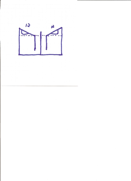

Well I feel ripped off, I drew an idea for a box on paper and posted it on here about three months ago. Someone told me it looked like a mad transformer. Now here you go building the thing and claiming the idea. That idea was patented and I demand the box or I will have to see you in court.

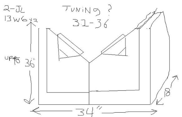

ahh, hey john jay, That design is called a pacman, or clamshell design. And if you came up with it, you have a lot of ppl to sue. So, did you build yours? how bout some drawings of yours for comparison.

Well, They are similar, but not the same.
Thats my sketch Phil from Woodlawn used to design from. Also, the middle port devider was an after install, due to build error. Also on AIM, Ive had many discussions with ppl on box designs, such as clam shell, t-line, ABC, Golden ratio.
