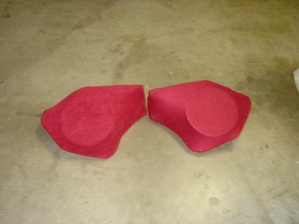

Platinum Member Username: BestmankindHttp://www.rdaudio.net... Post Number: 19305 Registered: Oct-05 | continued from https://www.ecoustics.com/electronics/forum/car-audio/459973.html alright got alot done today. so here it goes. pictures and descriptions. lol. first i laid out all the stuff i am going to be using. polyester fleece i bought from the fabric store. it works great with polyester resin. now i position the mdf ring in place using bars and hot glue gun. the hot glue gun works great in this situation. since the floor of the pod isn't perfect flat, the hot glue will ooze in to the gaps. now i wrap the fleece over the ring. i use spray glue on the backside of the pod and stick the fleece on it. then i pull it tight and spray glue on the other side to hold it in place. finally i mix up some resin and start applying to the fleece. i only apply up to the edges. i don't want to resin the back side. once it cures, i will cut the excess fabric out with a knife. i still need to sand it and apply some duraglass and body filler to make it as perfect as possible. alots of sanding to do. once that is all done, i will wrap it with black vinyl to match the rest of the door panel. stay tuned for part 3....... |

Gold Member Username: BernymacCambodia Post Number: 3774 Registered: Sep-04 | nice Chad, the shape does indeed look perfect. Your learning very well. How much did the fleece take up? did it take up more than 12oz of resin each pod? |
Platinum Member Username: BestmankindHttp://www.rdaudio.net... Post Number: 19308 Registered: Oct-05 | 12oz was perfect berny. i just went to the garage to check up on it and its already curing. still giving off heat so its not complete but its getting there. it is hard as a rock. lol. |
Gold Member Username: BernymacCambodia Post Number: 3775 Registered: Sep-04 | Freakin lucky . |
Platinum Member Username: BestmankindHttp://www.rdaudio.net... Post Number: 19310 Registered: Oct-05 | yeah. lol. i think i can mount it tomorow to see how it sounds. the imaging is going to be sick. then sunday i'll take it out and we'll apply some body filler and all that good stuff. pizza on me again man. lol. |

Gold Member Username: FrkkevinResonant Engineering..., Fort Worth... Email Post Number: 4752 Registered: Nov-05 | the only negative i have is you should have beveled the rings so you did not have a harsh edge.. looking good tho ![]() |
Gold Member Username: Th3pwn3rPost Number:... Post Number: 7279 Registered: Jul-06 | You always have something negative to say Kevin, haha. I remember what your kick pods looked like and nobody gave you sh1t ![]() |
Gold Member Username: FrkkevinResonant Engineering..., Fort Worth... Email Post Number: 4753 Registered: Nov-05 | the edges on my pods were rounded to make the edge smooth.. only thing i skipped on was sanding them completely so when the vinyl went on it looked kind of tacky.. was in a hurry to have them in for the show that weekend and well when you rush things they don't come out as well my pods were mediocre.. i half@ssed em and got what i put into them.. overall its a good learning experience.. take your time and do things right the first time.. never rush lol |
Gold Member Username: Th3pwn3rPost Number:... Post Number: 7280 Registered: Jul-06 | He can fix the edge you're talking about with filler though. I guess he could have saved himself some time had they been beveled to begin with. |
Platinum Member Username: BestmankindHttp://www.rdaudio.net... Post Number: 19313 Registered: Oct-05 | kevin its okay the edges are like that. the mid grill is 6 inches in diameter and goes right along the edge. so when the speaker is on, you won't even see the edge. i purpose made the speaker like that rather than flush mounting it so it will match the woofer that is mounted on the outside of the door panel as well. wait til you see the finished product. |

Gold Member Username: BernymacCambodia Post Number: 3778 Registered: Sep-04 | your up early as hell chad. how are the pods? do they feel sturdy as hell? You should put on the doors and take pictures. |
Platinum Member Username: BestmankindHttp://www.rdaudio.net... Post Number: 19315 Registered: Oct-05 | i will tonight. i am getting ready for work now berny. lol. |

Silver Member Username: MesodummTri-City, Az Usa Post Number: 439 Registered: Apr-07 | Dang Chad You and Berny do some good work! can't wait to see finished product!!! I love working with fiberglass! You can make anything with it! What kind of tape was that you used it tape panel off?? I do a lot of pods I like the clear shiny tape the best, the resin doesn't stick to it at all! Here's a tip!! shhhhh!! don't tell anyone! ha ha ha The post office gives it for free you just go in tell them you need boxes and tape, or on there website you can order it. they think your going to be spending money shipping with them and it's all a write off to them. Also make sure to wear a mask when working with the resin's, I like the smell but it's not worth the health risk, went had me MRI's re-done 3 day's ago I got 2 nodules in my right lung and 1 in my liver, don't know if it's from chemicals or not so just be careful! |
Platinum Member Username: BestmankindHttp://www.rdaudio.net... Post Number: 19316 Registered: Oct-05 | thanks man. also thanks for the tips. i'll remember that for next time. i think ima do a sub box and amp rack later. its fun working with fiberglass. |
Platinum Member Username: BestmankindHttp://www.rdaudio.net... Post Number: 19317 Registered: Oct-05 | oh and we used 3m painter's tape. the one with the best stickiness. |

Platinum Member Username: BestmankindHttp://www.rdaudio.net... Post Number: 19337 Registered: Oct-05 | what do you think guys? i think its a real good fit. just imagine the pod wrapped in black vinyl. it will look sweet. ![]() |

Platinum Member Username: BestmankindHttp://www.rdaudio.net... Post Number: 19338 Registered: Oct-05 | hunter, i have pre-drilled 3 holes. one for the cable and the other 2 for the bolts. it will bolt on to the panel. also i will put a 2 sided tape along side the bottom where it meets the pockets on my panel. that will hold it in place. marc, i have a mmats 3 way. the pod is for the mid. the woofer will go on my stock location and the tweeters will go on my sail. staven, i can't wait either. lol. it looks sick. the picture doesn't do it justice. lol. |

Platinum Member Username: BestmankindHttp://www.rdaudio.net... Post Number: 19340 Registered: Oct-05 | yeah me too. i am done for now until i get to berny's on sunday. then we gonna use body filler to smooth everything out so i can cover it with vinyl. in the meantime, i am dying to hear how it sounds so ima just mount it as is tomorow night. that way i can listen to it until the weekend. by sunday or monday, i will have it all done. in fact gonna go buy some vinyl this weekend. |

Gold Member Username: Safe_crackerChicago, IL US Post Number: 4273 Registered: Jan-06 | Hey Chad what drivers are going in there 5 1/4's? It looks kinda shallow to me.. Polo. |
Platinum Member Username: BestmankindHttp://www.rdaudio.net... Post Number: 19343 Registered: Oct-05 | yeah. its not that shallow polo. before i wrap it, i put the speaker in there to see. plenty of clearence. its a lot deeper than it appears in the picture. |
