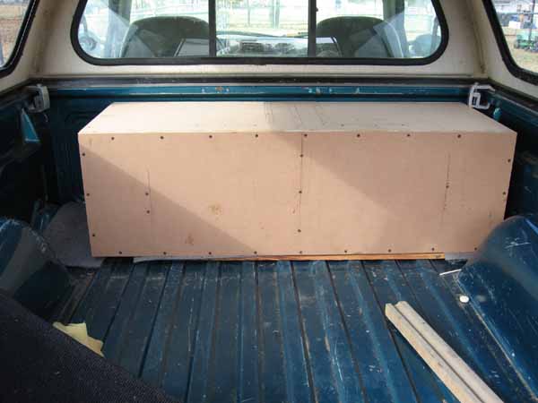

just some pics of the box i built this week for my p3 12s.no carpet or paint FTL its in my work truck so its ok.

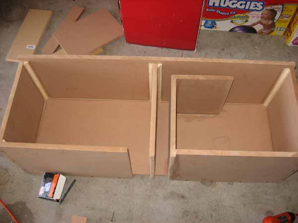

thanks for the replies,ya they are not the best sq for sure,but they are pretty loud.ii got some port noise,i think its because i put a brace in .if you look at the pic w/ the sub sitting in the unfinised box,i ran a 2 in wide piec of mdf from front to back/or top to bottom looking at that pic.anyway its only about 3 inches from the port,may have to remove it.I think the maw,s would definatly walk on these,in sq.

ya Reece that was the plan when i cut the blow thru last year,but its been hard to think about going back down to 10s.although it would be a sweet finished look to have'em flush in the wall.Well I'll be back in about an hour,takin truck for test listen.I removed the braces in question for the port noise,and added some polyfill to try to soften the sound some.it was very boomy and gave me lots of rattles.Ive done this in the past and it seemed to help,so "I'll be back!shortly.

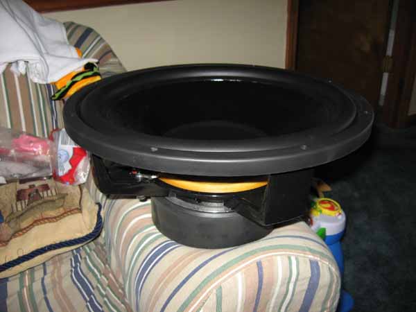

ok.i type slow so may do this post then pour me a drink then finish up.well from a couple hours of play time the subs are comin around better than i thought they were gonna.box is tuned kinda high though.38hz according to re box calc.and it peaks out in the low 40s ,which surprised me cause my last 2 install in my truck peaked about 10 hz LOWER than tuning,like at 28hz,.so with the higher tuning i got lots of rattles i didnt know about and very little flex.at "normal"listening levels,the subs sound fine,nice low bass with decent sq.at higher volumes,the lows get muddy and the 38hz and up get crazy loud,not good,just loud.i pulled into a carwash bay and opened the door and let it rip on jeezy's "hypnotize".rattled the roof like crazy,and sounded loud in that small area,but my truck sounds exactly like the carwash rattling.not good.i guess if they were sealed the rattles wouldnt be as bad but the output wouldnt be the either.im just giving my first hand impressions and expirience with these subs because everybody said they were crap."and they were pretty much right"atleast for the price,there is definitly better.but i gottem cheap with the p1000bd amp so thats why i had to tryem.Goin from an AQ 2.5 15 ON a kx600.1 to 2 p3 12s on 1215 watts i thought would be an upgrade.not!but the amps got big ballzz.most power ive ran.subs just dont have the output.2 15s off this amp would most definatly slam,just thinkin for the future.so,after all that ramblin,im gonna get a drink,and admit again the haters were right about these subs.May be o.k. in a hatchback car but thats about it.

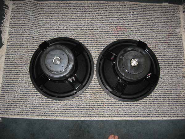

a few pics of my maw 15s"everybody loves pics"me to
Username: 30hrtz
Raleigh, Nc U.s.a
Post Number: 204
prolly shouldve installed these instead of the p3s right?well a little domestic misunderstanding stood in the way of that thats why these are on the forsale thread.subs look beefy for the price though.

Hey what kinda wood is that you used, and did it come with rounded edges like that? I'm not a wood working pro, or novice..

yo dursky why is it so funny?and sodumm,its sealed as tight as it can be.Its an accordian boot that seals on the body side and the bed side,its a great thick rubber boot,oh the wood is 3/4 mdf,sanded edges with a "mouse" and painted the inside of box with polyurethane.Oh and drivin'I got the subs in a package deal with the amp. all new in box 07 models p1000-bd and both 12s for 375 shipped,so i didnt think i'd go wrong,the amp alone sells for that new on ebay and is 599 at bestbuy.

black and decker mouse sander,sorry i didnt clarify that.its an old one.its just a small palm sander.
