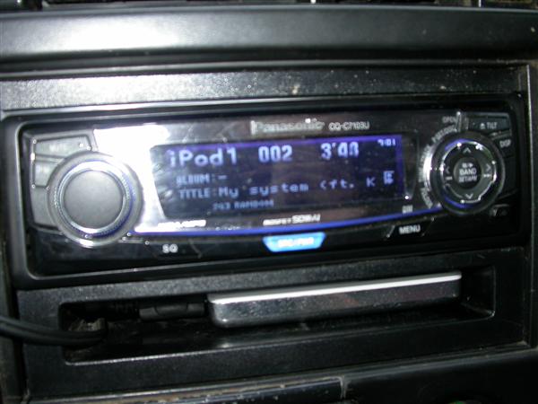

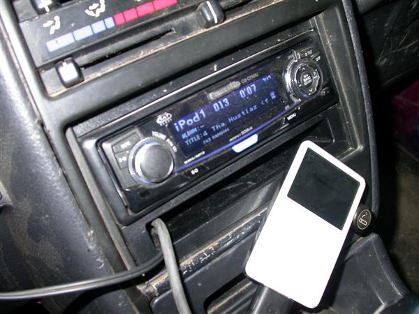

Head Unit: Panasonic CQ-C7103U

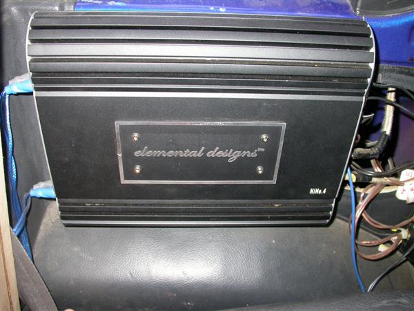

Amplfier driving the components: eD NINe.4

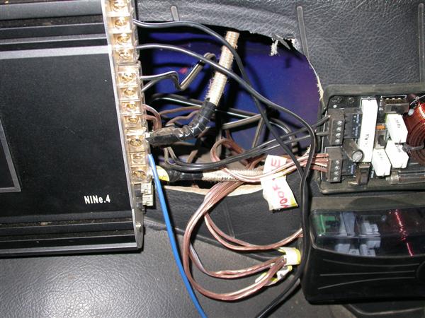

Great amp. eD is great. Anyone trying to tell you otherwise is hating for the sake of hating or behind the times. The wires go through the hole the previous owner created for a 6x9. Crossovers are mounted there, too.

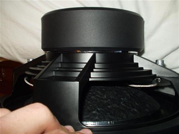

Subwoofers: Mach 5 Audio MAW 12s.

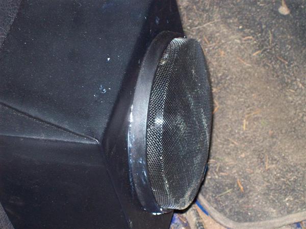

Enclosure: ~4 cubes at ~34 Hz, theoretically. I originally built it without taking into account the space displaced by the air in the port, only the space occupied by the MDF used to form the port, so I knocked that out and built an external port. I just wish I had more room to tune lower. It sounds good, and the door flexes a half inch, but I want more shaky-shake. Anyway, the new port goes all the way across the box and fires to the passenger side. I had to remove the bar that held the back of the soft-top up, so now the box holds it just as high as the bar did. I have to park on a slant, or the water pools, osmotes (if that's a word) through the material and soaks the MDF.
