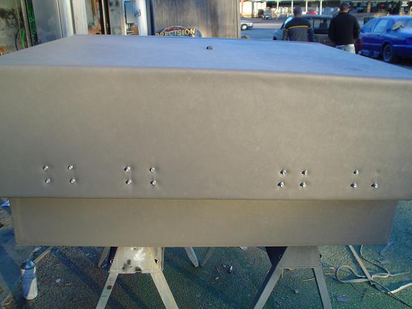

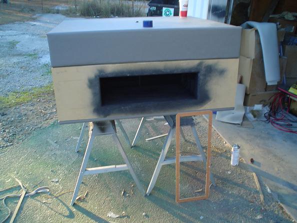

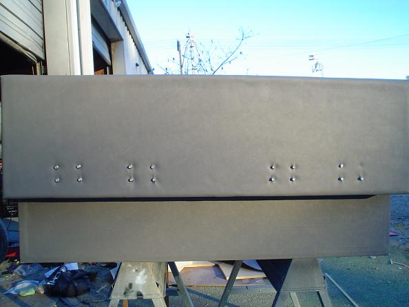

OK, I've been working a lot and just had a chance to vinyl this thing yesterday. The guy helped me do the main part, and I did the port w/out him around. It's my first try at vinyl so don't be too harsh ;)
pics:
Finishing up the main box
And the back where the bolt/terminals are
How it looks from the front (remember there's still a beauty panels that sits on top, so the top doesn't really matter anyway).

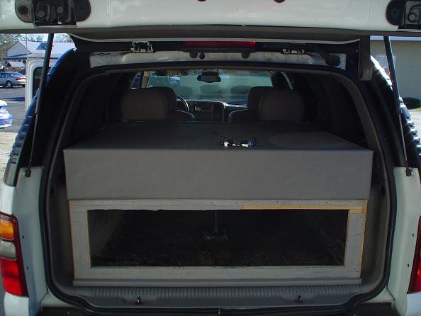

From the back- getting ready to replace that old 'gasket'

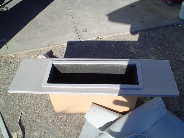

The port
Padding it
padding the trim ring

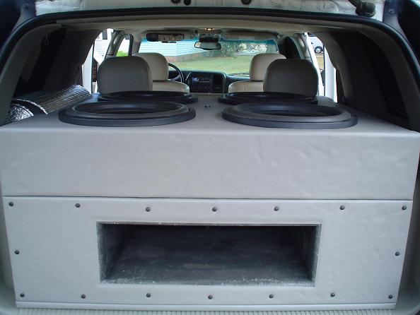

Vinyled and put in
^^^ Looking back at that picture, it looks like there are dimples in the vinyl- you don't see that at all. I believe those are from our hands carrying the thing in there because it's so cold the vinyl just stayed in place. It looks MUCH better than that pic (smooth like the firt pic).

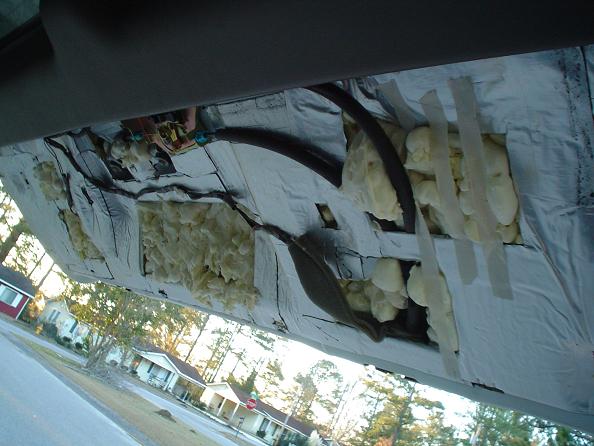

Okay, so I greatstuffed the entire rear hatch (short of where there's moving parts) and put 2 layers of sound deadener.
Getting the excess cleaned out
And back to factory.

Thats so friggin gey!! What a waste of time and money!
lol j/k man it looks sweet!! What subs are going in there?

Looks great. I can't wait to see it finished.

Looks good Troy. I still got to vinyl my box (I've never worked with vinyl) so it will be a learning lesson. I bet that hatch is heavy now :p

Troy, I love that your using Vinyl, it makes everything look very clean and professional.
I do see one thing that might be a problem though... How close is the port to the back hatch? From the pictures it looks like your port is around 4"-5" inches high so you need to be at least that far away from the back hatch. Maybe you have plenty of room...but from the pics its hard to tell.

Jake papa, there's very little room. There was very little room in there before- so I think I'm ok. If I think it has a lot more potential later I'll build a smaller box that will give me the 6-7" I need. For now I have less.
There's a trim ring that I showed in the pic I still have to install on the port, but for now I'm going to hold off and see if I like this port, or the 36hz better. And which one meters better.

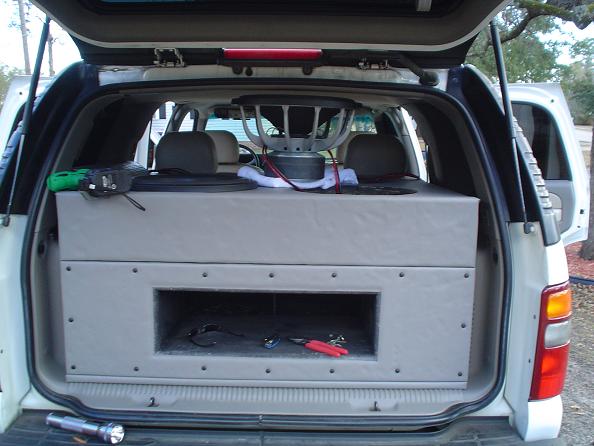

Cutting the holes and wiring things up. Not that important, but time consuming so I'm throwing the pics up
Finally wiring in the subs.

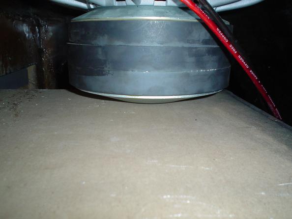

Just a shot of how close the subs are to the port. About 1/8" clearance.
Almost there.
And done.
It's tough putting those things in by yourself- you have to stretch out over the box with these 60+lb subs (and barely 2 inches of clearance above it to pick it up) lol.

Overall I'm not sure if I liked the 36hz tuning better, I'm just going to see how this meters, and how it does with the 4 alts. It can do a hair trick on lower notes, but nothing crazy like before (even that could've been beter). There should be 155+ on here with music from the way the power and 36hz port showed, so if I can't get that I'll be starting over.
