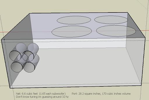

Silver Member Username: MoorezySt. Catharines, Ontario Canada Post Number: 174 Registered: Jun-06 | https://www.ecoustics.com/electronics/forum/car-audio/415790.html thats my problem. i need a new enclosure. I asked help for that enclosure on here and people said i needed more port... and bigger box... and it turned out to be the problem. But now im going to just make from pioneer specs. tell me if this makes sense. on the pioneer specs they use pvc port. I took the port surface area and volume from those specs for optimal sound ( 1.65 cuft ) and multiplied by 4 ( since i have 4 woofers ) then converted those figures to a slot port. This is what i came up with. ![]() Does this make sense to you all? like that enclosure is exact specs as if i had box that was 1.65 (4) with (4) 3" diameter by 6" long pvc. Which is the recommended specs on subwoofer manual sheets. |

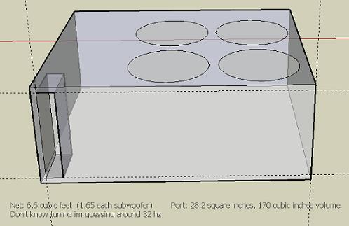

Silver Member Username: MoorezySt. Catharines, Ontario Canada Post Number: 175 Registered: Jun-06 | basically what im trying to say is that enclosure ^^^ equals this one ![]() |

Gold Member Username: InsearchofbassPost Number: 7371 Registered: Jun-04 | go with one 50 square inch port and make it a slot port it should perform better than pvc ports |
Gold Member Username: InsearchofbassPost Number: 7372 Registered: Jun-04 | http://www.carstereo.com/help2/Articles.cfm?id=31 if you want a port tune of 32 hz you want a 14 by 3.75 for example to have 52.5 square inches of port 13.00 inches long total for a 32 hz port tune if your sure thats the tune you want |
Gold Member Username: InsearchofbassPost Number: 7373 Registered: Jun-04 | at 6.6 cubes net (after subs and port) |
