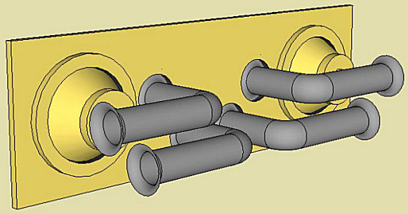

Silver Member Username: Phil_salisburyPost Number: 359 Registered: Sep-06 | I got alpine because I got it in trade for router table counter top I did for a car audio shop customer. The ED SQ10's I bought @ 55 a pop and because there d@mn good subs and they have the SQ response I like without having to eat up a sh!tload of volume and they have the right amount of SPL output without pizzin off anyone outside the vehicle. And I got the amps & eq in trade for this enclosure I am doing for the customer: ![]() |
Platinum Member Username: Rovin4 10 Pioneer... Post Number: 12409 Registered: Jul-05 | hmm NICE ! ^^^^ always had a idea of putting elbows in a pipe port but ur the 1st i can honestly say i have do it ..... ![]() |
Silver Member Username: Phil_salisburyPost Number: 360 Registered: Sep-06 | Rovin, Here's a few more just to show ya what going on inside: As for using elbows in round ports, lately I've been hearing from other people that used them were saying that they were getting port noise using them. I've done plenty of round ports w/elbows and no one has brought up the issue. Here's one I did for mtx thunder 8000's model# T8128 separate chambers ported and the only thing I can think of why anyone would get port noise is from the ends of the ports, but I deal with that by making a mdf ring attached to the end and round over the edge of the port ID. ![]() |
Gold Member Username: Th3pwn3rPost Number:... Post Number: 5408 Registered: Jul-06 | I wonder how that's going to work out for air flow. |
Silver Member Username: Phil_salisburyPost Number: 361 Registered: Sep-06 | if your referring to the direction the ports are aimed is a not issue given the subwoofer/port are separate chambers. |
Platinum Member Username: Rovin4 10 Pioneer... Post Number: 12427 Registered: Jul-05 | hey thanks Phil - u showing us all stuff which pro builders hide ...given me some good ideas there to practice with in the future from the beginning i always loved pipe & aeroports main reason is no matter if u calculated something on a pc but dont like how it sounds INside ur ride u can always pull it out ,shorten or lengthen & replace it back in 5mins i hold together my aeroports with duct tape & it holds pretty damn good too ..... ![]() |
