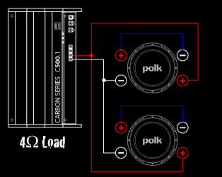

Hey, i have a Monoblock amp, but it has 4 outputs, 2+ and 2-
im wondering if i should use 1+ and 1-
and wire to both subs, or just use 1 to each sub.
thanks
Username: Extrmndor3
Post Number: 6747

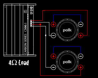

both are the same dude if its a mono block.... it only have one channel.... but sometimes manufactures use the 4 output design juzz to help you out on messy wiring installations... u can also achieve the same thing by using both of the outputs from the corners like in picture 2 u can do it like that but take out the 2 in the middle and do the subwoofer wiring like the first picture... either 3 of these ways are ok as long as you are achieving a 4 ohm load :-)
