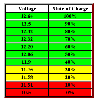

Another thing to consider is the fact that unless it truly is a deep cycle battery, it shouldn't be drained past a 50% DOC, (depth of charge). That quickly kills the battery. That's why it's important to monitor your battery's voltage and if it falls into the 11v range, mayday! See chart.
