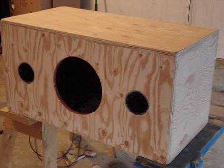

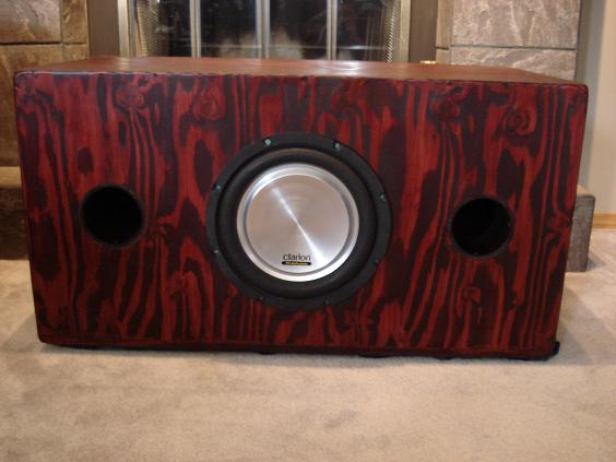

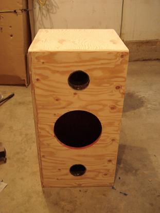

SO i took my old box and refurbished it. It use to have a 12" clarion in it. I took every thing out, took off the carpet and sanded it down. I tuned the box, fillied any gaps with filler then stained, and clear coated it. It sound pretty good now but looks even better. it pounds okay for a little 300 watt sub, but its my old system anyway.....take a look.......

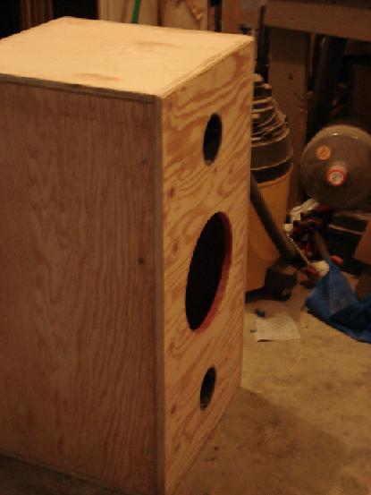

Upload the bare box after stripping it and sanding it down....

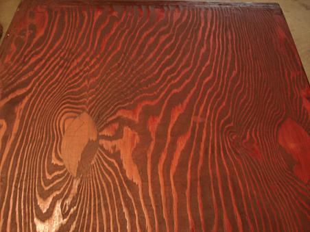

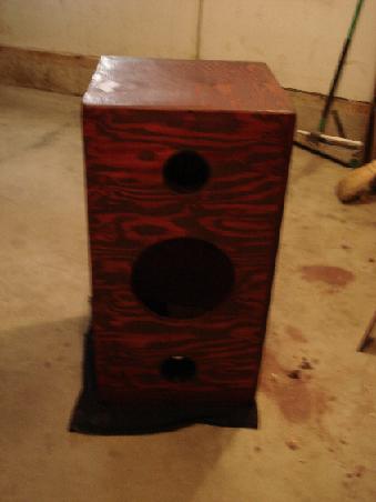

UploadAfter Stain was applied...

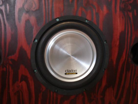

The new setup!!!

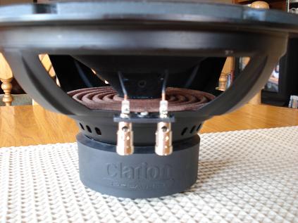

UploadThe old Claerion...bevlive me i bet this is one of the finest 12" 300wtt single vc you can buy. Nice sound quality and pounds decent

Plywood box FTL.

wat kinda wood is that?

yea i was gon say that def looks like ply lol some ppl use birch wood or w/e but that looks like plywood to me lol

Yeah, that is plywood, looks to be A-C or B-C grade sheating plywood, same sh!t used for sub floors and roofing.

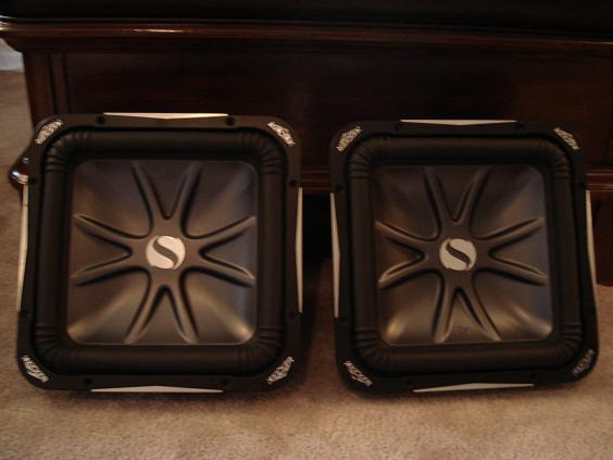

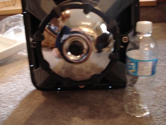

Your going to love those L7s trust me but i hope you dont put them in a plywood box cus they'll tear that b!tch up

aww give him a break, other than choice of materials, the box looks great man, I give you mad props.

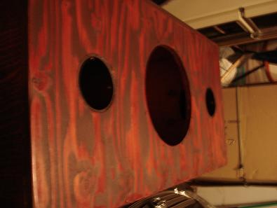

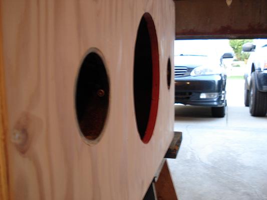

That is solid core ply as you can see in the third pic... despite a little flexing it will be fine.

There's not damn thing wrong with using plywood for a subwoofer enclosure, hell, I would build every enclosure out of Cabinet Grade Birch, Baltic Birch or Sande Ply if it were not for the cost associated with those materials and those willing or not willing to pay that cost.
The only reasons for MDF being used is cost and the fact that MDF is the most resonantly dead material for such purposes.

I've used plywood in the past and always made sure to use damping material on all interior sides. I never noticed any resonant problems. And as Phil states, MDF is just the cost effective smart choice anyway, unless you have no $$ and have the plywood already.

i think that box looks badzazz

i ove that finish. i ink tha would make a sexy home woofer box. it looks real classy with that finish. i dig it

i love that finish. i think that would make a sexy home woofer box. it looks real classy (exspensive lol) with that finish. i dig it

I love the way it looks man...Props,
IT looks better than the Zebra Box lol... Logan jk calm down
it that gonna be for a Home Theater HT or w/e u wanna call it... that would look really nice in a home

Yeah it looks pretty tight, as for flexing and choice of materials i used 3/4" 7 layer fir..(maybe not the best choice but i was 14 at the time) but yeah i cant wait to get thoes kicker bagnin..what kinda wood, would u guys suggest for thoes????

go with mdf for your kicker box and double baffle cause you will need it.

whats heavier spruce or mdf? i can spend some money on the wood,,, do u still suggest mdf?....and yeah ill have to double up my baffel.
