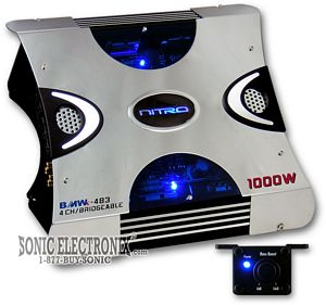

New member Username: KikiakAnchoragee, Ak USA Post Number: 1 Registered: Jun-07 | I have a Nitro 1000W amp I need to hook up to my 2 12" subs in bandpass box. Got the green light on amp but no sound from subs. Subs worked hooked up to different amp but not mine at the moment. The ends of the RCA cords from my deck to amp were cut when my car was broken into. There are ends put on with electrical tape right now, so do you think that is the problem? I need a whole new cord going from deck to amp? The amp is 4 channels, but unlike my old Xplode amp, the ports for the RCAs are labeled Ch 1-4 one for each port. ???? The old amp worked fine that way for a while then one day the bass from subs started cutting in & out bad so I disconnected it till I got this new one. I am a female and don't know much about this but I could use some advice/ideas/help!!! Thanks! |

New member Username: KikiakAnchoragee, Ak USA Post Number: 2 Registered: Jun-07 | Well, I set up the new RCAs from deck to amp, had the green light and subs worked... then left my friends and got home and went to tighten down the clamps on the 2 speaker wires from my box and not it is red light and no sound! What may have happened? The amp is 4 channel but there are only 2 wires coming from subs, pos & neg. In the illustration in my manual, it only shows 2-4 channel mode and that has speakers coming from 2 diff subs. Mine is not like that. Where the RCAs plug in to the amp it says 1,2,3, or 4 channel - one for each of the four ports. Any ideas? |
New member Username: KikiakAnchoragee, Ak USA Post Number: 3 Registered: Jun-07 | Also, the amp is 2 ohm stable, 4 bridged and is Mono bridgeable. Nitro 1000W model BMW-483. HU is Alpine, fairly new one dont know the model # off hand. |
Silver Member Username: Kpa2727Post Number: 202 Registered: May-07 | as i stated it's a 4 channel amp not a subwoofer amp. u could of shorted the wires by accidentaly grounding a wire on the subs, that would send the amp into protect mode. if u shut the amp off then bk on it should be fine. unless you blew a fuse, in that case check the fuses on your amp. the subs are wired togeter thats why u have just one set of wires. u can bridge the amp making it occupie 2 channels now after hearing this 1234 stuff i'm thinkin u got 2 out puts , one input in this case u want the input jacks, stick to 1 and 2. i'm gonna look up the nitros manual and clarify better for you. |
Silver Member Username: Kpa2727Post Number: 203 Registered: May-07 | holy geeze that amps nowhere near close to 1000 watts that's it's peak power. kristin, i'll be blunt ur running not so great stuff, everything measured in rms power not wattage peak. ur prob over driving the hell out of it considering it's rms is only 150 watts bridge at it's best and even that's overrated i'm sure. u prob did ground something so check the fuse. the amps bassiclly crap and not doing anything of what it was made for by running those subs. the rca thing, i can't find pics of thier inputs but i still assume it's built the same way, channels are just left and reight refering to front and bk, 1 and 2 prob feeds channels 1 and 2 sames as 3 and 4 rcas feed channels 3 and 4. for anyone else reading amps specs Amplifier Specifications: Amplifier Class N/A Number of Channels 4 RMS Power (4 ohms) 50 watts x 4 channels RMS Power (2 ohms) 75 watts x 4 channels RMS Power (1 ohm) Not Stable Bridged RMS Power 150 watts x 2 channels Peak Power Output 1000 watts Minimum Impedance Unbridged 2 ohms Minimum Impedance Bridged 4 ohms THD at Rated RMS Power 0.03% Speaker Level Inputs Yes Amp Preamp Outputs No Built-in Crossover Yes - HP / LP High-Pass Crossover Frequency 50 - 1 k Hz Low-Pass Crossover Frequency 30 - 250 Hz Subsonic Filter Signal-to-Noise Ratio 95 dB Channel Separation N/A Bass Boost 0 - 18 dB Bass/Gain Remote N/A Fan Cooled No Fuse Rating 40A Warranty 1-year Manufacturer's © Sonic Electronix. ![]() |

New member Username: KikiakAnchoragee, Ak USA Post Number: 7 Registered: Jun-07 | I had someone set the levels on the amp, and when he turned up the bass boost the amp went back to the red light! Now when I plug the RCAs into the amp I dont get green light at all. Plugged my portable CD player into the amp and no lights at all come on, nor is there any sound. Was working fine until he turned the levels up. Think he fried my amp? ![]() |

Silver Member Username: Kpa2727Post Number: 249 Registered: May-07 | if it's completely dead, u blew the fuse. to set the amp correctly u do not ever touch bass boost u leave that at zero, if u touch it u will burn the subs up, it prob turned off do to over driving the amp, basiclly demanding to much power, u only touch low pass, the gain must be set according to voltage with a meter, u can't just crank it up to get more bass or u will burn everything up. |
Silver Member Username: Kpa2727Post Number: 250 Registered: May-07 | use this rms into the ohms ur speakers are wired will give u the voltage ur amp needs to be at. http://www.subwoofertools.com/forum/setgain.asp u place a multimeter on a/c voltage then pluge them into where ur subs are, after removing the subs of course ::this is all on the amp terminals:: u turn off any bass boost or low pass filter, this goes for the radio to. then get a 50 hz test tone from here http://www.realmofexcursion.com/ u play the test tone at 45 percent volume on the radio, after that you turn ur amps gain to that voltage on the program u worked out above, after that dissconnect ur meter and so on with everything powered off of course, then set ur low pass filter to 80 hz or where u think 80 hz is. then with everything still off reconnect ur subs and from then on leave the amp alone if u want to adjust bass boost which i advise against u then need to do it through the radio. don't let some @ss crank the knobs over till they ruin your stuff. you gotta do it right or u will be on here everyday with a problem. also if the bass sounds low it's cause ur amp is low powered u can't just turn knobs to fix it. it won't run safely and u will burn everything up. |

New member Username: KikiakAnchoragee, Ak USA Post Number: 8 Registered: Jun-07 | Ok, so I found out that my amp and subs both still work... as well as my old amp I took out! Just not all together in MY car. I now get no light at all on amp unless I plug the RCAs in, it turns red. This leads me to believe that I have a problem in my wiring someplace. The remote, ground or 12V? How can I narrow that down more? Just have to re run those wires? |
Silver Member Username: Kpa2727Post Number: 265 Registered: May-07 | if ur amp works in another car the fuse could be blown in the fuse holder under the hood on the positive feed that goes to the amp, there should be a fuse there.other then that a rem is a possibilitity since the rem turns the amp on but it's pretty unlikly. if u had a meter u could test to see if it's 12 volts at the rem when u power on the head unit if it is ur fine. i think it might be the fuse block for the amps main positive feed. btw in case u didn't get the pm it's kpa62. |
Gold Member Username: CarguyPost Number: 6331 Registered: Nov-04 | Kristin, take a deep breather. Don't panic. Since it sounds like you still have the manual, go to the section on setting gain/level control. Not very hard at all. Most HUs are 4v preout, and most amps handle up to 8v. So if that matches your setup, set the gain/level half way. Now to test your amp separately, connect the remote wire to the POS power connector. The neg is the car's chassis/ground. This will force the amp to turn on, now connect your portable cd player to the amp's input rcas. If you get sound then the amp's fine. Check the speaker wire strands for anything that could short out to the ground. From your description, it sounds like the amp's getting overloaded from the HU. Probably due to incorrect gain/level setting. One more thing, the amp you're using isn't the greatest, so if it's blown, don't worry too much. It can easily be replaced for $100 or less. I don't know how those guys managed to use the "BMW" trademark without getting sued. |
Silver Member Username: Kpa2727Post Number: 267 Registered: May-07 | she tested the amp isaac, it works fine in a diff car, it's down to diagnoising the wireing. |
Gold Member Username: CarguyPost Number: 6333 Registered: Nov-04 | Doesn't matter, she still needs to test it in HER car cause it's having problems. The problem could be the speaker wire strands, rca, power wires, ground etc. |
New member Username: KikiakAnchoragee, Ak USA Post Number: 9 Registered: Jun-07 | Good news - replaced the ground and it works. I hooked up my old amp instead since it still works and is 1/2 channel rather than 4 channel for what I am running right now. Thanks for all the advice! |
