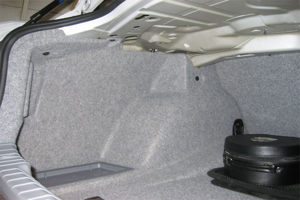

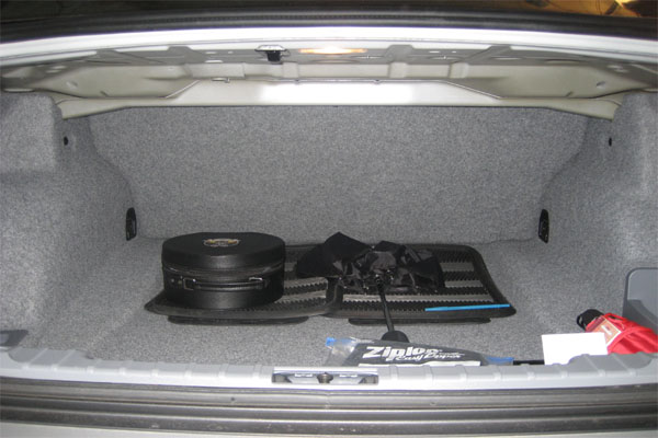

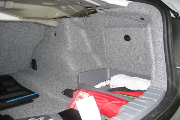

ok there's more bad news i forgot to mention earlier. This car is a lease so i cant do much custom work to it. i wanted to spend between 500-1500 and the trunk measurements are: 38 inches deep 27/37/41 inches wide( you'll understand why in pics) 15 1/2 - 20 1/2 tall(you'll understand why in pics). I really want a SQ system i hate spl systems i love music to much.

here's all the measurements on the pic so you understand.Upload

Thats enough space for two 15"s.......
Since you can't modify the car, IDK if JL W6s will have enough output for you. For a good SQ system with good output, I would put two 15" Qs in there. Port the box real low maybe 30hz or so, throw about 1000 watts on each sub, and you've got a clean hard-hitting system

That's not a small trunk. With a little tweeking in box design you can maximize what's there. Not much room for anything else but.....

Lets review, you've got about 10 ft3 of usable space......
Q 15" takes a 2.8-4 ft3 box. Q 18" takes a 6-10 ft3 box. Somebody want to tell me how this isn't going to work, lol.
